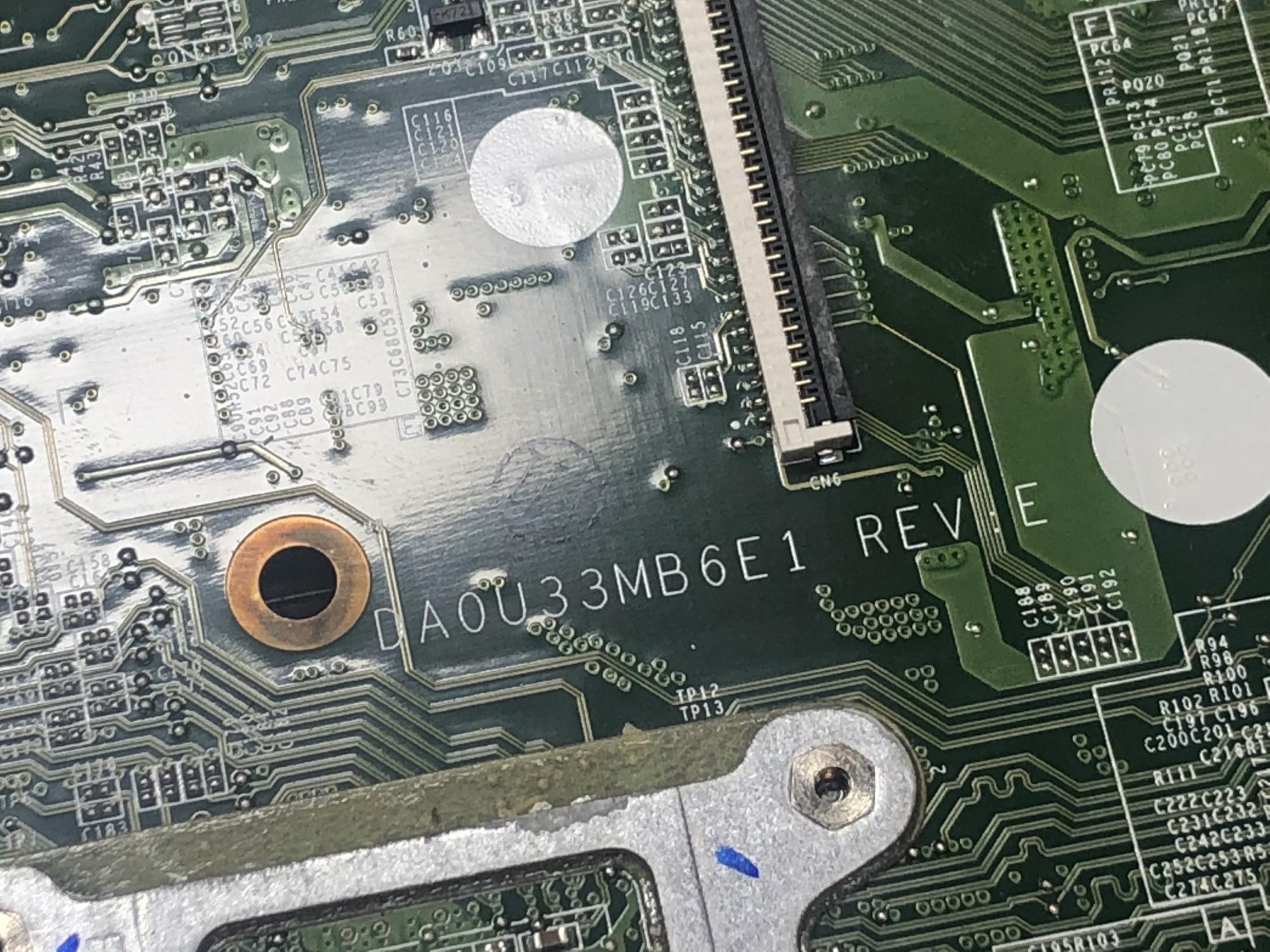

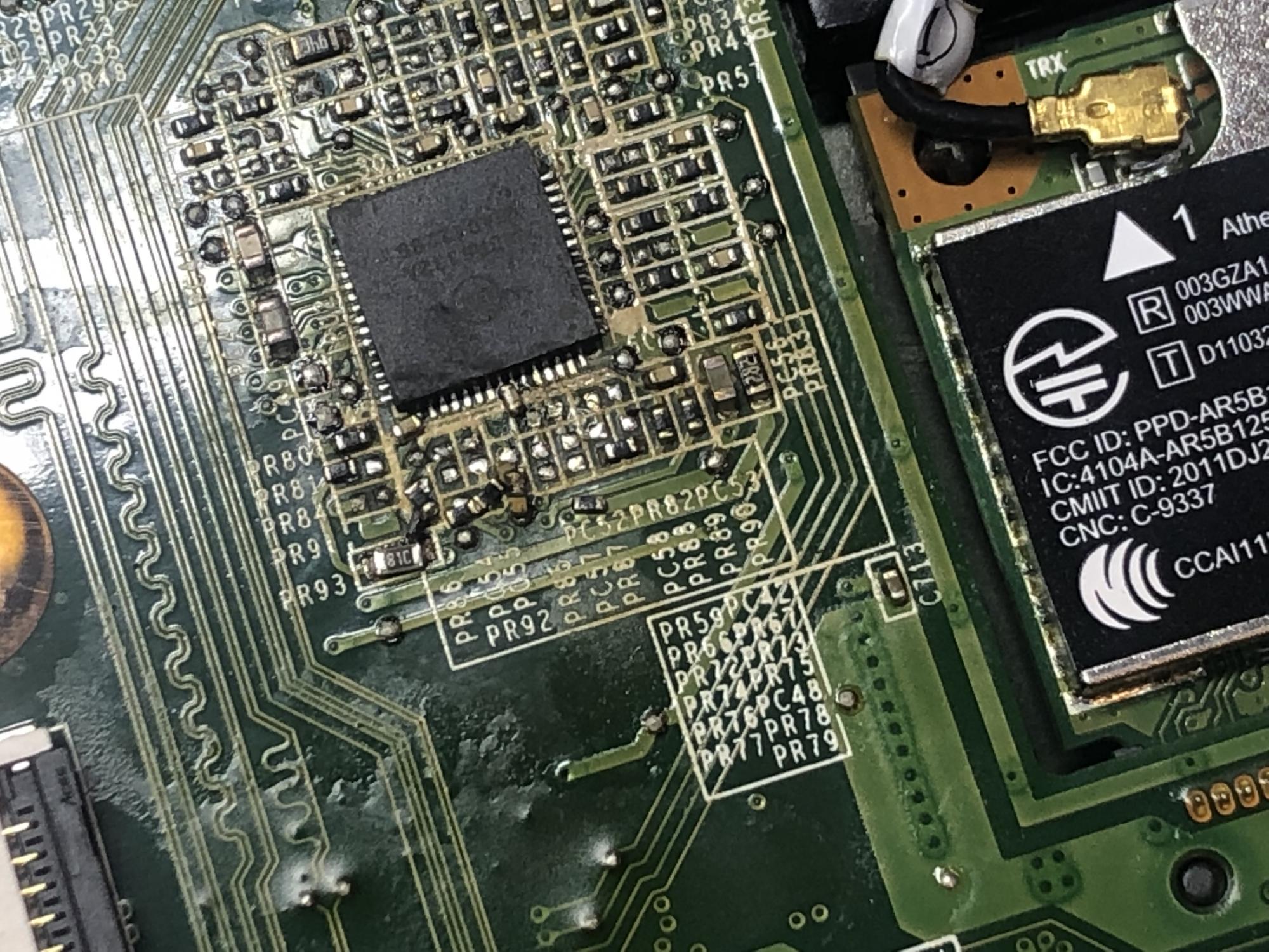

Hello my friends please help. DA0U33MB6E1. REV E
  • mohammed mohan
    • Nov 2017
    • 197
    • z
    Hello my friends please help. DA0U33MB6E1. REV E
    I have a motherboard that had a problem when I wanted to replace a damaged piece and the paintings were damaged by mistake. Does anyone of you have a clear close-up picture of this place shown in the attached pictures?
    Board number DA0U33MB6E1. REV E
    Thank you all
    Mohammed Mohan
  • mohammed mohan
    • Nov 2017
    • 197
    • z
    Re: Hello my friends please help. DA0U33MB6E1. REV E
    Mohammed Mohan
      • 21467
      Re: Hello my friends please help. DA0U33MB6E1. REV E
      The layout is the same in the DA0U33MB6D0 schematic.The parts locations are marked on the board. You can test the capacitance of the dislodged caps but not the voltage !
      Last edited by SMDFlea; 01-18-2022, 03:41 PM.
      • mohammed mohan
        • Nov 2017
        • 197
        • z
        Re: Hello my friends please help. DA0U33MB6E1. REV E
        thank you my friend
        Mohammed Mohan
        • XxMicroSoldering
          ASUS Rog Strix G17-712LV Laptop Liquid damaged
          by XxMicroSoldering
          Hello Guys
          I have a ASUS Rog strix laptop that I bought recently to fix and the previous owner spilled water on it . He brought it into a repair shop for them to check it out and instead of fixing it they damaged the battery connector of the laptop ! Other than that they damaged damaged nothing . But since the liquid damage the laptop only turns on and the keyboard lights up and then immediately turns off. I really want to repair this laptop and I also have experience in repairing phones etc and laptops and a bit of soldering but the diagnosing part is where I need help with and...
          10-17-2024, 10:45 AM
        • Tomylee
          Identification of Component T5 on NEXIQ USB-Link 2 (damaged due to crushing)
          by Tomylee
          Hi everyone,
          I'm currently repairing a NEXIQ USB-Link 2 that was physically damaged due to crushing. After a thorough inspection, it appears that only one component is visibly damaged: the T5 component, located right next to the Mini-USB port.
          It's a 4-pin SMD component, with one pin at each corner, aligned front-to-back along the USB port axis. Unfortunately, it is broken, and there are no visible markings left on the part to identify it.
          I'm looking for help with the following:
          The exact identification or part number of the T5 component
          05-28-2025, 12:42 PM
        • tofik
          LG 50PA6500 Plasma TV damaged after a power spike
          by tofik
          Hello, I have an LG 50PA6500 Plasma TV, purchased new in 2012.
          Unfortunately plasma is not working at all after a power spike.
          Qucikly tested the PSU and voltages seems to be okay, when eveything is disconntected from the PSU I got:
          VS = 200-206 / actual = 205 V,
          VA = 55 / actual = 54.9 V,
          M5V = 5.2 / actual = 5.19 V,
          17 = 17.24 V,
          5.2 = 5.19 V,
          STDBY = 5.19 V,
          ERROR_DET = 4.8 V - does it mean PSU is damaged? the rest of the voltages seems to be fine.
          what's your opinion about the PSU?
          Also I just...
          12-20-2022, 03:08 PM
        • Tomylee
          No LCD image after connector replacement – lifted components and damaged resistor (Nintendo Switch Lite HDH-CPU-02)
          by Tomylee
          Hi everyone,
          Sorry for the person who’s going to read all this !
          I'm on a Nintendo Switch Lite, motherboard HDH-CPU-02.
          While replacing the left joystick, I had to remove the motherboard to access the connector underneath. When I lifted the LCD connector latch, it broke (the plastic had become brittle over time), so I replaced the entire connector.
          During the desoldering of the LCD connector using hot air, three small components located just below the connector (likely 0402 capacitors) came off and remained stuck to the bottom of the...
          07-11-2025, 11:52 AM
        • ChattFix
          Samsung UN85CU7000D Damaged Screen?
          by ChattFix
          Hey everyone, just wondering if this is a damaged screen or if there is possibly something else?...
          05-07-2025, 12:34 PM
