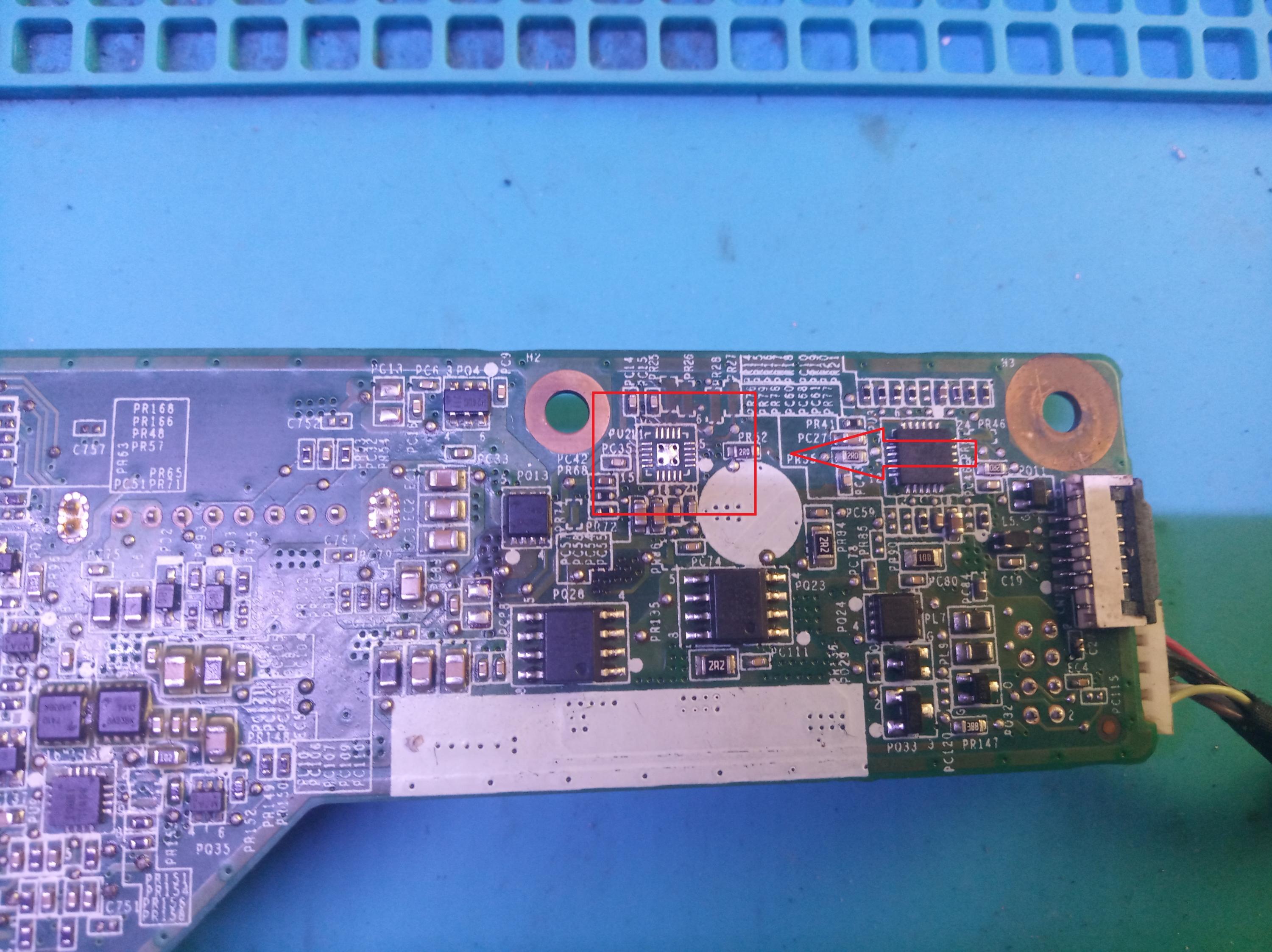

    Hello friend, i need help what ic for this board. Original ic is burn, since i don't have schematic, i don't now what part number for this ic. Maybe someone here have schematic can tell me.
    Thank you
    Laptop : HP Pavilion G4
    code board : DAR23GMB6B1 Rev:B
    IC for PU211

    DAR23GMB6B1 is a Quanta part number .
    https://www.badcaps.net/forum/showthread.php?t=88758
    1.1.3 Motherboard model number
    Quanta: found in HP, Dell, Acer, Toshiba, a few Lenovo… Model number on the board is "DA0xxxxMByyy" (first 0 is optional), "xxxxx" is the actual model and "yyy" contains the revision. For example DAY11AMB6E0 for Quanta Y11A rev E. Warning: 0 and O are hard to distinguish when reading from the board, for example DA0OP6MB6D0 for Quanta OP6.
    http://www.s-manuals.com/motherboard/quanta_r23

      see page 39 ...

        Thanks @SMDFlea for this information @peste for schematic
        Edit : I tought it was pu211, actually pu2 and pin 11 leg
