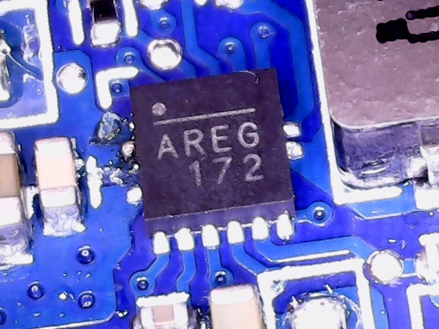

    Hi, do you know what kind of component this U60400 is, 1U=V0M
    i can't find the wiring diagram
    mainboard: CIRCUS-6050A2723701-MB-A02

    Richtek RT8097ALGE

        There`s another part with the same 1U= code .Desolder it and check which pin is ground.
        RT6255AHSGJ8F - https://cdn.badcaps-static.com/pdfs/...4ea754f217.pdf
        Check the pin configuration on page 2 of both datasheets

          RT8097ALGE has a SOT-23-6 package while RT6255AHSGJ8F has a TSOT-23-8 package.

              does the wiring diagram of this mainboard exist?
              I see that the VIN of RT8097ALGE discharges to the ground

                i found the ic defective, do you know what it is?

                    This is the DataSheet of your IC. MPS is the manufacturer of this Chip.

                      Je to DC/DC menič z napájania na 3,3v

                          it is a dc / dc converter designed for 3.3V 8A
