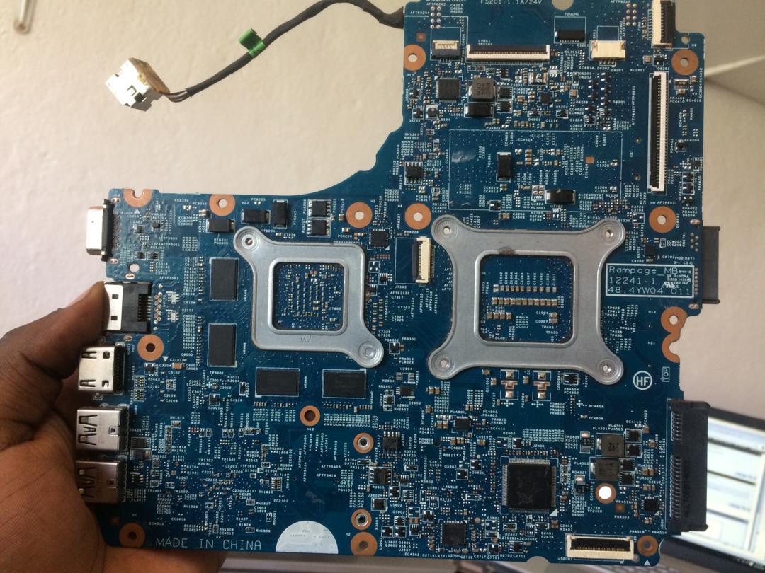

                looking for HP 450 G1 boardview link if it was posted on the forum please
                  • 21606
                  Re: looking for HP 450 G1 boardview link if it was posted on the forum please
                  What is the motherboard part number ?

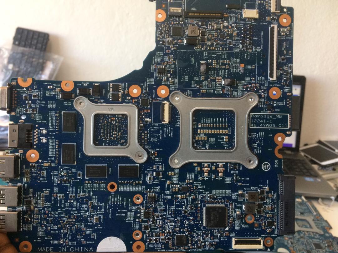

                    Rampage_MB 12241-1 48.4YW04.011
                    AND
                    Rampage_MB 12241-1 48.4YW05.011
                      • 21606
                      The boardview doesn`t seem to be available sadly, only the schematic.

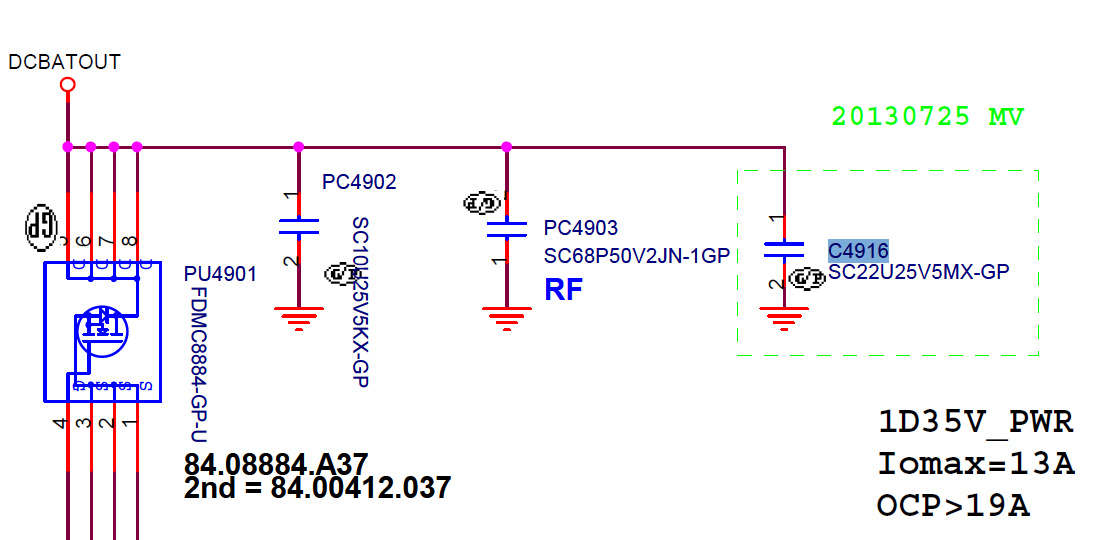

                          Hello, I have the same symptoms and in my case it was a blown capacitor C4916. (I hope as I didn't power the board up yet after removing it)
                          The question is is it a 22uF 25V one?
                          I have many donor boards and can't find this cap on any of them so far. Do I read it correctly?
                          Thank you
                          • AL._.EX
                            • Dec 2022
                            • 894
                            • Belarus
                            22mkF 25v
                            The laptop will work without this capacitor).
                              Originally posted by AL._.EX
                              22mkF 25v
                              as you said, works!
                                Thank you
                                Could you please show me where that C4916 capacitor is on the motherboard? I've searched a lot and can't find it...​
