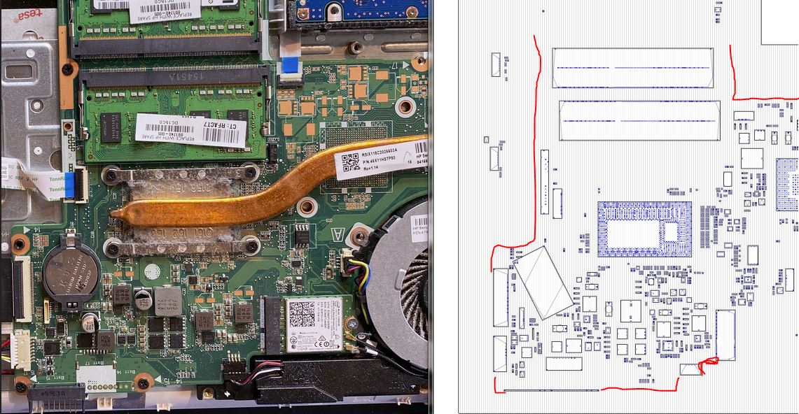

    laptop dead, 21.2v on the board by PSU connector, but I can see visual discolouration on what I think are open SMD resistors.
    Laptop vents, fan and CPU heatsink congested with fluff - possible overheating.
    Searched high and low for the schematics and boardview files to no avail.
    Thanks for any help!

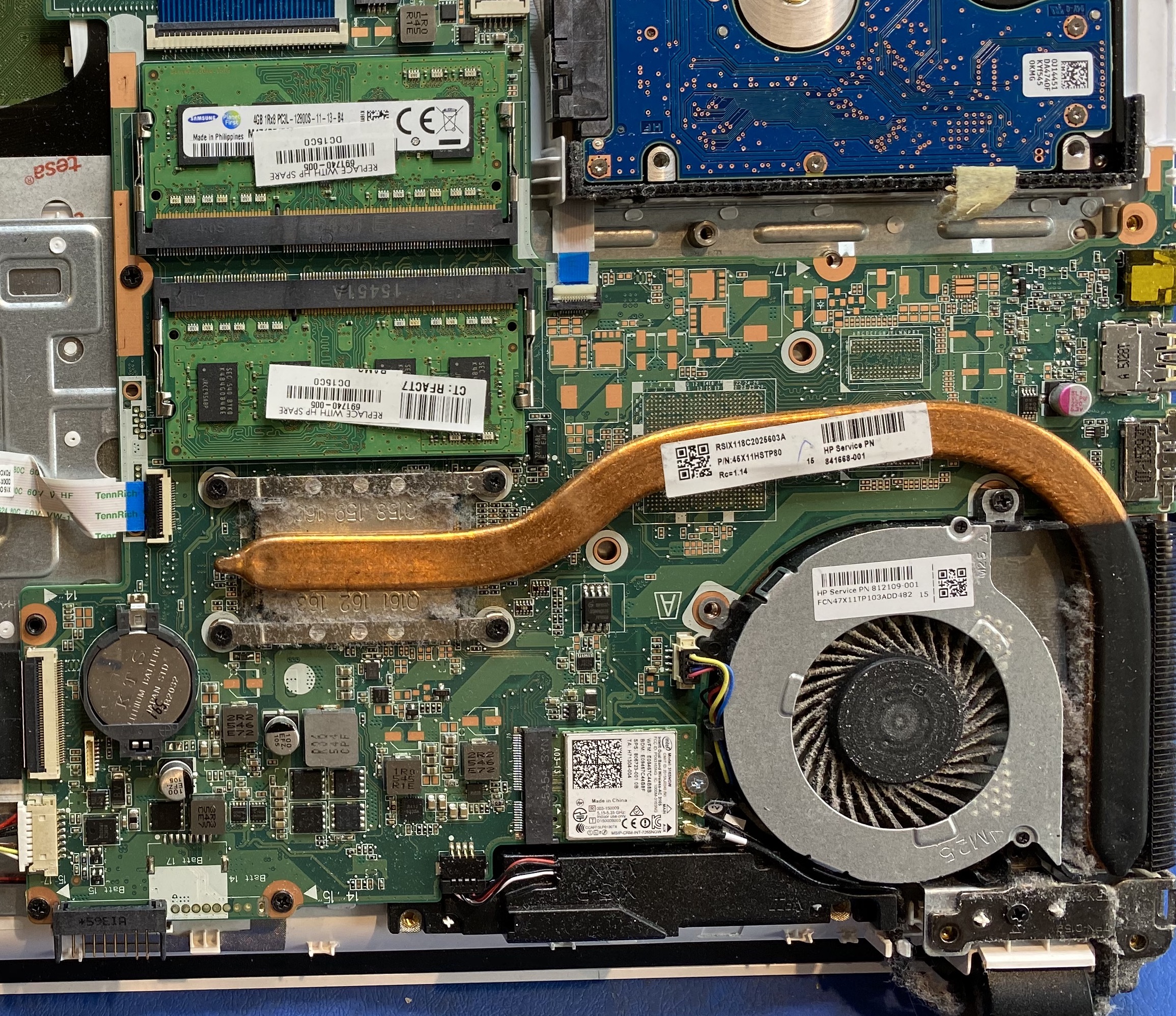

      I downloaded this earlier today, the BV layout is not the same as the board I'm presented with.
      This HP board appears to be designed for various 14"-17" variants with pads for graphics chips and SSD chips.
      I've attached a image of the board. Perhaps there are more identifiers on the rear of the board. I was resisting dismantling further till I had more detail.
      Thanks for any guidance.

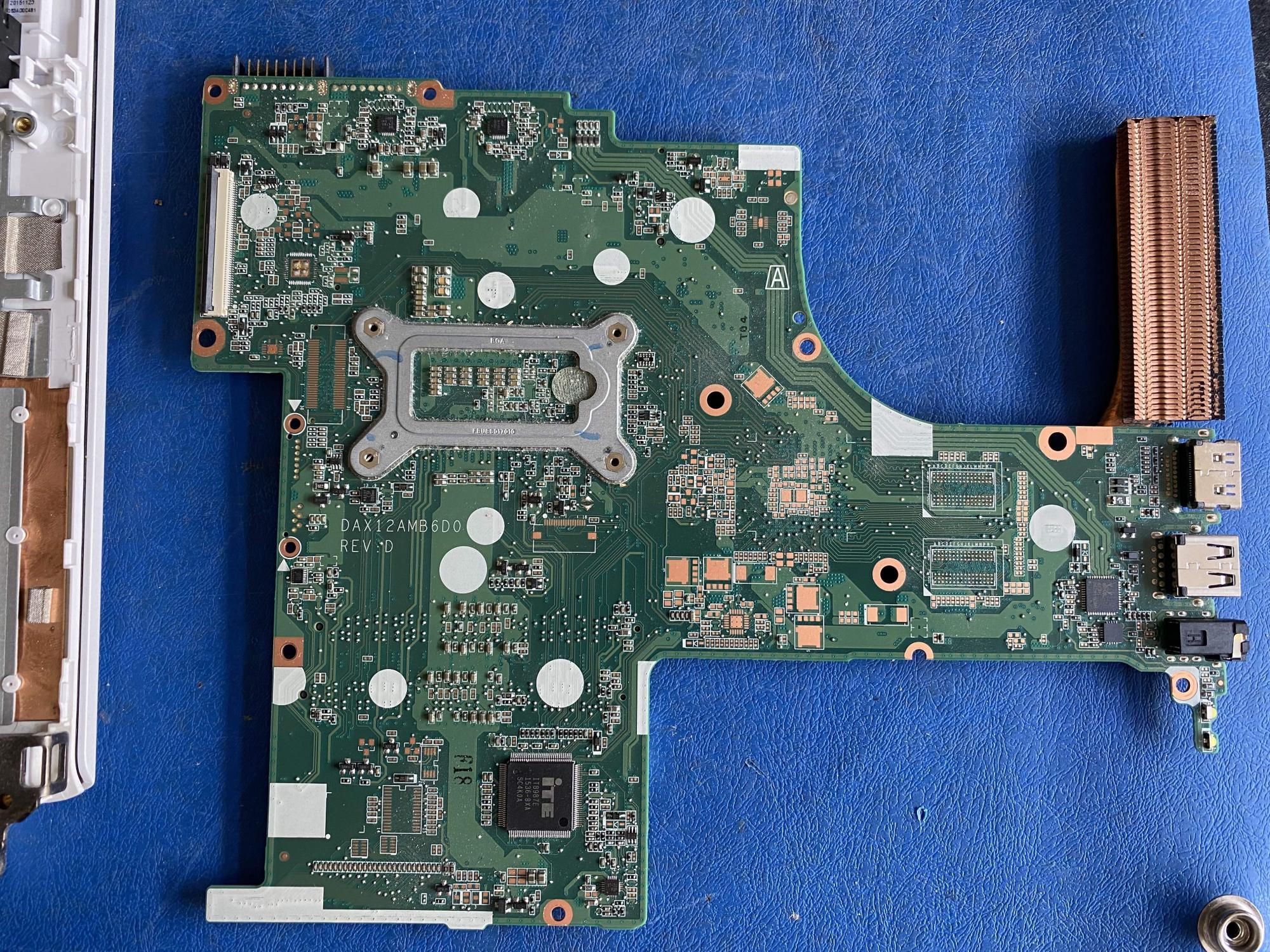

        I've removed the board from the laptop, on the reverse it has:
        DAX12AMB6D0 Rev: D
        I have searched and downloaded BV files for many hits on this board number and they all appear the same (wrong) board... not the one in my hands.
        Has the manufacturer re-used the part numbers? Or am I missing something really obvious ;-)
          • 21584
          Re: HP 15-ab269sa X12A
          There are 2 different boardviews available,X12A-MB-6L-C and X12A-MB-6L-D .The boardview you have is good enough. If you`re using openboardview you might have to mirror the boardview and rotate it to get it showing properly.

            Wow... like a 90's 3D picture of a dolphin :-)
            Up to now the BV files I've used, the perimeter reflected the board shape in reality - so I just saw a rectangular ish board that looked wrong.
            Now to grab the meter and scope...
            Really appreciate your help, learning stuff is awesome...
