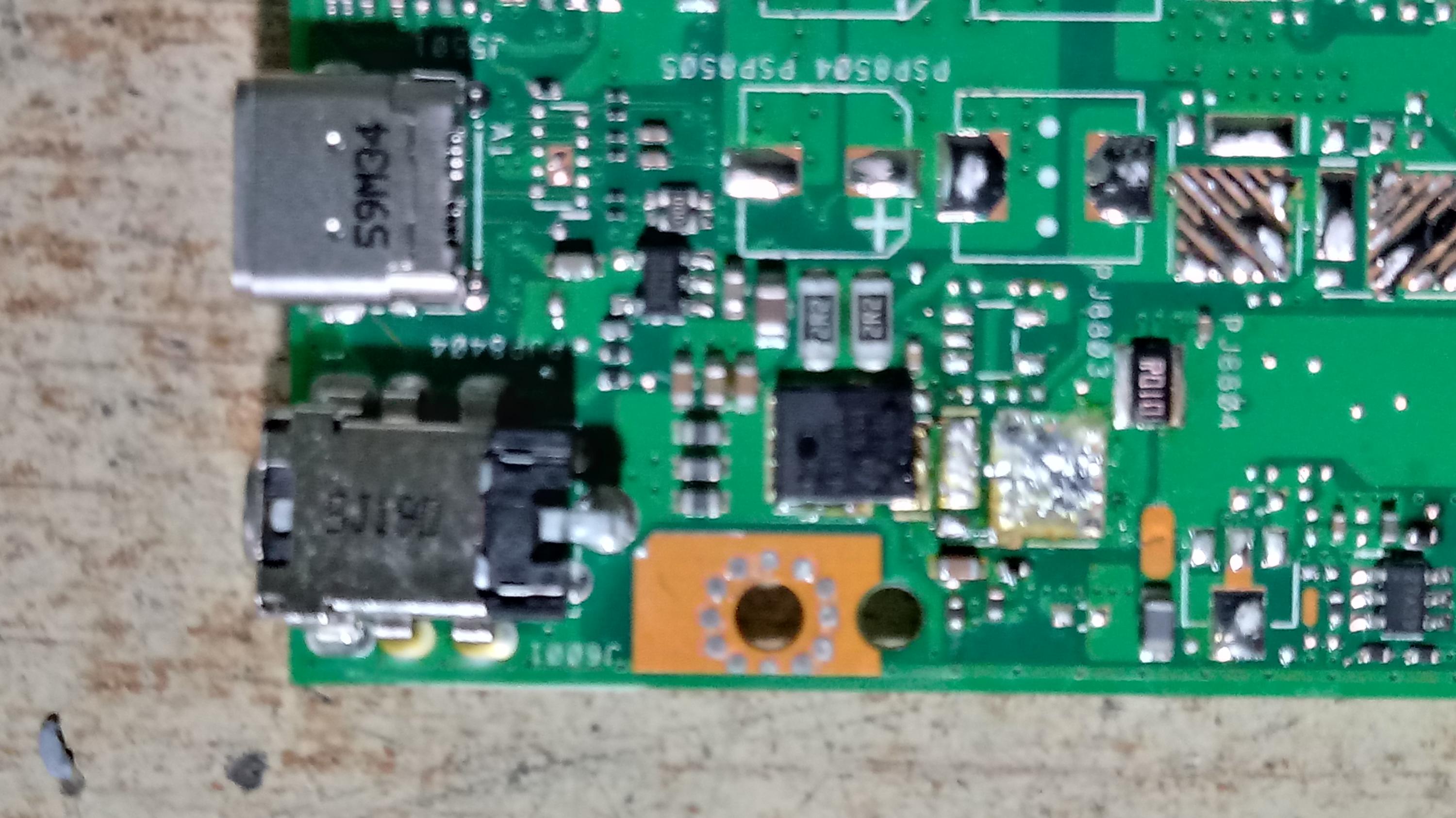

    Hello to all , i need this schematic.....latop work only on battery ..i have found on motherboard the second mosfet from dc in connector has low resistance (in short) M.B. is x540lj rev2.0 ASUS
    Inscription on mosfet is m3054m....the first mosfet near dcin plug is m3056 this is ok ..i have measured it with multimeter and show aprox.540 ohm , the internel diode , so i think is a n-channel mosfet
    i have not find a datasheet on internet...thank you in advance..

    OK i have solved this laptop by replacing with AON6414A..now it charging the battery , in windows show level of battery and the mosfet did not become got...

      I see you solved it now. Heres the link to the datasheet anyway, for reference .
      https://www.alldatasheet.com/datashe.../QM3054M6.html

        ok thanks for datasheet , it seems original mosfet has high current then aon6414 but more low timings......but laptop still charging battery...hope it is ok...thank you for datasheet ..i didn't find it..
