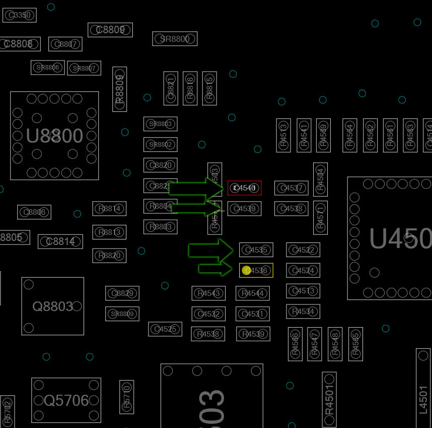

              I downloaded the files, how do I read them?
              • Bartoloni
                • Jul 2018
                • 140
                • Italy
                Re: vgsg mb rev:2.1 schematic

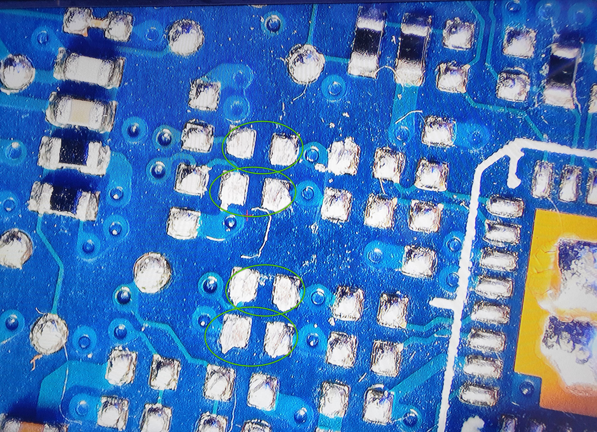

                you can use BOARDVIEW software
                .. BTW anyone have access to schematics of this board?
                i have 4 missing CAPS (i know that this maybe is not a big issue but seems that they are necessary for some sort of "filtering") ... the internal LED panel is not working (external with HDMI works fine)
                the missing caps are: C4540 C4539 C4535C4536
                i can't find any other missing component (and there are broken soldering pads only for these 4 caps looking with the microscope)
                they are probably removed by plastic back cover of the laptop during battery replacement
                (looking at theboard view these caps are connected to CPU and to DISPLAYCABLE)

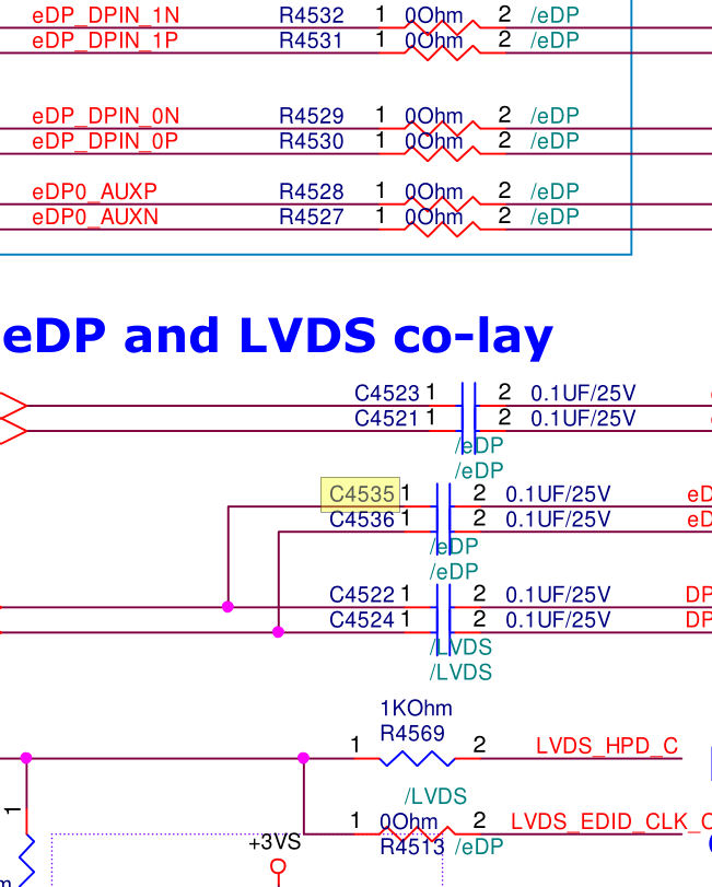

                  well. just bought schematics... the caps are 100nF 25V
