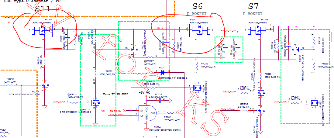

      I have the schematics see attached file. I'm issues with this board too really looking to get some insight what you guys are getting in readings around.
      Im getting not getting any voltage at all from source, gate and drain I am thinking about replacing them as it just doesnt make any sense why dont get voltage see attachment.
      Would love to hear your thoughts.

        probably the mosfets are shorted to ground. place one prod of your multimeter to ground and poke the mosfets to see if it is shorted be sure to disconnect the battery and power adaptor first. hope this helps..

                I checked those mosfets I mentioned their not faulty its just that the gate voltage of pq213 is 20v so it cant saturate source-drain.
                The issue I now looking at is that B+ voltage is 13.5v all across the board does anyone know where B+ gets generated off.
                I really appreciate anyone helping me out on this.
                  • 22035
                  Re: Dell 9550 LA-C361P AAM00 Schematics needed
                  PU300 - BQ24777RUYR ,pin 27 .
