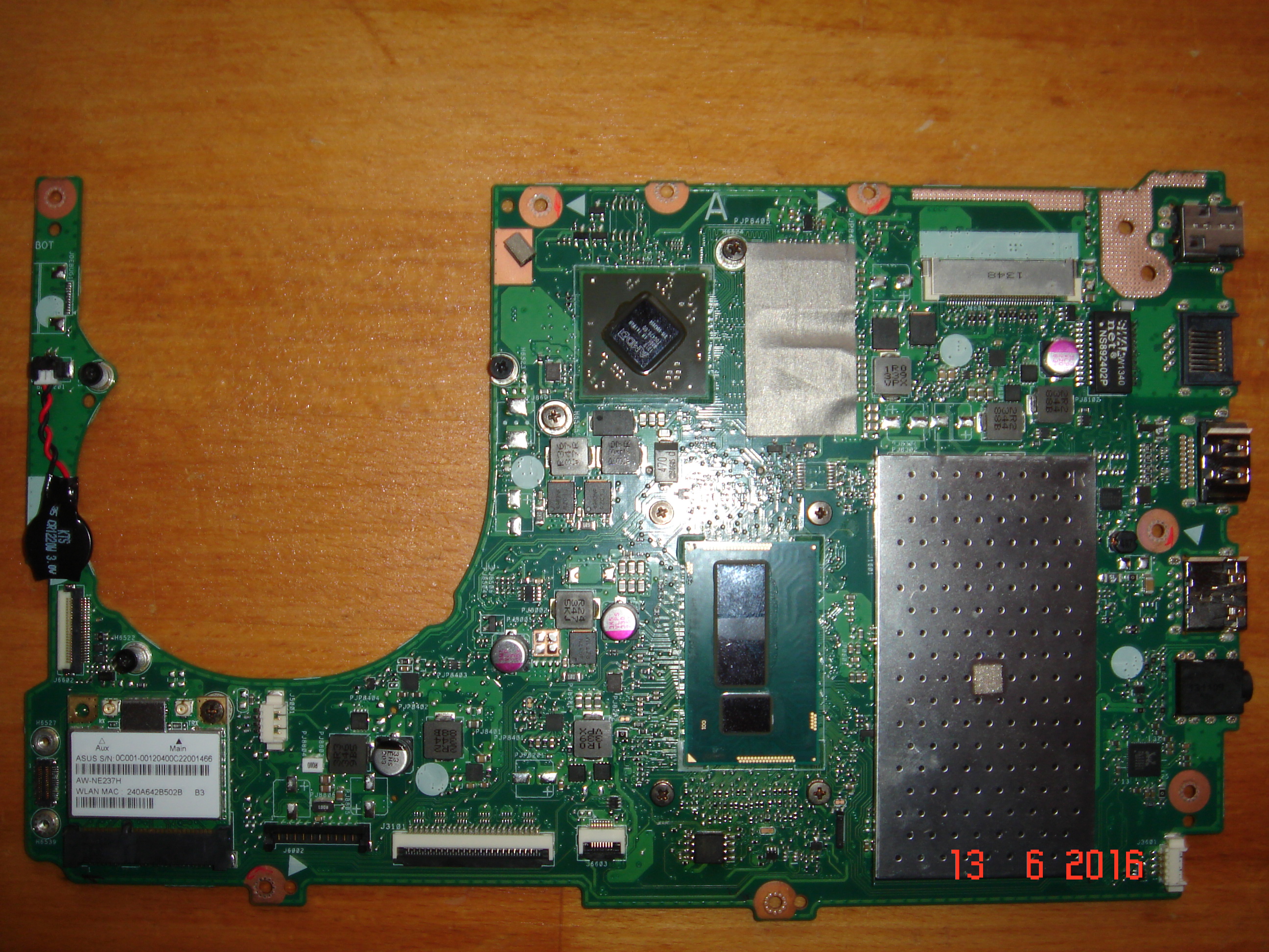

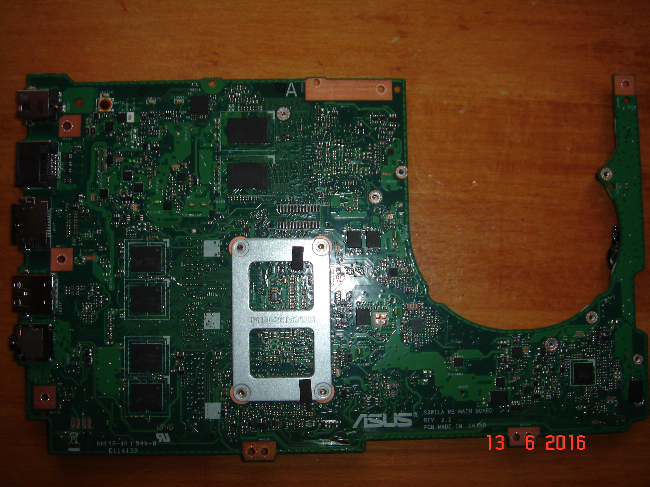

    I'm searching for schematic or boardview for this motherboard :
    asus s301la rev. 2.2
    I have No Power and it doesn't charge the battery.
    19V is present on the connector, measured on the mobo, but i have NO 5, 3 and 19V elsewhere.
    I offer 30 euros for the one who help me solve this one

    Hi, what is the number for the charging chip?

      Re: Asus S301 Schematic or boardview
      Can you tell me where is located from the pictures above ?
        On the top side, a little higher of the name S301LA MB MAIN BOARD on the right you have a 20 pins chip, what is the number of the chip?
        Looking more closely, I think the charging chip is beside the LED5903, so give me the number of this chip.

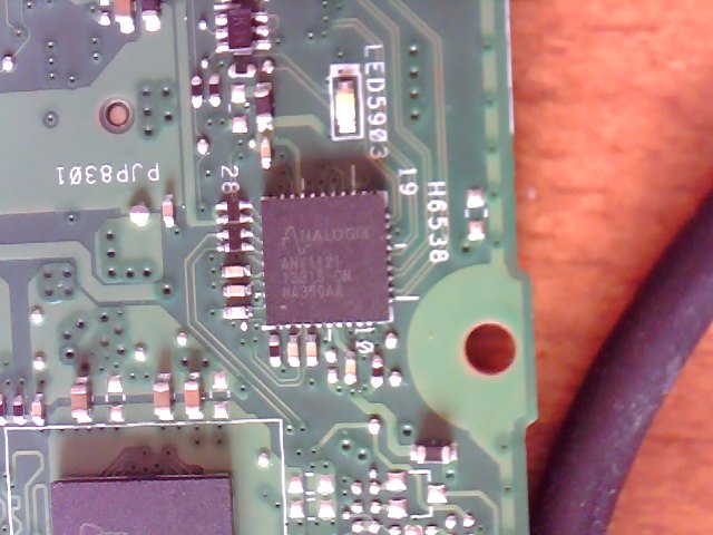

          This one Buddy ?
          • JaroTech
            • Mar 2015
            • 351
            This is not the charging chip, so give me the part numbers on the other chip, the first one with the 20 pins.

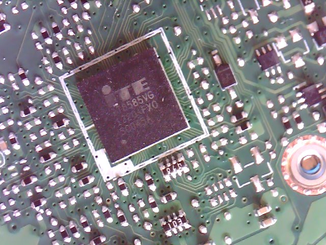

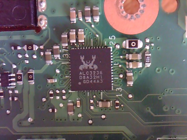

              Ok, i have posted the 2 remaining similar chips

                No, they are the EC and the audio chips, on the top side, a little higher of the name S301LA MB MAIN BOARD on the right you have a 20 pins chip, maybe this is the one.

                  Can you give me a good picture of this area on the motherboard so I can see the numbers.
                      Here we go, i see at least 2 more chips about the same size of this one !

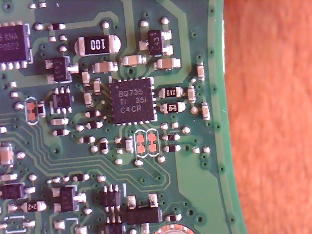

                        bq735
                        celui la est le circuit de charge
                            sans shema c'est un peu difficile pour tomber sur le composant cosant le probleme .
                            dans votre cas veuillez indiquer le nom de circuit d'allimentation
                            tps-rtl -........
                            et indiquer les mesures de voltages sur toutes ces pieds .
                            et vous devez trouvez vin=19v
                            bonne chance
                              veuillez indiquer sur la photo les mesures de voltage de toutes les pieds de circuit de charge bq735
                              et noter les noms des circuits sauf realteck and lan

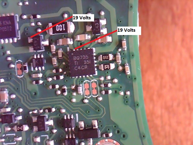

                                Ok, we found the charging chip, BQ735, measure the voltage on the pin 20 on this chip.
                                  Sorry for the late reply Buddy.
                                  Here what i measured, hoping that it was the good pin !
                                    You have the right pin and the charging chip is powered. Can you test the voltages with just the battery, it will be simpler for you to measure the voltages.
                                      I have this Notebook since +6 months, battery is empty, and because it's a vivobook, i don't have any other asus laptop capable of charging this battery.
                                      Which voltages to you want to be measured ?
                                        Ok, I have to extrapolate from a schematic who don't belong for your motherboard. You should have 0V at pin 1, and what do you have at pin 4?
