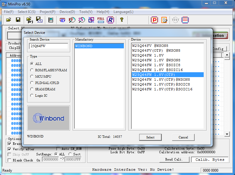

                Re: dead acer e5-411
                More Info:
                E5-411 Have bios chips low voltage just 1.8v, see datasheet winbond 25q64fws1g
                • polytek
                  • Dec 2013
                  • 496
                  • TUNISIA
                  Originally posted by meritosari
                  More Info:
                  agree with you meritosari, and most of them are (OTP)

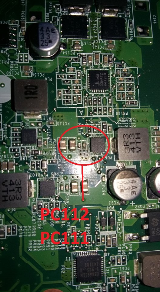

                    HI.. Good Day. Anyone have schematic for this DA0ZQMMB6E0 Rev:E
                    have some burned capacitor in 19v line. need to check value and to trace other problem in affected area. thank you..

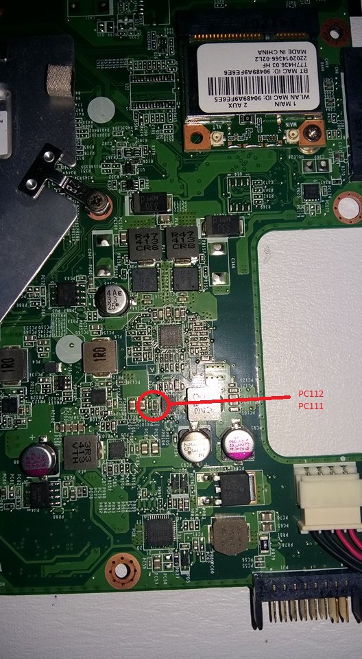

                      Re: Da0zqmmb6e0 rev:e
                      HERE is the picture of what i need. but if theres an schematic please..
                          shorted 19v line. i traced that PC 112 is shorted. i need to now exact value of that caps..
                          thank you,
                          • meritosari
                            • Oct 2010
                            • 774
                            • Indonesia
                            Use Quanta ZHK as refer :http://www.s-manuals.com/motherboard/quanta_zhk
                            the caps value are:
                            - 0.1U/25V_4 (0402)
                            - 2200P/50V_4 (0402)
                            How could be?
                            Quanta ZHK and ZQM using same IC NB671L
                            you'll find it at your donor board.
                                Thank you very much.. appreciated..
                                Laptop is fixed now.. thank you guys..
                                  i already remove that so i confirmed PU6 is already shorted,
                                  got lucky i have spare of that NB671LGQ Z NB671L AJPE.
                                  thanks to all.
