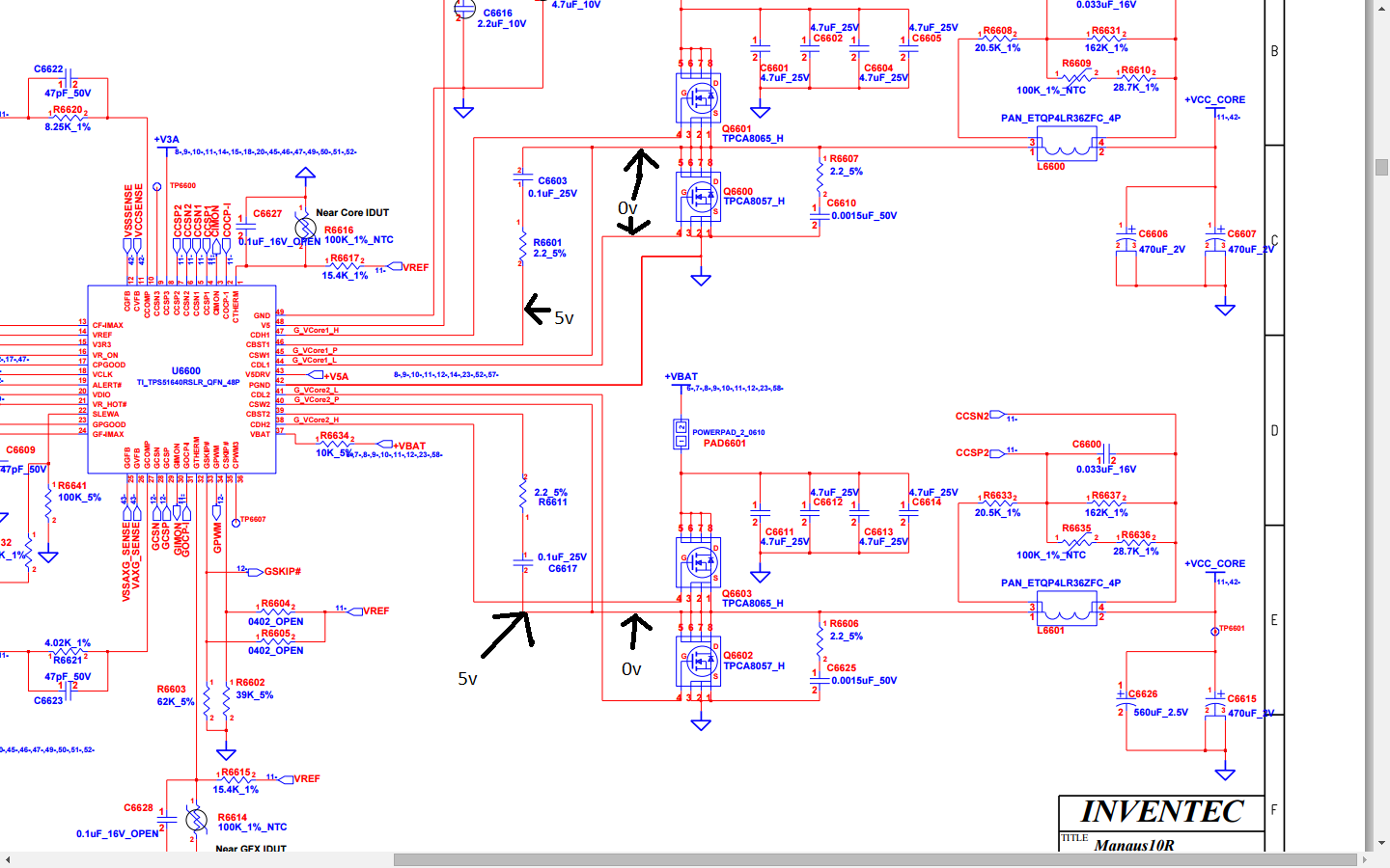

      Re: toshiba satellite c665 schematics needed
      please advice
      2 coils near cpu doesnt get power
      but 4 mosfets connected to coil are all good (checked both in and out of circuit) and receiving power of 19v
      but 0v on the opposite sides and pin4 which is the gate
      please advice where to check thanks in advance

              • YourLocalGeek
                • Feb 2015
                • 43
                • Philippines
                guys please advice
                bad ic?
                4 x mosfets are good in and out of circuit and switches on and off fine
                please see attached pic
                please advice where to check next?
                thanks!

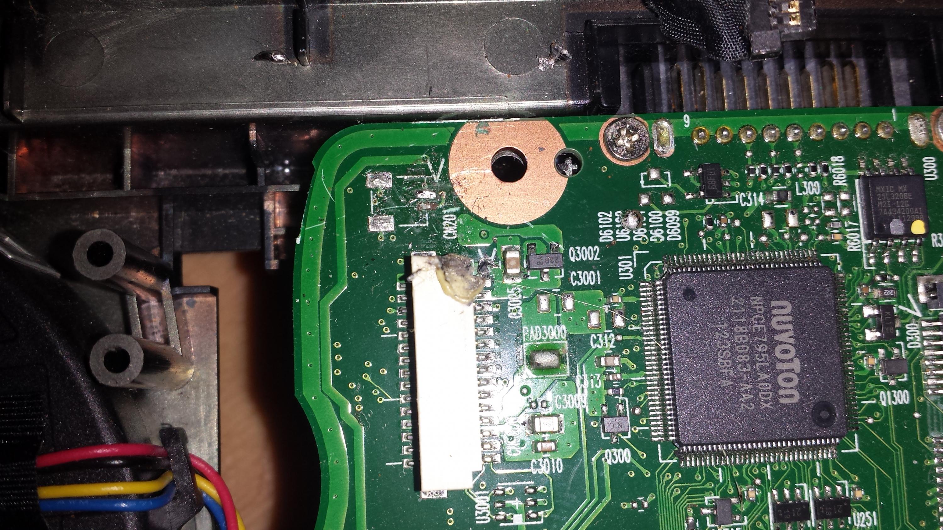

                  Toshiba Satellite C665 broke off on off connector point ( CM20) to motherboard Any other points I can extend wire to solder to that will do the job ?
                  • JakDac
                    • Jul 2013
                    • 5
                    NOW NO solder where else can I solder to for on off button ?
