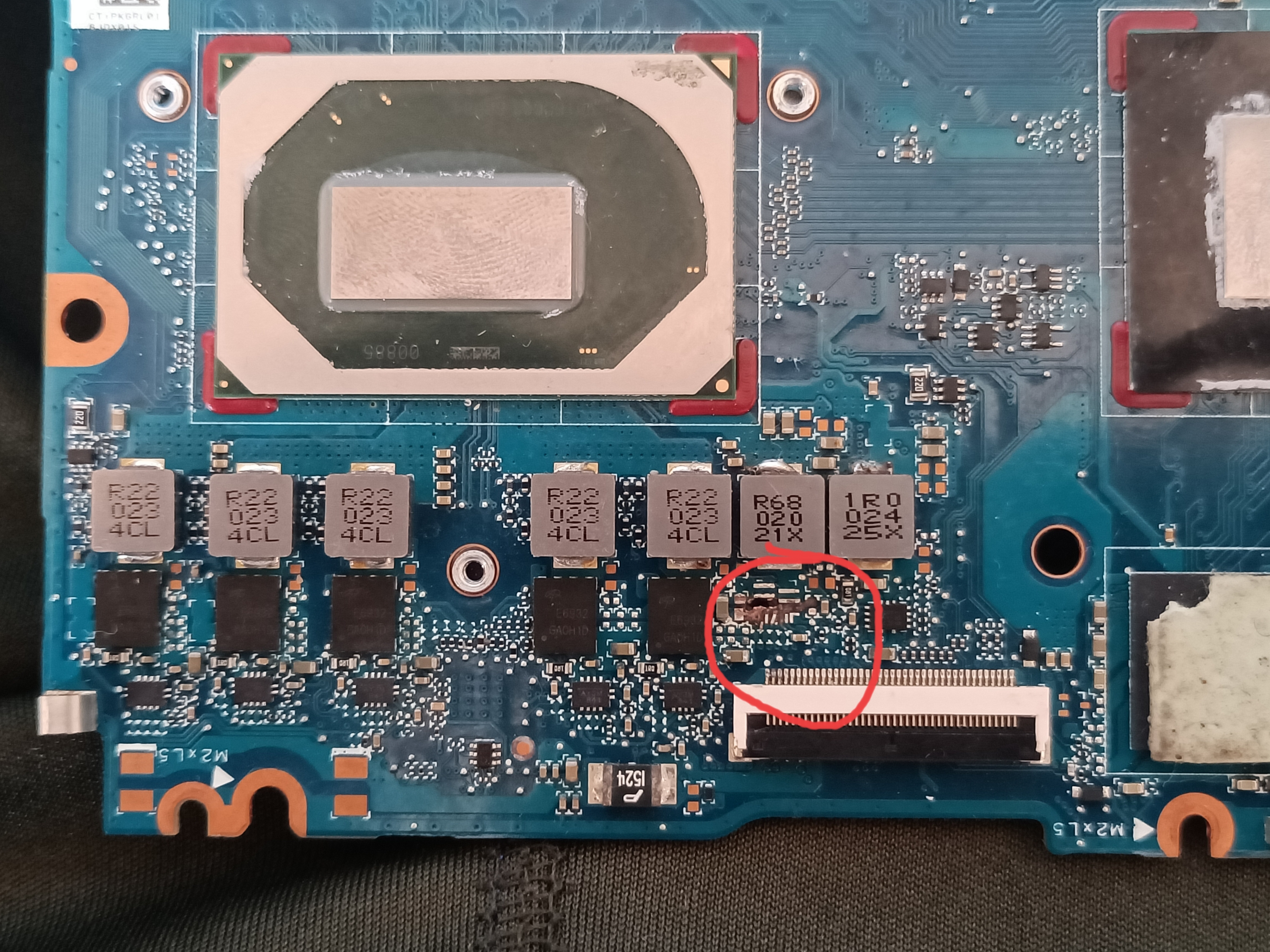

    A component got blowned up in OMEN Laptop - 15-ek0015tx. Can anyone share schematics and Boardview?

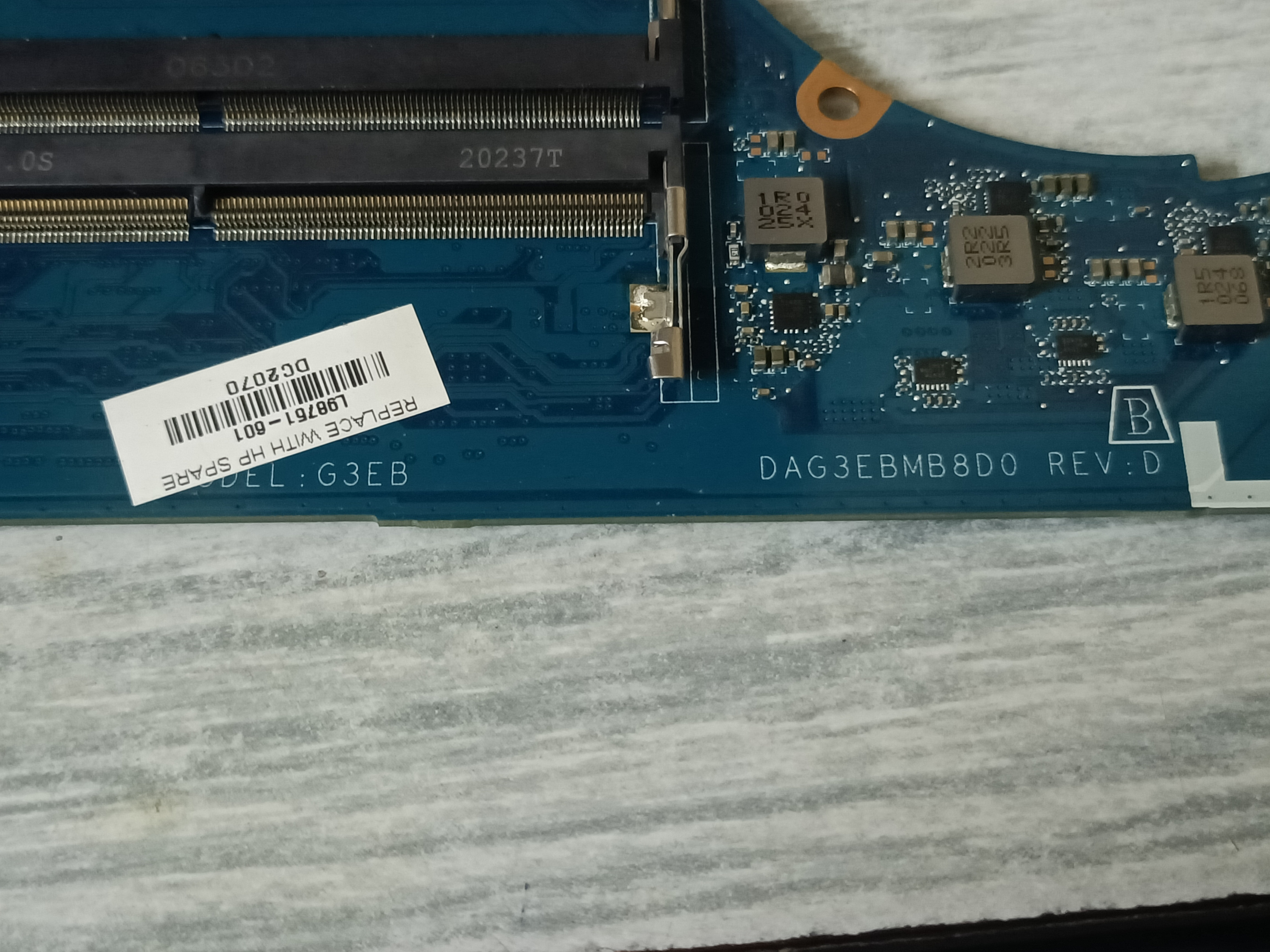

    Board - G3EB DAG3EBMB8D0

    Maybe somewhat late but I hope this helps someone.
    There is missing at center PU9101: MP86901-AGQT.
    To the left PC9118, not absolutely sure but usually 10uF 25V 0806
    To the right PC9114, not absolutely sure but it could be 4.7uF 25V 0402
    Now, if you still have the board I need the value of PR9828.
    Attached some photos and boardview.
