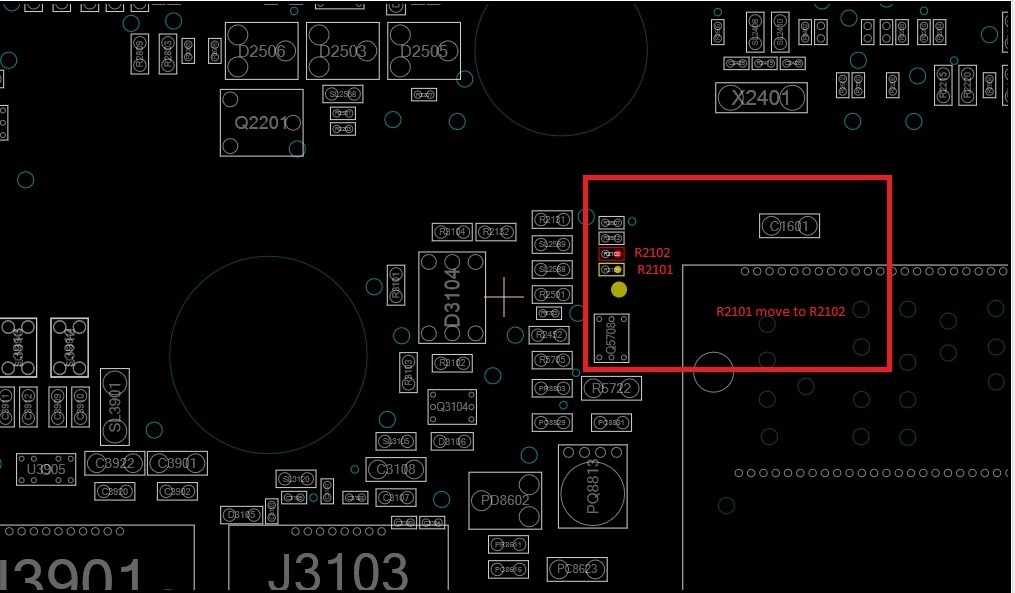

    I disabled onboard RAM on X415JA. May be help to someone.
    1. Remove the onboard RAM chips
    2.Move R2101 to R2102 (near the RAM slot)
    R2101 and 2102 located near to RAM slot
            Originally posted by michelraj410@gmail.com
            images not download
            here
