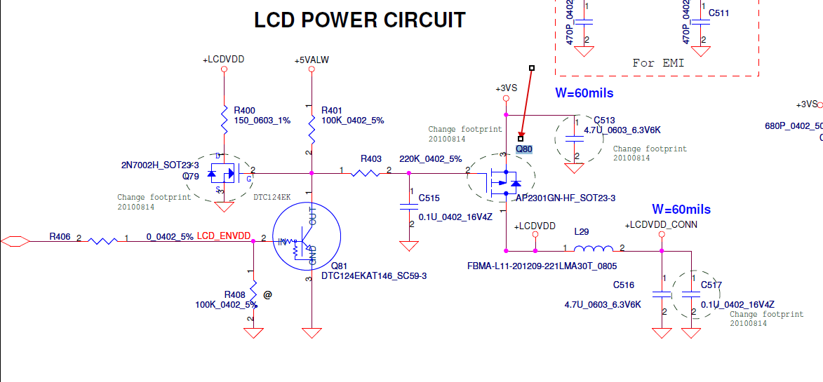

    Need schematic for this laptop Lenovo G570 core i3, Board model: PIWG2 LA-675AP Rev 1.0
    Screen displays only white transistor q80 is blown. need to know value. thanks very much

    q80 - ap2301gn-hf_sot23-3

        Thank you very much kotnatan and atsio! I'll check this out and let you know the progress
                    Please I need the number on transistor q80 lenovo g570, corei5
