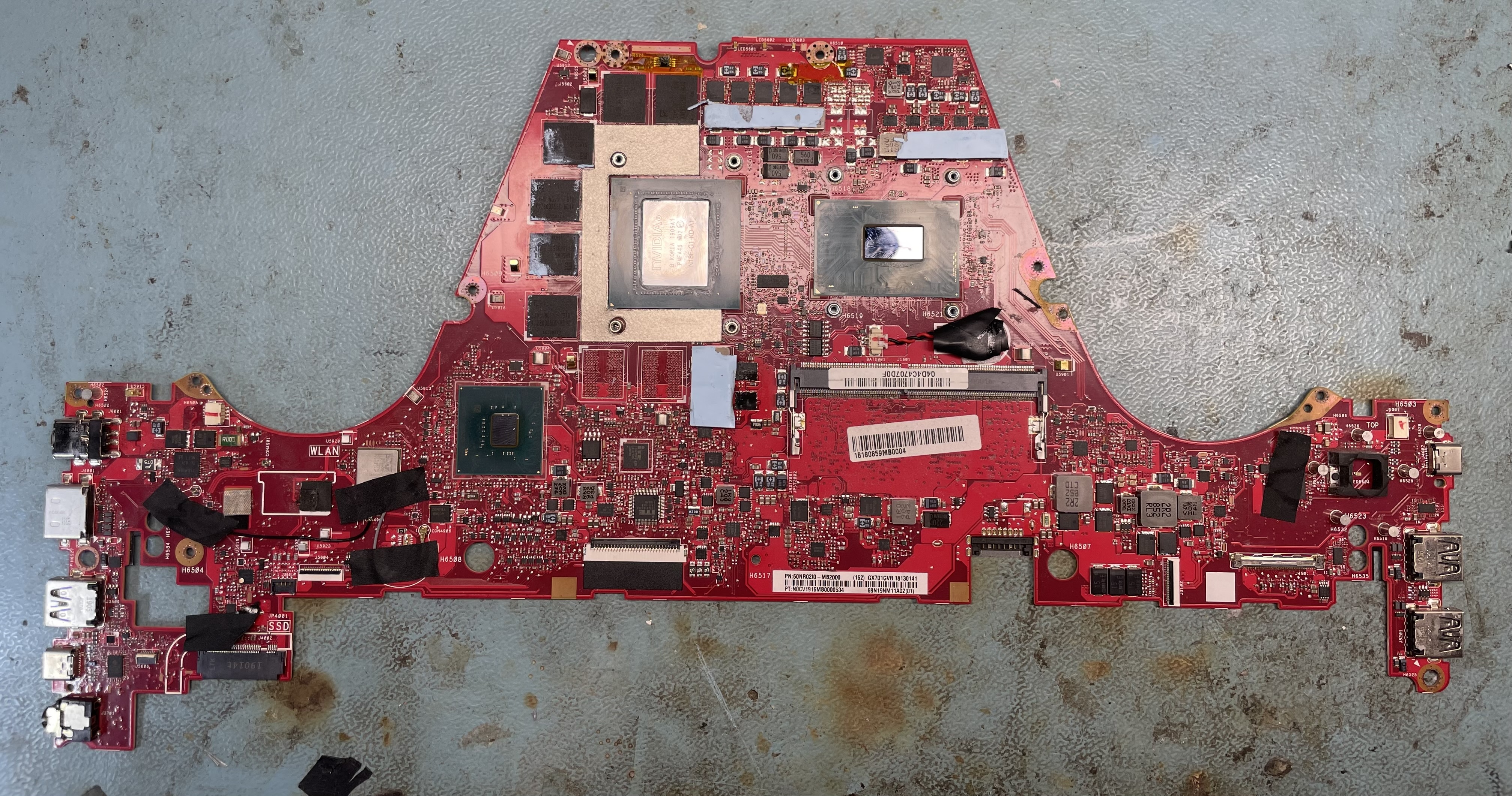

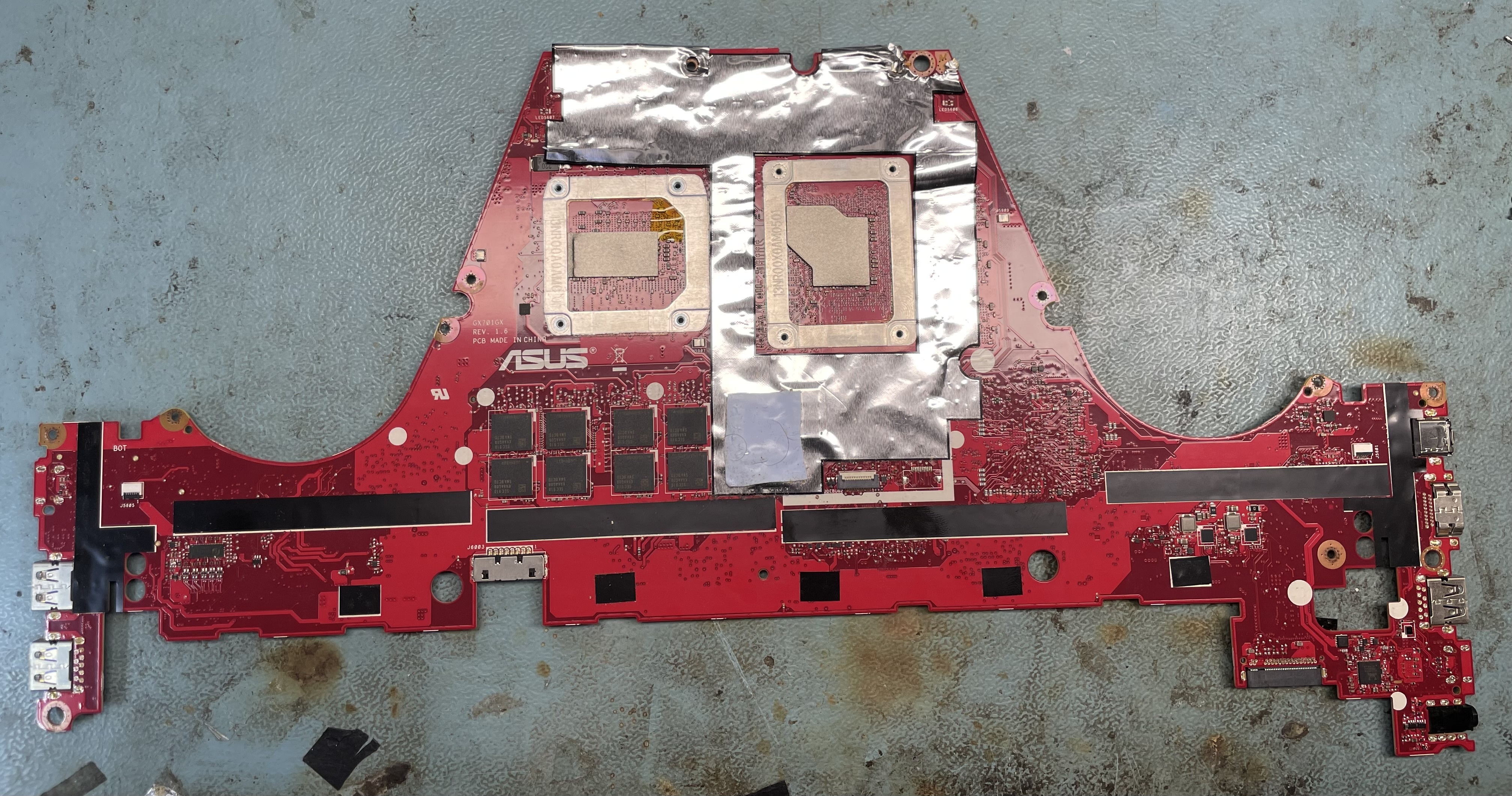

    I have here gaming laptop asus ROG with motherboard problem. Only orange LED is on, battery charging. 3.3V is on power button and on bios chip. 5V also present. All resistances on coils looks fine instead of GPU coils, only 0.5-0.6Ohms to ground. I don't know if gpu is dead. Can samoone help me to diagnose this problem? Thanks.
    Have someone schematic/boardview for this board?
    GX701GX REV. 1.6
    Click image for larger version  Name:	IMG_3026.jpg Views:	0 Size:	2.99 MB ID:	3274440
    Click image for larger version  Name:	IMG_3027.jpg Views:	0 Size:	2.60 MB ID:	3274439

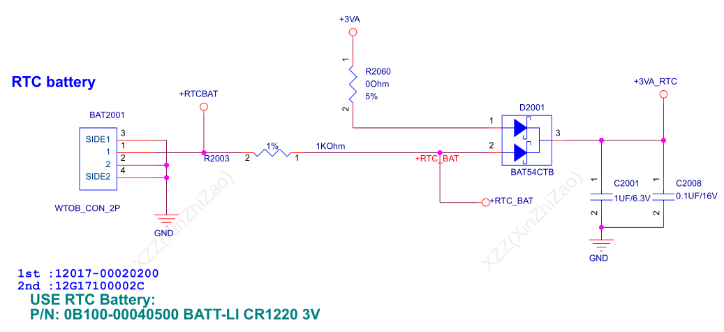

    Check the RTC battery.

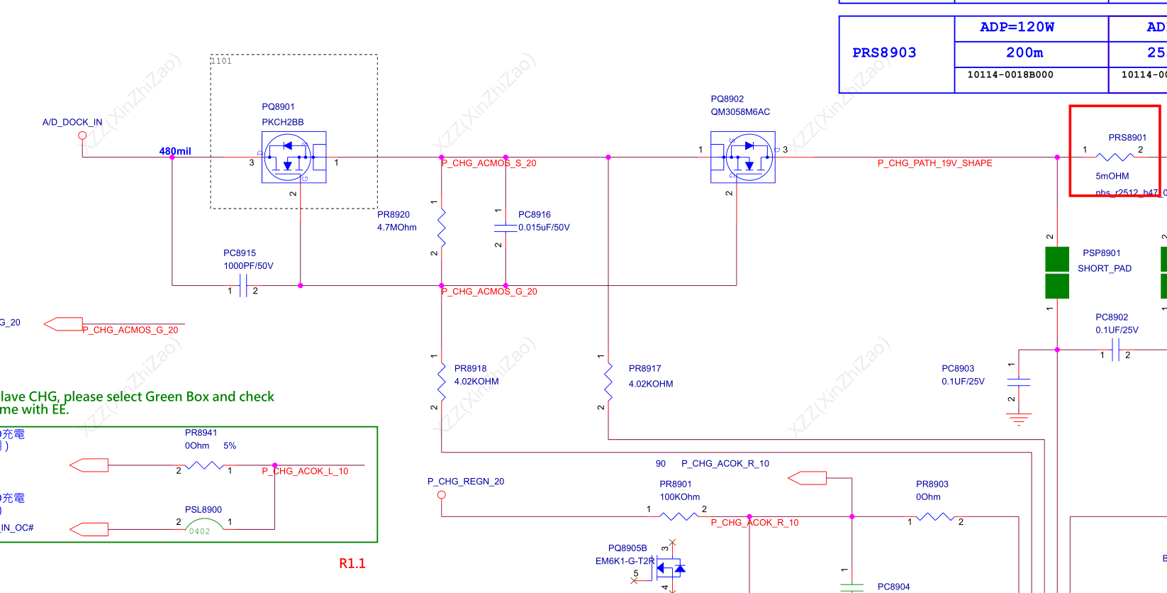

    Check the voltage to ground of the DCin mosfets x 2.
    If you are not seeing ~25v on the gate pins of the DCin mosfets, then continue to check the voltage to ground on the charger IC:
    REGN ; pin 24
    VCC ; pin 28
    ACDET ; pin 6
    ACOK ; pin 5
    ACDRV ; pin 4 = should be the same voltage as measured on the above gate pins on DCin mosfets.

      RTC battery has 3.0V. 25V are present on gates of DCin mosfets. Battery is charging. Now after few atemps laptop starts normally - I see post logo. After few times when I turning laptop off and on - again nothing only orange led is ON.
