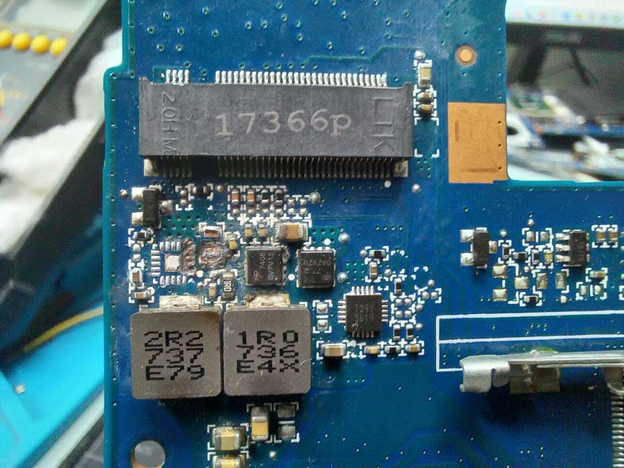

    need this ic model and how to solve this

      PU11 - SY8288CRAC

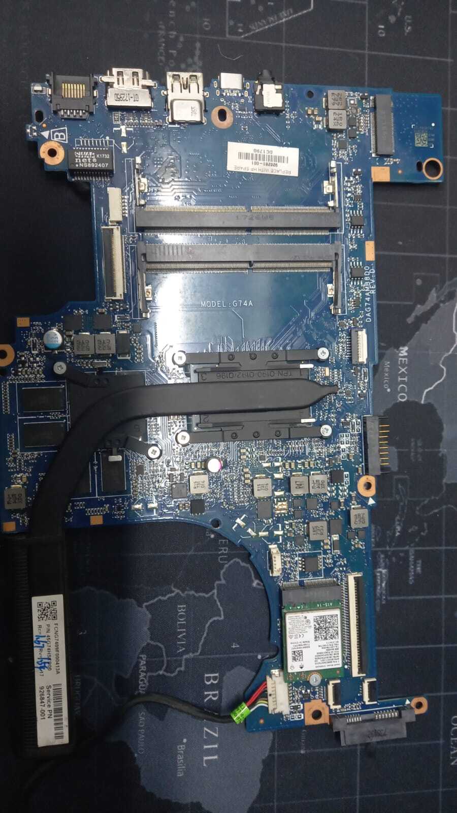

        hello firends
        i search the schematic or boardview
        I have this motherboard, but I can't find the schematic or the boardview.
        The problem is that on the chip marked where 3V should be, there are 5 volts, which indicates that the two are connected.
        So the computer doesn't turn on, and the 3V disappears after a few seconds.
        The original problem was that when I turned off the computer, the fan stayed on and saw that it was bad since it was directly in the 5V area.
        The new problem arose after removing the bad chip.
        3V and 5V remained together,...
