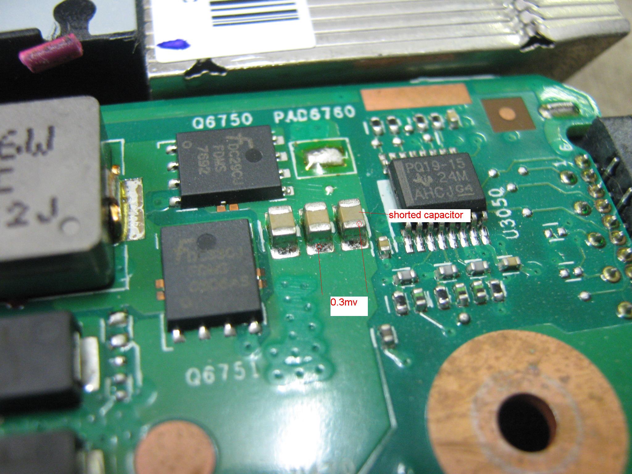

      Thank you for the link! I already fixed the problem. It was a shorted capacitor.

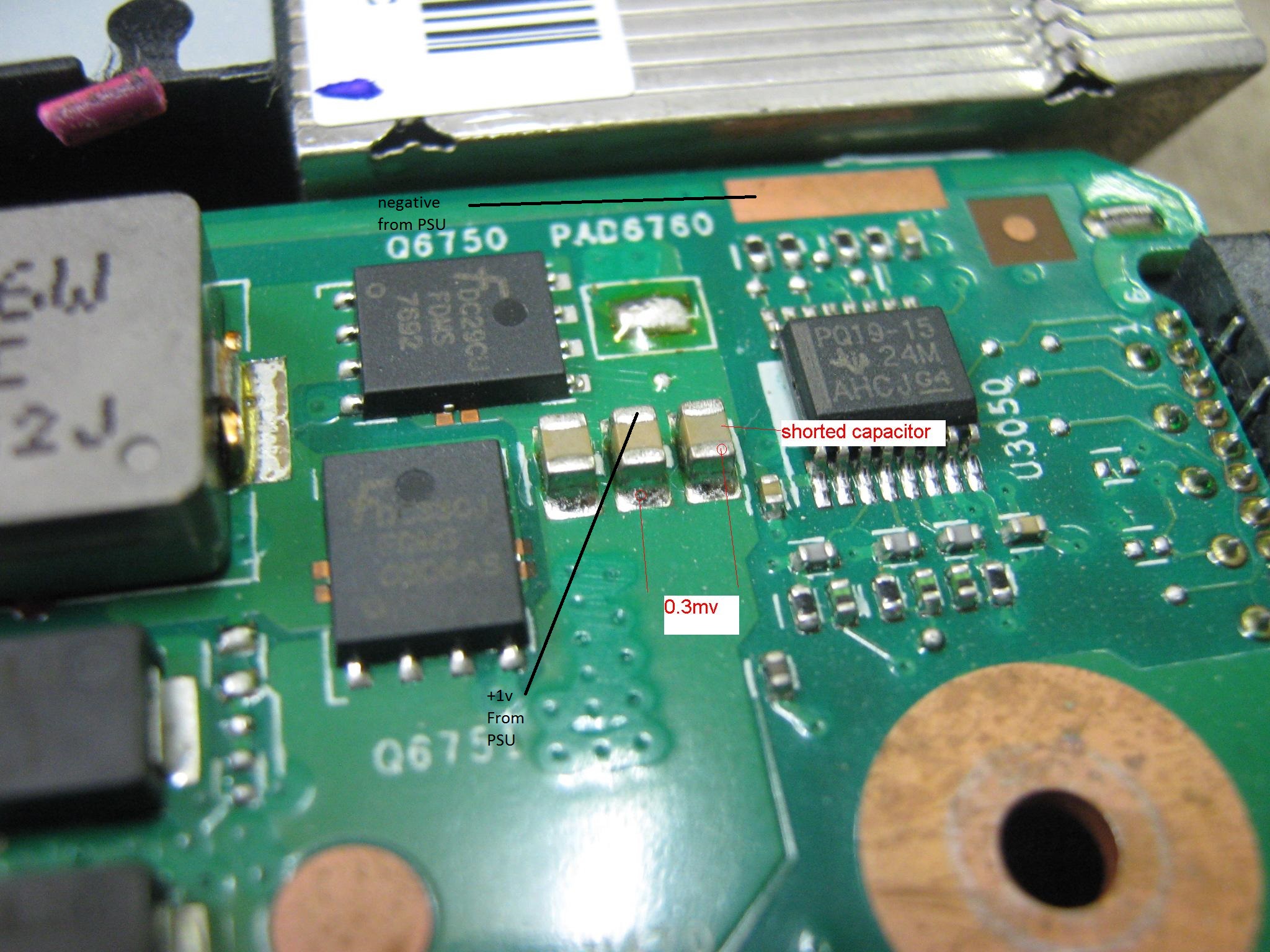

          I injected around 1-2v at the +PWR_SRC and observed the component that heated up. Removed the component from the board and verified that it was the culprit.

                I have been finding shorted capacitors by measuring the voltage at the capacitors's ground end with the millivolt range. I try to get the current up to 0.5A but dont exceed 1v incase the problem is really a shorted High Side MOSFET.
                The readings gradually increase as you get closer to the shorted capacitor. There usually is a very small voltage difference between a nearby solder fillet and the top of the end cap at the shorted capacitor.

                    The short is usually on the VBAT+ rail. Its the rail that normally has battery voltage or adapter 19v on it and feeds most of the Buck regulators.

                      Its also possible to narrow down the location of the short by removing those solder blobs that you see joining breaks in rail tracks. I use a large tip and desolder braid. Adding some leaded solder and flux first, makes it easier to clear all the solder from the very narrow gap.

                            On the B+ rail. On page 43, either end of PL6 will do.

                                  First you should do a resistance reading between one end of PL6 and ground to see if there really is a short.
                                  If there is, connect The + of the bench supply to one end of PL6 and the - to ground print.
                                  Dont apply more than 1v.
