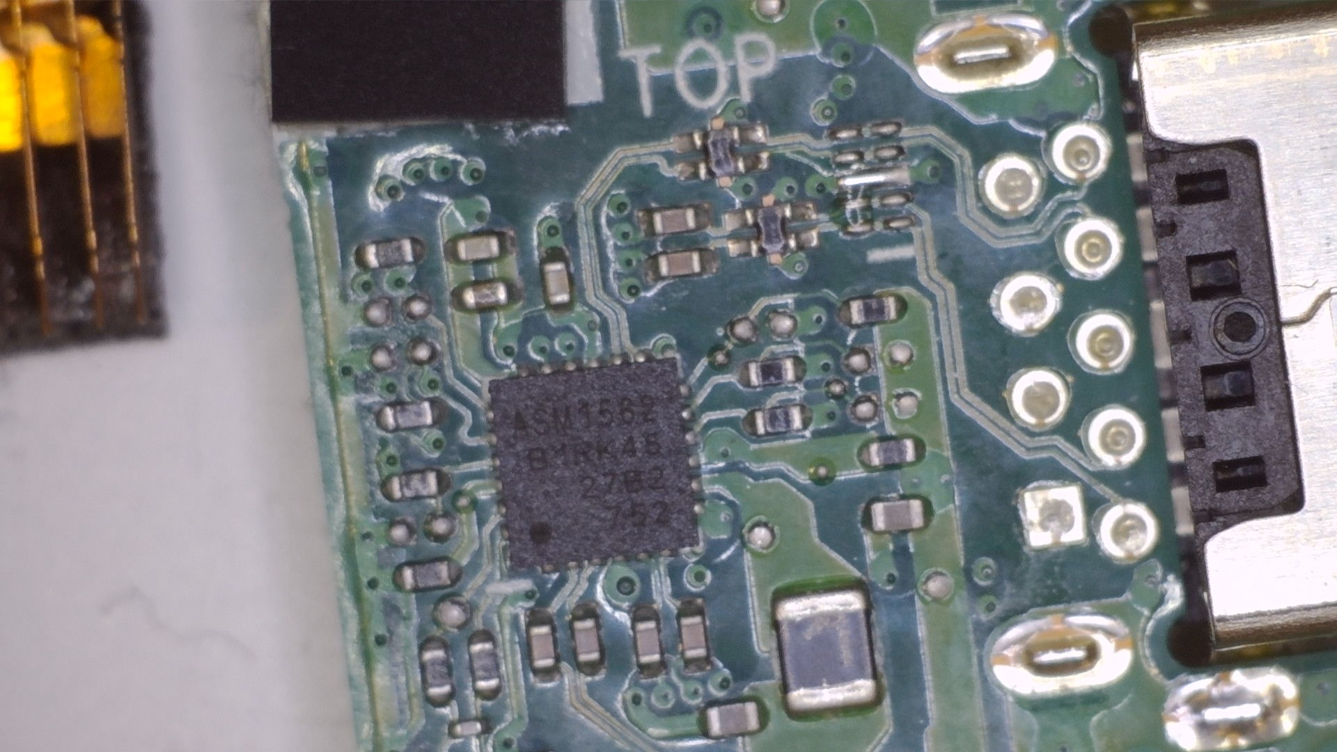

    Hi guys
    looking for schematic or boardview for ux550gd.
    I have 2 chips that getting hot one get to 65 degrees. The chips are near the sub port each port has 1 chip, VCC dropping to 1.2 volt from what should be 5 I think
    Anyone has datasheet for these chips, attached photo

    Re: ux550gd schematic OR boardview
    This is an USB bus retimer to open up the 'eye' pattern across long PCB traces.
    The device operates from 1v8 and 1v2 rails.
    https://www.asmedia.com.tw/product/e...2Yq21RG3gp8Xi8
    Perhaps is defective from some transient / surge event? They are available from Aliexpress stores.
      Thank you very much thats help a lot

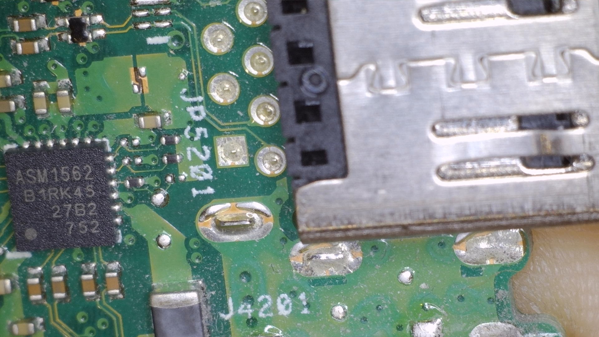

        Asm1562
          Originally posted by AL._.EX
          Asm1562
          Thanks man, it's to hard to fix something like this

            Hy there any fix? I have the same problem!
            Also my GPU is getting hot! When i plug the power the led from power on button is turning on, and nothing happen I have 1.8V 1.2V 19V 5V etc. on the board!

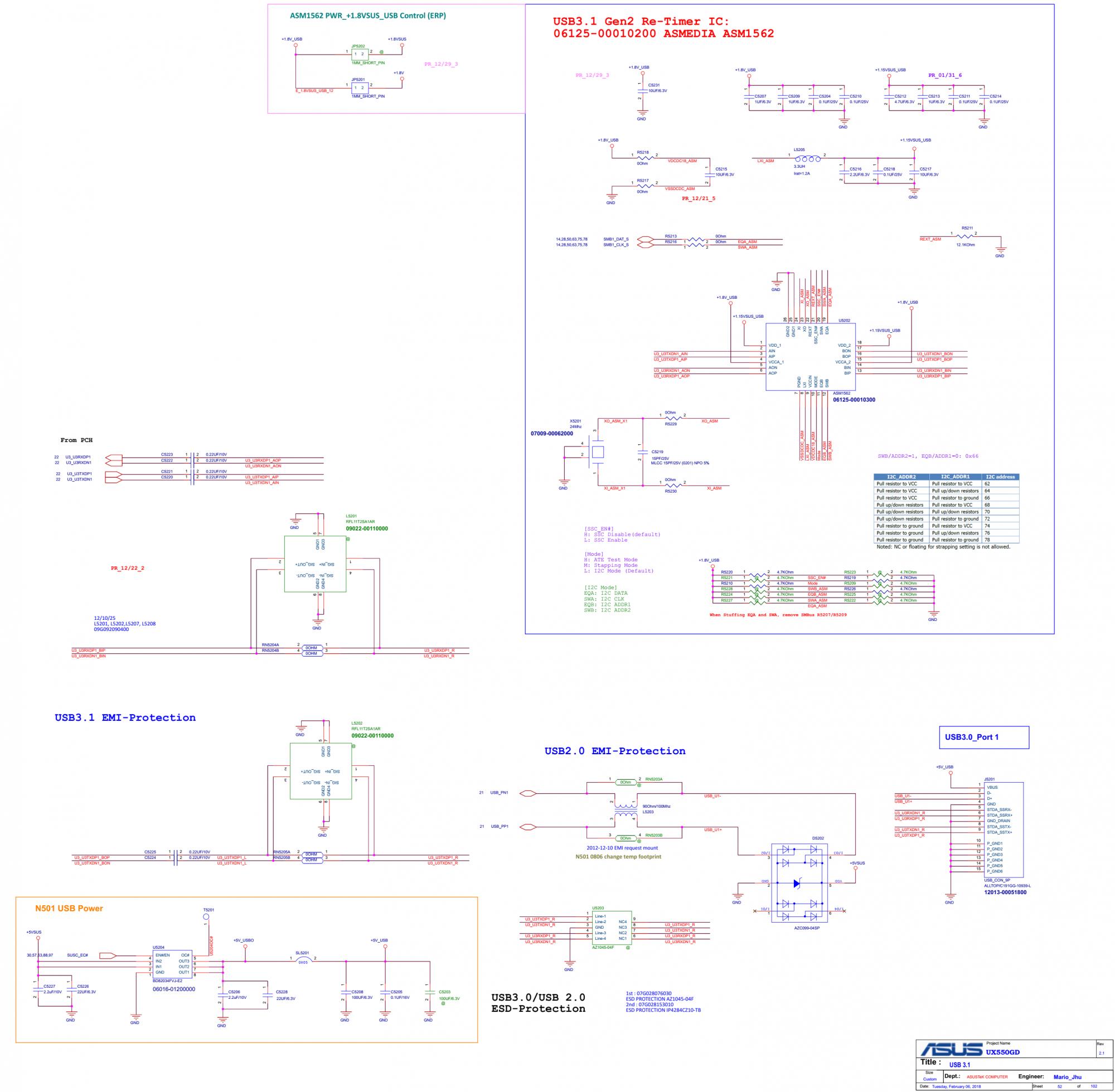

              BoardView is available, anyone has it?
              • Gernet
                • May 2021
                • 51
                • Italy
                https://www.badcaps.net/forum/troubl...69#post1793769
