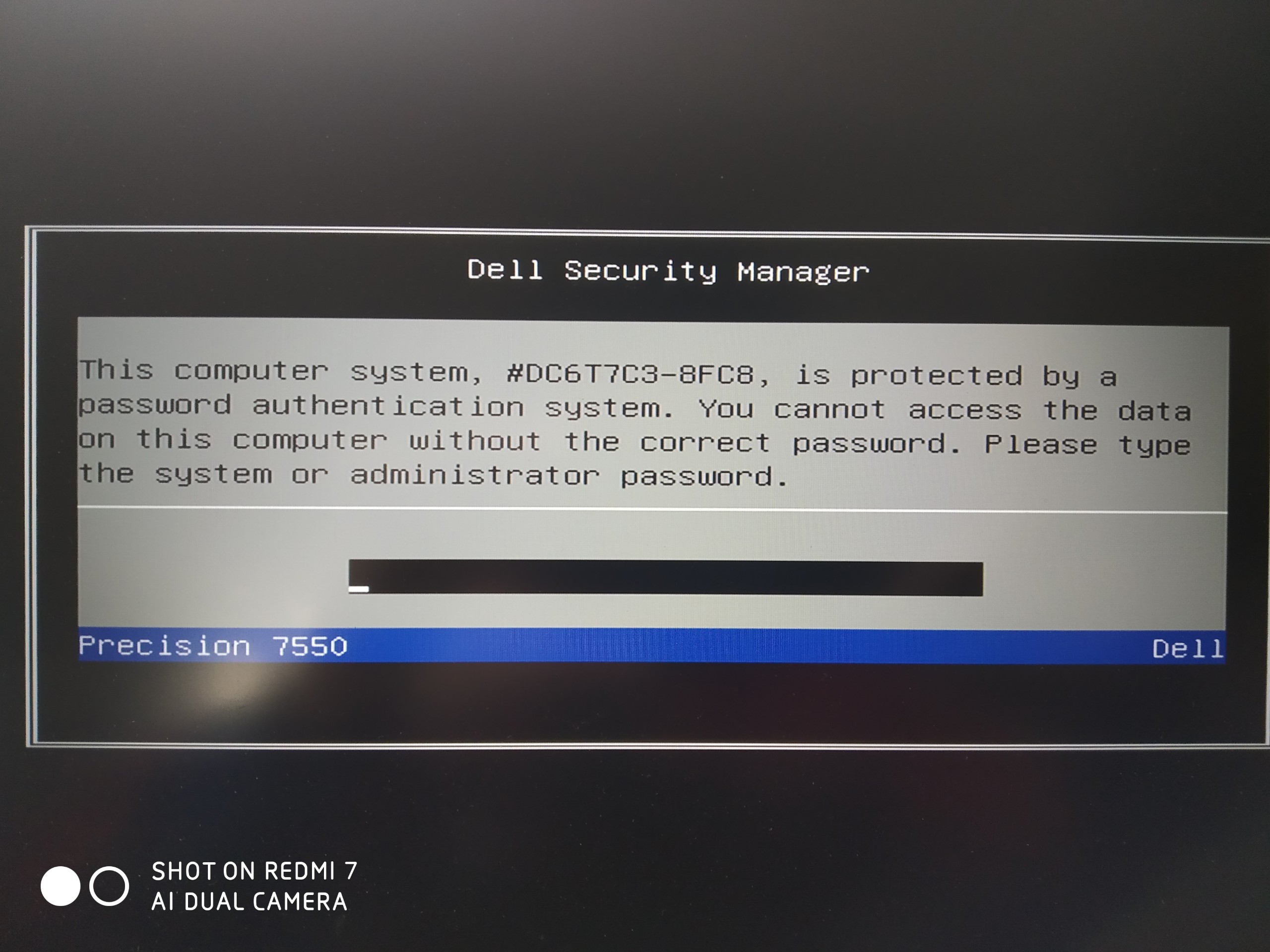

    dell 7550 pass
    please unlock it 8fc8
    Premium supporters get full download access and other benefits.
  • lapfix
    • Mar 2020
    • 2772
    • my workshop
    Re: dell 7550 pass
    Try and give feedback
    1st boot, press F2, write service tag, disable Absolute, save, restart. 2nd boot press Alt+F to exit manufacturing mode.

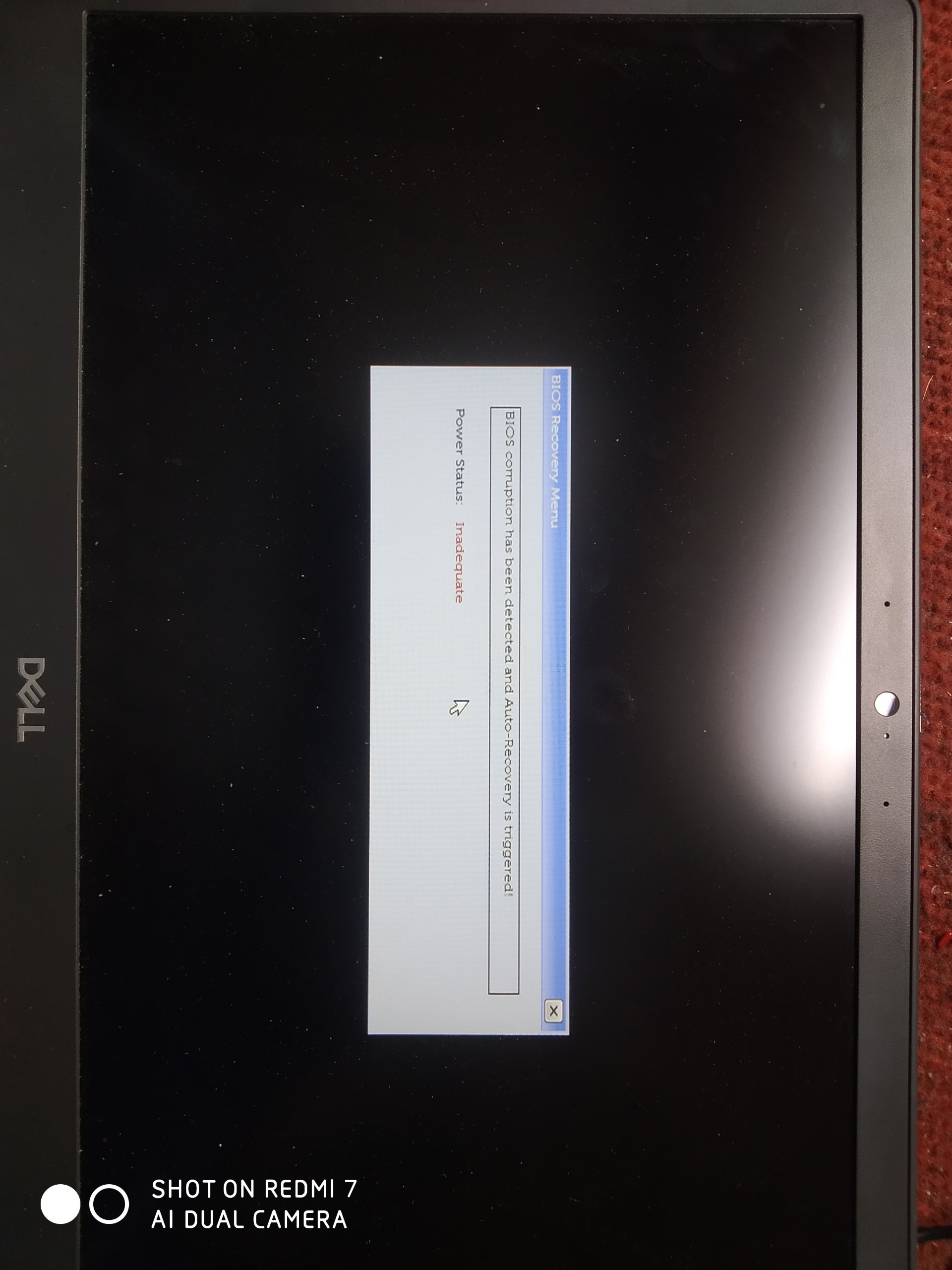

      Re: dell 7550 pass
      1st boot, press F2, write service tag, disable Absolute, save, restart. 2nd boot press alt+L to exit manufacturing mode.
      press f2 error like picture

        Re: dell 7550 pass
        So the 8fc8 is gone !! need to clean me this bios

          Re: dell 7550 pass
          alt + F or Alt + L ??

              Re: dell 7550 pass
              You are right : Alt+F

                  Re: dell 7550 pass
                  despite is written on screen, now he'll ask you: alt+F or alt+f?
                  As volinakis say , the alt+f is asking at the screen..
                  @trunguntilyou : power off your lap , power on and see if your 8FC8 is gone ,
                  the lap will ask you to write your service tag , so writed , save and disable Absolute than restart.
                  if your lap asking you for a step to make = alt+F than do it
                  Now you have your bios unlocked and ok

                    Re: dell 7550 pass
                    Thank you very much, the laptop is working very wel

                      • qayyum786
                        • Aug 2018
                        • 1959
                        • INDIA
                        Re: dell 7550 pass
                        Flash Given Bios Than Follow Post #5
                        MAKE A UNIVERSAL BIOS ANY ONE CAN USE IT FOR NO PWR, NO DISPLAY, OR REMOVE 8FC8 FOR FUTURE
