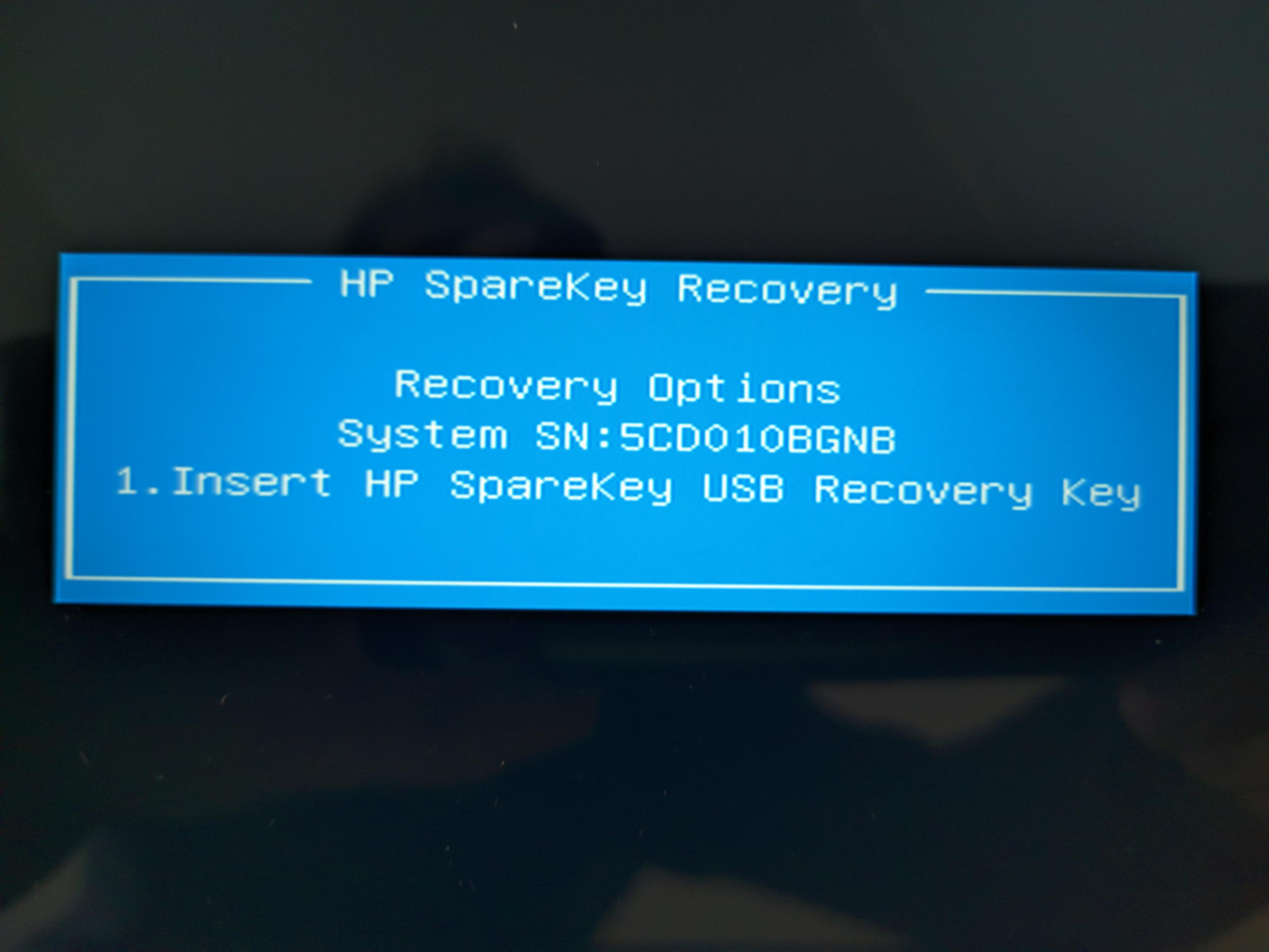

      If i enter 3 times an invalid password it ask for a hp sparekey, which i dont have.
      I found another chip, Winbond 25Q80DVSIG. There is also a WSON 8 Chip Winbond 25X20CLIG. But i dont have a probe for WSON 8, so i have to solder. So i first wanted to try the 25Q80DVSIG Chip.

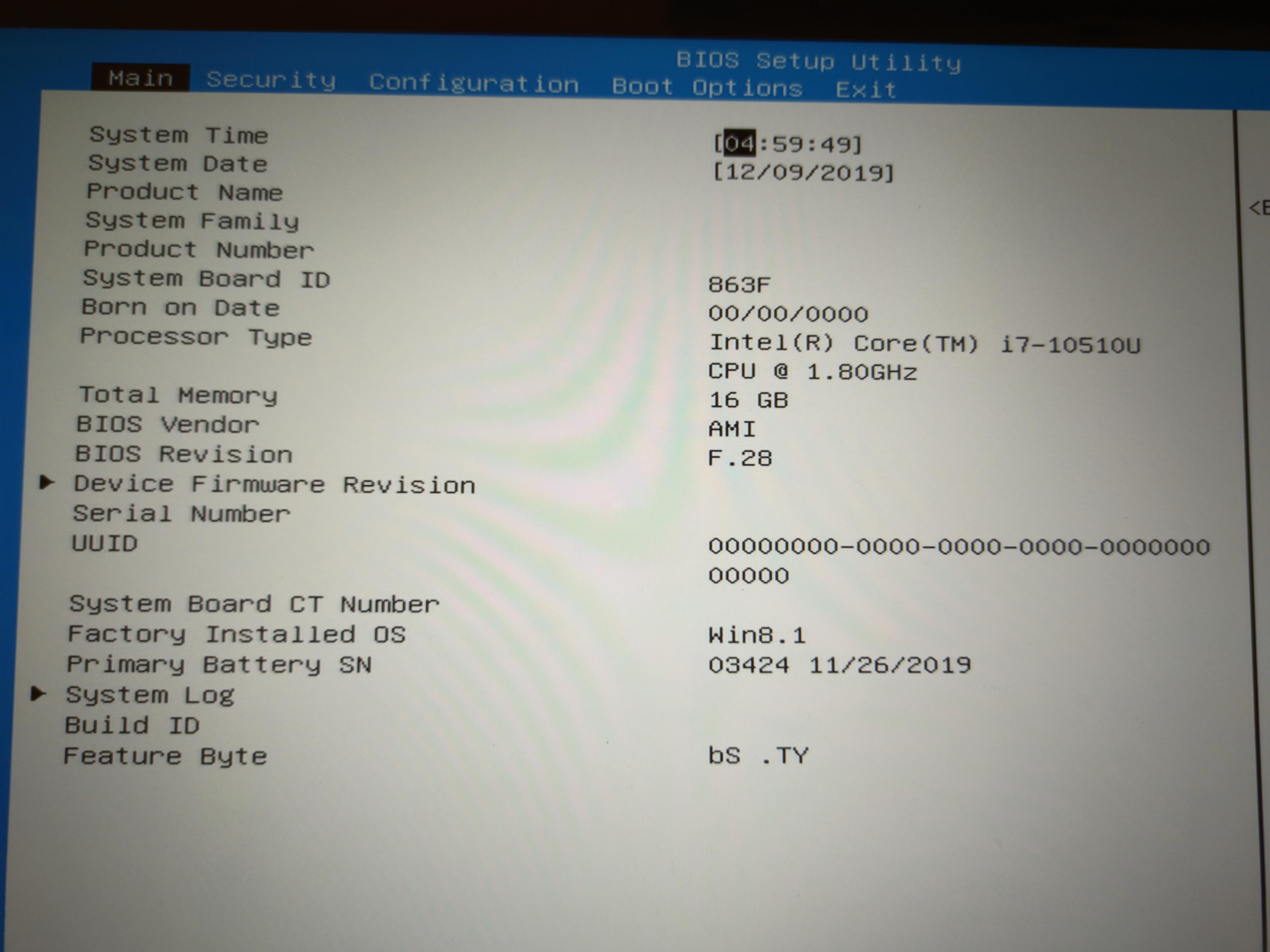

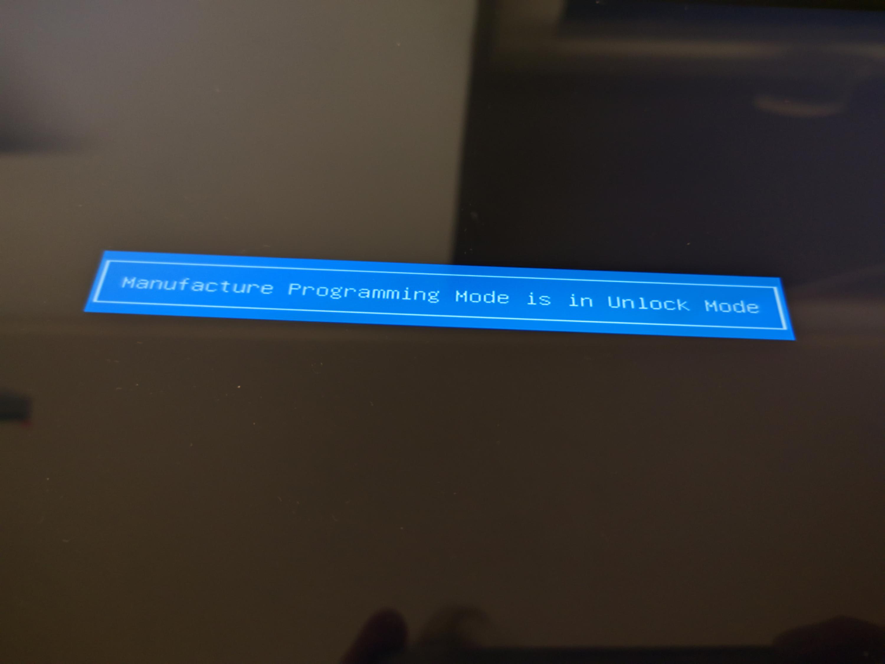

                      I flashed a clean bios from the newest HP bios firmware. Now the laptop starts without password, but it lost serial number, windows key etc. and says, that " Manufacture Programming Mode is in Unlock Mode ". What is the best way, to enter all data from my dump with password into the clean bios file?

                        Re: HP Spectre x360 15-df1004ng BIOS startup password
                        Try this one.

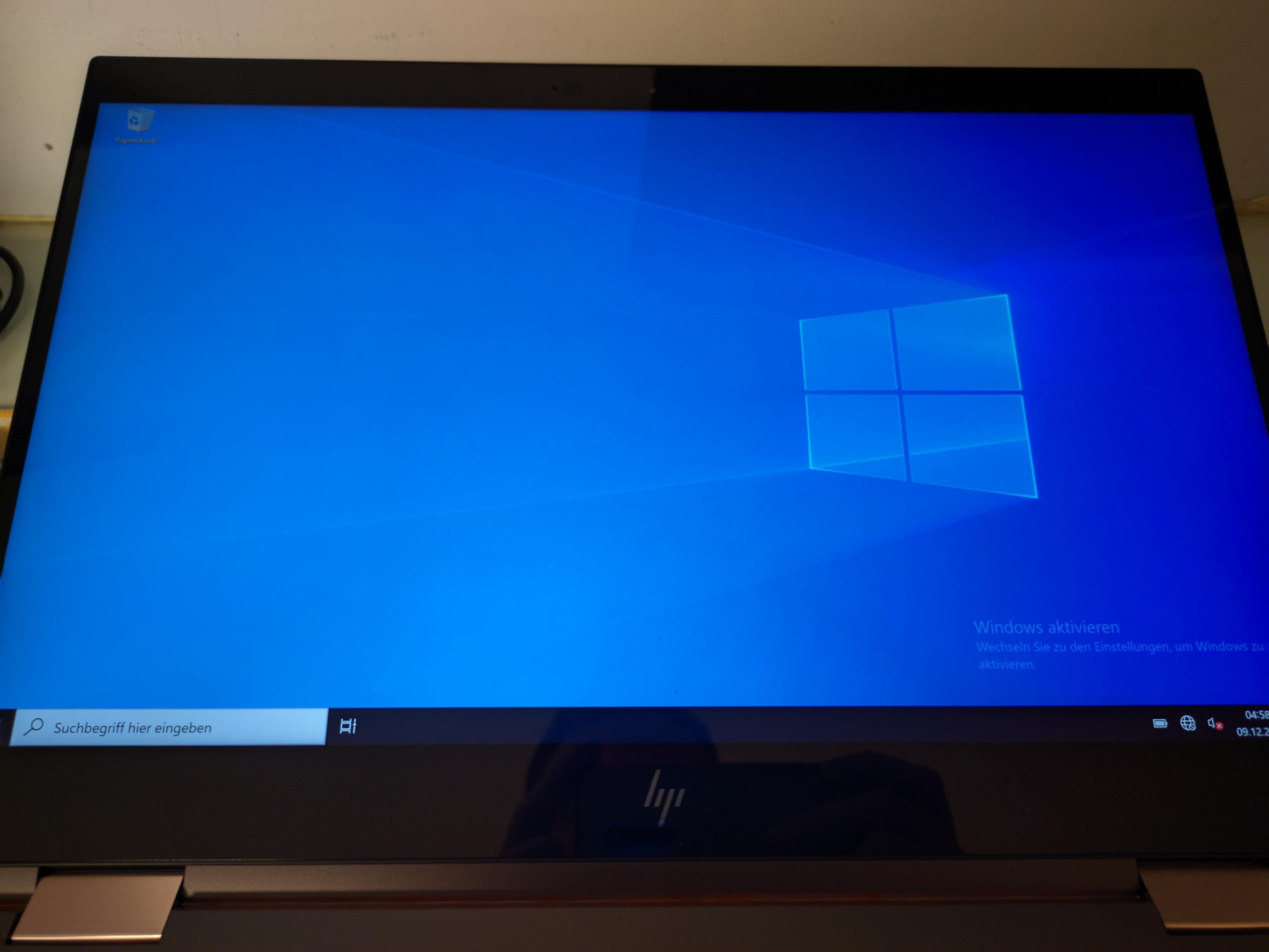

                          Hello, sorry for the late answer.
                          Works perfectly, no errors, thank you!
