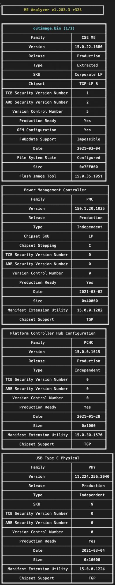

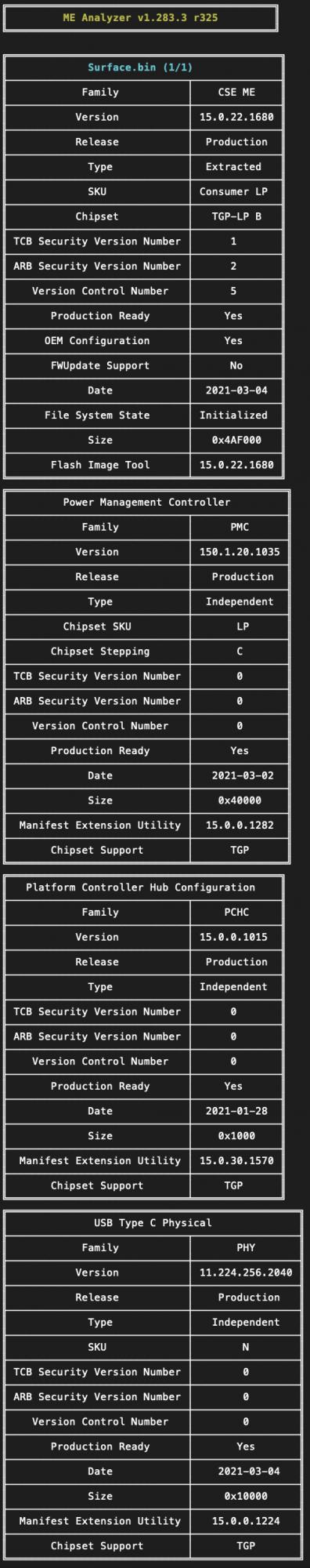

        Hello, I need help with my Surface Pro 7+. Basically it turns on to Surface logo and after a second turns off. I get roughly 2-2.2 volts on the BIOS chip when I press the power button then it power cycles down. I followed instructions to analyze ME region and no issues have been detected, but I went and cleaned the ME anyways. Here are the two files, can someone help? I have a few other Surface Pro 5's that are doing the same as well. After soldering the BIOS chip back on, the behaviour is still the same. Turns on, Surface logo, turns off.
        Model: Surface Pro 7+ (1960)
        I also attached screenshots before and after ME cleaning.
                      Hello! Did you manage to solve the problem?
