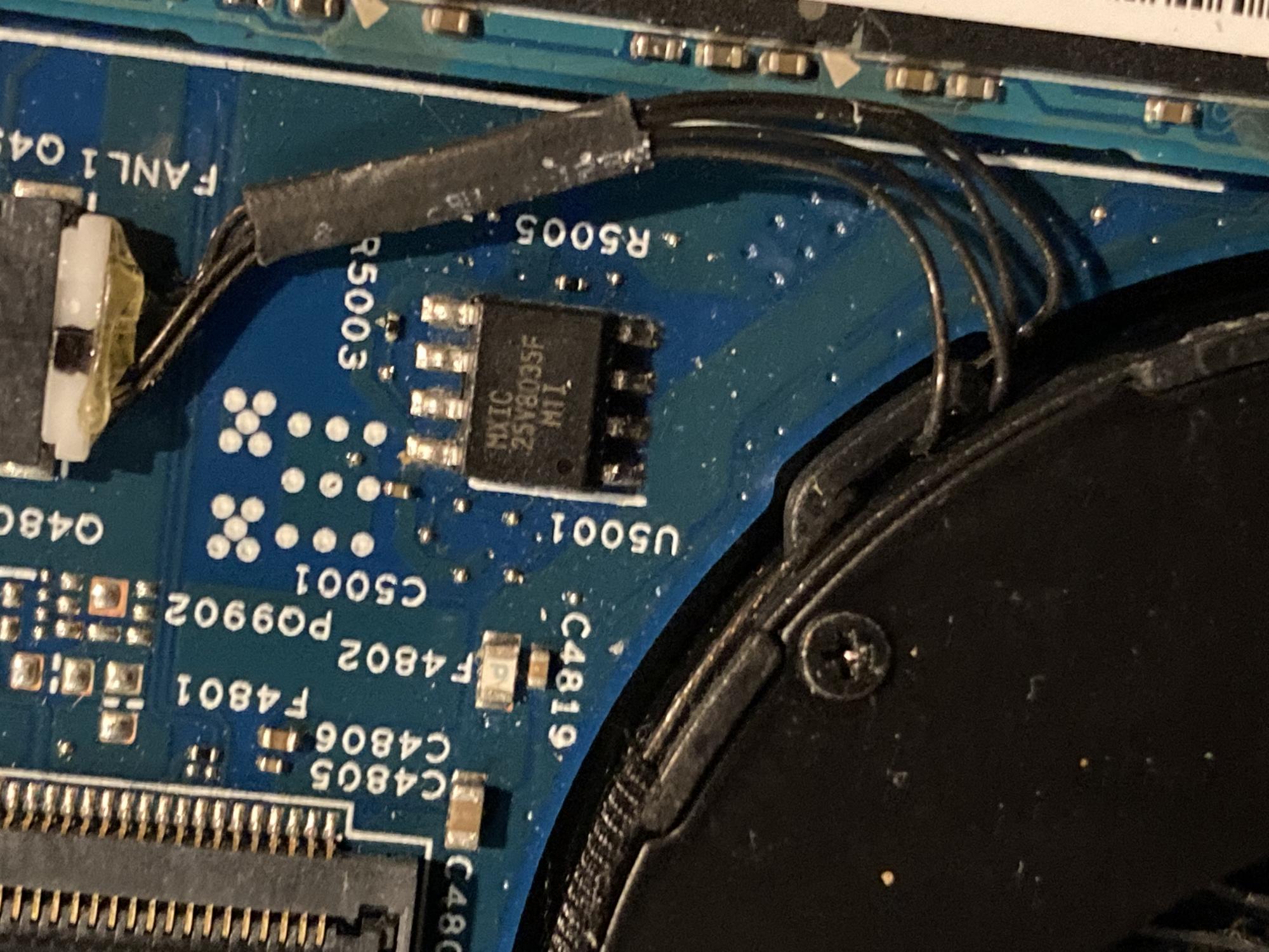

    Hey lovely people
    Is anyone able to help with a bios bin file I can flash my currently bricked thinkpad with please?
    Type 20MF-CT01WW
    S/N R9-0P26JZ
    Thanks a bunch!

    You chip should be more than 8MB! upload image for your bios chip or write what's written on it. Also try to read your chip again.
      Oh dear, maybe I've been clipping onto a chip that does something else…
      After careful disassembly and examination of the MB this was the only seemingly relevant chip I found.

        Originally posted by misamiso
        Oh dear, maybe I’ve been clipping onto a chip that does something else…
        Is not it. Find any chip with or without pins with 128 on the face of the chip, for example 25Q128V.....
          I found a suspicious looking Winbond chip in the right location and reading it at the moment... 32mb too!

            Here's what I found on the chip...
              Here's your new file, try it and give me the results.
                OMG, you're an actual living legend, it booted and has come back to life!!
                I can't believe it and never thought I could actually fix it along with soldering tiny wires to the bios chip!
