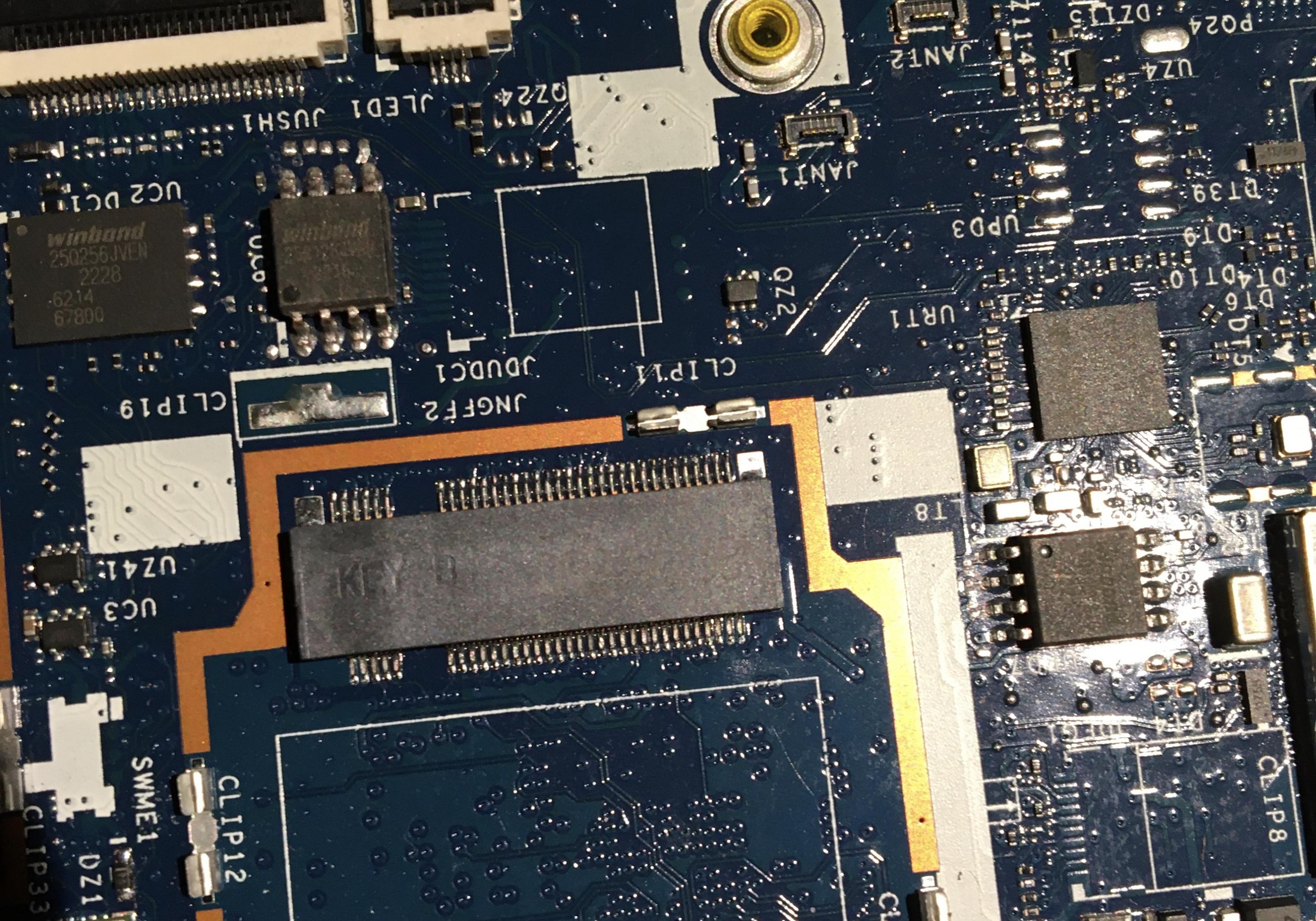

Latitude 7430 bios
  • aldopc
    • Jul 2017
    • 465
    • Chilito
    Re: Latitude 7430 bios
    Originally posted by santoslao
    Please help me with removing BIOS password from the attached dump
    Thanks!
    Hi Test and comments
    • ramkaskad12
      • May 2018
      • 54
      • ukraine
      Re: Latitude 7430 bios
      Help me to unlock dell 7430
      • qayyum786
        • Aug 2018
        • 1933
        • INDIA
        Re: Latitude 7430 bios
        Originally posted by ramkaskad12
        help me to unlock dell 7430
        try
        • ramkaskad12
          • May 2018
          • 54
          • ukraine
          Re: Latitude 7430 bios
          Originally posted by qayyum786
          try
          it worked thanks
          • feherhollo
            • Nov 2019
            • 110
            • Hungary
            Re: Latitude 7430 bios
            Originally posted by santoslao
            The only solution is to cut vcc tracks from the bios chip 256.
            So you need to cut motherboard or remove the chip? No way to do elsewhere without physical damage?
            Last edited by feherhollo; 09-06-2023, 07:35 PM.
            • santoslao
              • Apr 2017
              • 101
              • BZ
              Re: Latitude 7430 bios
              Originally posted by feherhollo
              So you need to cut motherboard or remove the chip? No way to do elsewhere without physical damage?
              this is just an option, but there is no other way than to remove the chip and use an adapter.
              • feherhollo
                • Nov 2019
                • 110
                • Hungary
                Re: Latitude 7430 bios
                Originally posted by santoslao
                this is just an option, but there is no other way than to remove the chip and use an adapter.
                Thanks. I think there is no other way to read out chip by cable on circuit like before. I had the same experience with other 12gen latitude models like 5430,5431 and 7430. Unable to read and erase correctly on circuit.
                • santoslao
                  • Apr 2017
                  • 101
                  • BZ
                  Re: Latitude 7430 bios
                  Originally posted by feherhollo
                  Thanks. I think there is no other way to read out chip by cable on circuit like before. I had the same experience with other 12gen latitude models like 5430,5431 and 7430. Unable to read and erase correctly on circuit.
                  unfortunately these new models cannot, you are forced to remove the chip from its place or make a cut in the VCC track of the chip.
                  • elniñodelcautin
                    • Jul 2023
                    • 16
                    • bogota
                    #29
                    Re: Latitude 7430 bios
                    Help I have computrace active I need to deactivate HELP PLEASE
                    Servise tag:421vpn3
                    • santoslao
                      • Apr 2017
                      • 101
                      • BZ
                      #30
                      Re: Latitude 7430 bios
                      Originally posted by elniñodelcautin
                      Help I have computrace active I need to deactivate HELP PLEASE
                      Servise tag:421vpn3
                      computrace is on the other chip!
                      • elniñodelcautin
                        • Jul 2023
                        • 16
                        • bogota
                        #31
                        Re: Latitude 7430 bios
                        Originally posted by santoslao
                        computrace is on the other chip!
                        here is the second bios chip
                        help remove computerace please thank you
                        • mkhalid2
                          • Mar 2022
                          • 3
                          • world
                          #32
                          Re: Latitude 7430 bios
                          Plz i need help to know the Dell latitude 7430 bios chip ,i see 3 of them see att
                          • aldopc
                            • Jul 2017
                            • 465
                            • Chilito
                            #33
                            Re: Latitude 7430 bios
                            Originally posted by mkhalid2
                            Plz i need help to know the Dell latitude 7430 bios chip ,i see 3 of them see att
                            It's the biggest chip.
                            • MAZMAZ23
                              • Jan 2023
                              • 31
                              • ALGER
                              #34
                              Re: Latitude 7430 bios
                              Please help me with removing BIOS password from the attached dump
                              • Vesko356
                                VIP Moderator
                                • Aug 2018
                                • 4386
                                • Bulgaria 🇧🇬
                                #35
                                Re: Latitude 7430 bios
                                Originally posted by MAZMAZ23
                                Please help me with removing BIOS password from the attached dump
                                Read the rules before posting:
                                Become a Badcaps supporter
                                Thanks to all supporters.
                                • MAZMAZ23
                                  • Jan 2023
                                  • 31
                                  • ALGER
                                  #36
                                  Re: Latitude 7430 bios
                                  OK
                                  Please help me with removing BIOS password from the attached dump
                                  LATITUDE 7430
                                  ST 1RYTW3
                                  • hoaca388
                                    Badcaps
                                    • Jan 2022
                                    • 11625
                                    #37
                                    Re: Latitude 7430 bios
                                    Originally posted by mazmaz23
                                    ok
                                    please help me with removing bios password from the attached dump
                                    latitude 7430
                                    st 1rytw3
                                    st 1rytw3
                                    • MAZMAZ23
                                      • Jan 2023
                                      • 31
                                      • ALGER
                                      #38
                                      Re: Latitude 7430 bios
                                      it worked thanks
                                      • khaledmosa99
                                        • Dec 2014
                                        • 75
                                        • egypt
                                        #39
                                        Re: Latitude 7430 bios
                                        plz need unlock this one
                                        • Markus1741
                                          • Sep 2020
                                          • 843
                                          • N/A
                                          #40
                                          Re: Latitude 7430 bios
                                          Originally posted by khaledmosa99
                                          plz need unlock this one
                                          Hello i will try to help you but first we need your Service Tag its a Rule hear ....
                                          • gizaha
                                            Dell Latitude 5580 possible bios corruption
                                            by gizaha
                                            Dell latitude 5580, motherboard cdp 80 la-e151p
                                            3 amber 3 white blinks. Dell website sais it's problem "bios recovery" and suggested solution "recovery image not found"
                                            (from here https://www.dell.com/support/manuals...e7a&lang=en-us)
                                            I try plugging charger while pressing ctrl+esc, machine turns on, nothing and after 20 seconds it gives 3 amber 3 white blinks again.
                                            Since ssd is replaced and had clean install windows, i've...
                                            02-13-2024, 07:18 AM
                                            DELL Latitude 7430 Notebook 7000 Specification for Upgrade or Repair
                                            This specification for the DELL Latitude 7430 Notebook can be useful for upgrading or repairing a laptop that is not working. As a community we are working through our specifications to add valuable data like the 7430 boardview and 7430 schematic. Our users have donated over 1 million documents which are being added to the site. This page will be updated soon with additional information. Alternatively you can request additional help from our users directly on the relevant badcaps forum. Please note that we offer no warranties that any specification, datasheet, or download for DELL Latitude 7430...
                                            09-07-2024, 07:19 AM
                                            DELL Latitude 7430 Notebook 7000 Specification for Upgrade or Repair
                                            This specification for the DELL Latitude 7430 Notebook can be useful for upgrading or repairing a laptop that is not working. As a community we are working through our specifications to add valuable data like the 7430 boardview and 7430 schematic. Our users have donated over 1 million documents which are being added to the site. This page will be updated soon with additional information. Alternatively you can request additional help from our users directly on the relevant badcaps forum. Please note that we offer no warranties that any specification, datasheet, or download for DELL Latitude 7430...
                                            09-07-2024, 06:31 AM
                                          • grimacelord
                                            Latitude E6530 - Trouble Extracting BIOS Image From EXE
                                            by grimacelord
                                            Hi folks,
                                            I'm having a hard time extracting this Dell BIOS. I have a Dell Latitude E6530 that has BIOS corruption and I need to reflash with CH341A programmer. I have already taken dumps of both the 4MB and 8MB chips on the motherboard.
                                            Service tag number for this model is: "JYDWYW1".
                                            Link to latest BIOS for this Service Tag: https://dl.dell.com/FOLDER05371360M/1/E6530A22.exe
                                            I have tried:
                                            • Simply extracting with 7zip
                                            • PFSExtractor
                                            • Using "/writeromfile, /writehdrfile, and /writehexfile" commands
                                            • Check Temp folder
                                            10-26-2023, 08:15 AM
                                          • Loli Popu
                                            DELL LATITUDE 5590 BIOS CORRUPTED BY CH341
                                            by Loli Popu
                                            Hello guys ,i have a dell latitude 5590 with f411p bios,this laptop has bios password ,i tried to read the bios(winbond 25q128jv) with ch341 but when goes to verify give error ,it said doesnt match .After this i flashed another bios which is cleaned and then the laptop was dead ,i tried to turn on but only white light in the buton power turned on several times and then no display at all .I had a backup and flashed again the original bios ,but this time the laptop will not turn on at all ,no light nothing,the bios original bios that i flashed was having verify error when i verified with ch341 ,i...
                                            12-13-2024, 08:29 AM
