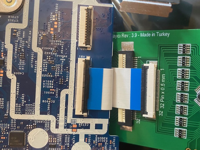

                      Unlockable using vertyanov but config for LAR-2 is a bit wrong there. left->right works.

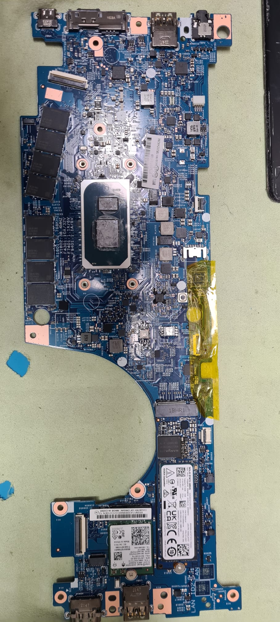

                        Lenovo ThinkPad L13 Gen 2 BIOS Password
                        Good day,
                        Can someone help with the BIOS Password for this Lenovo L13
                        Attached is the BIOS BIN
                        Last edited by justice171; 04-13-2023, 05:50 AM. Reason: To write full model number of laptop
                          • 20888
                          Re: Lenovo ThinkPad L13 Gen 2 BIOS Password
                          Originally posted by justice171
                          Good day,
                          It can`t be patched,read the whole thread. It can only be unlocked programming the EC chip

                                      Here is clear EC dump, you just need to program your EC chip (nuvoton) with Vertyanov programmer) and after that to fill all information like serial number etc..If you can't fill dmi block by Lenovo maintenance utility, here is adresses of these blocks
                                      Model name located at 0005C000
                                      SN,type and board number located at 00058000

                                        Re: Thinkpad L13 Gen 2 Password
                                        hi is there any chance you can post the keyboard this as i am trying also to read with verytanov lenovo l13 10th gen, and is not working i am testing lar-1 and lar-2 but it doesn't read
                                        LAR-1 KB_pins=36 LEFT DOWN 05MM FLASH=256 JENK=13 TCK=7 TMS=18 TDI=22 TDO=4 (evserv) CHIP=NPCE288GA0DX
                                        LAR-2 KB_pins=36 LEFT RIGHT 05MM FLASH=384 JENK=7 TCK=13 TMS=11 TDI=14 TDO=17 (evserv) CHIP=NPCE68BPA1DX
                                        i have tried both
                                        chip on the board is nuvoton npce288ga0dx
                                        i have uploaded some pictures i am wondering if pin nr 1 on the board is coming to pin 32 on my connector i have checked with multimeter and yes pin 1 comes to pin 32 on the io programmer does this has anything to do why is not reading
                                        please do you mind having a look at the pictures also
