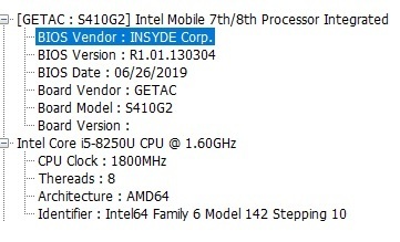

                                #36
                                Need unlocke bios of Getac S410 G2 CPU i5-8250U
                                Serial Number: RJA03S0852
                                BIOS Properties:
                                Vendor INSYDE Corp.
                                Version R1.31.070520
                                Release Date 12/13/2023
                                System BIOS Version 1.31
                                Embedded Controller Firmware Version 1.10
                                Thank you in advance.​

                                  #37
                                  BIOS Properties:
                                  Vendor INSYDE Corp.
                                  post backup bios

                                    #38
                                    Originally posted by shiyab
                                    post backup bios
                                    Good afternoon. No, not after copying. I just want to open the hidden BIOS settings. Can you help me with that?
