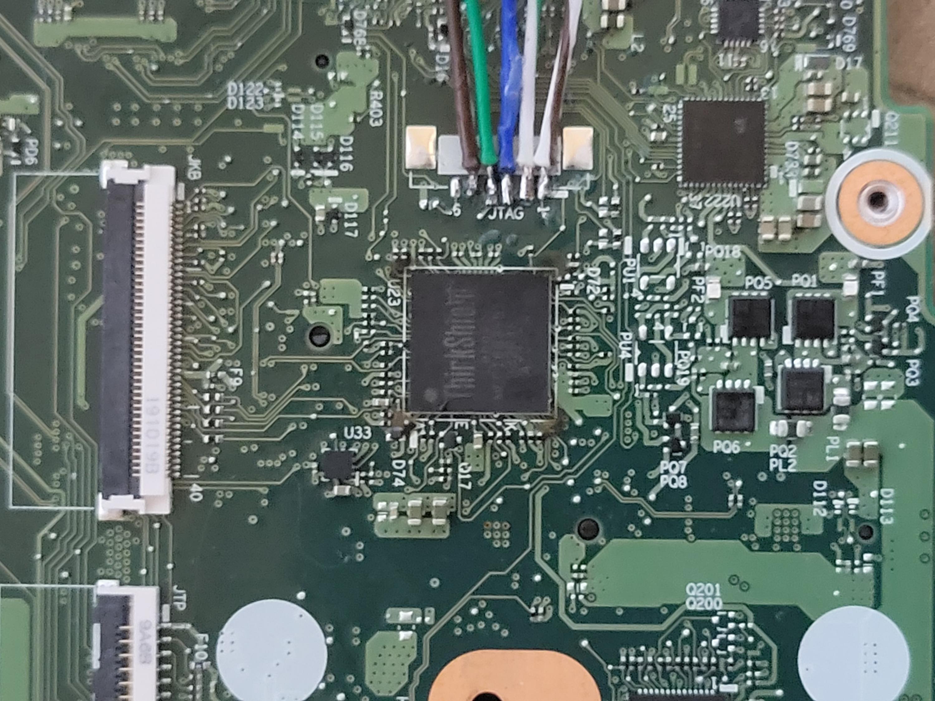

            In schematics R545 shoud be moved on R544 pads. Post a photo with your MEC1663, I don't have boardview for T480s.

              Re: HELP!!! need working EC rom for t480s on mec1663
              Yes, i did this, but there is the sam error. before i just put resistor on r544 place

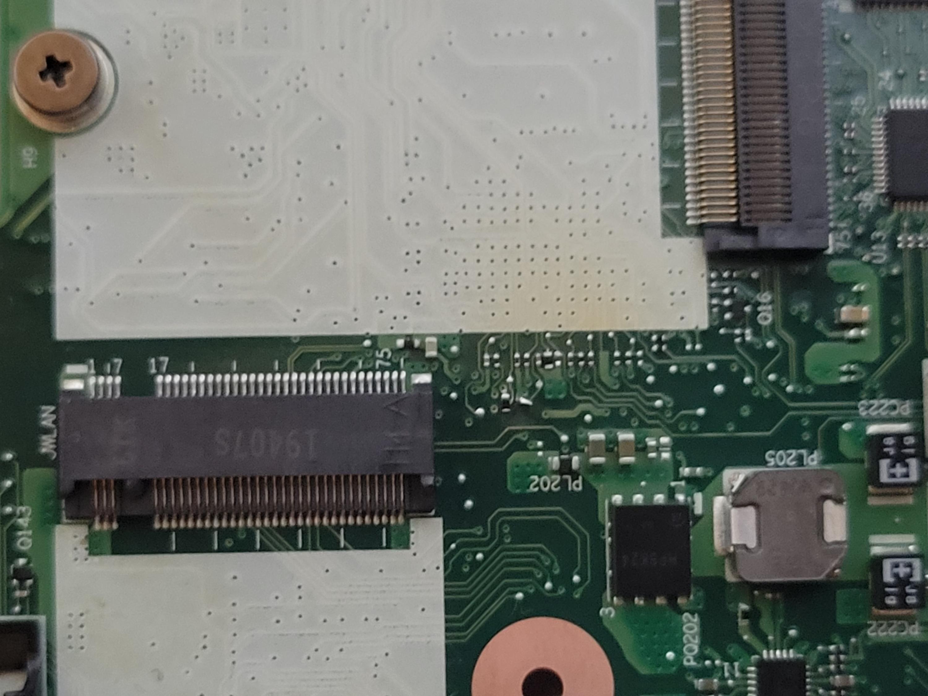

                  Photos from my motherboard
