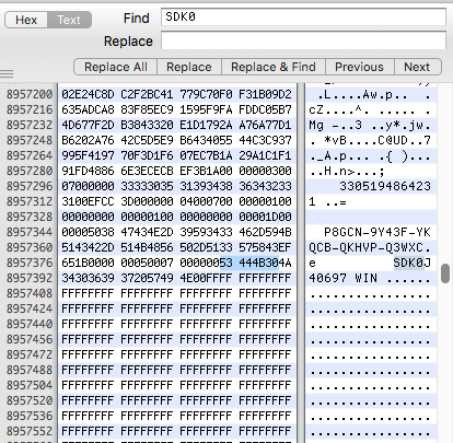

        Also try Secure Boot - Reset to Setup mode. OA3 ID should be in main bios. Search for SDK0 and you'll find it

            T480s - took a bios from this site to verify. is SDK0(zero), you'll find in EVSA Store LnvActivationVar if you open it with UEFI tool.

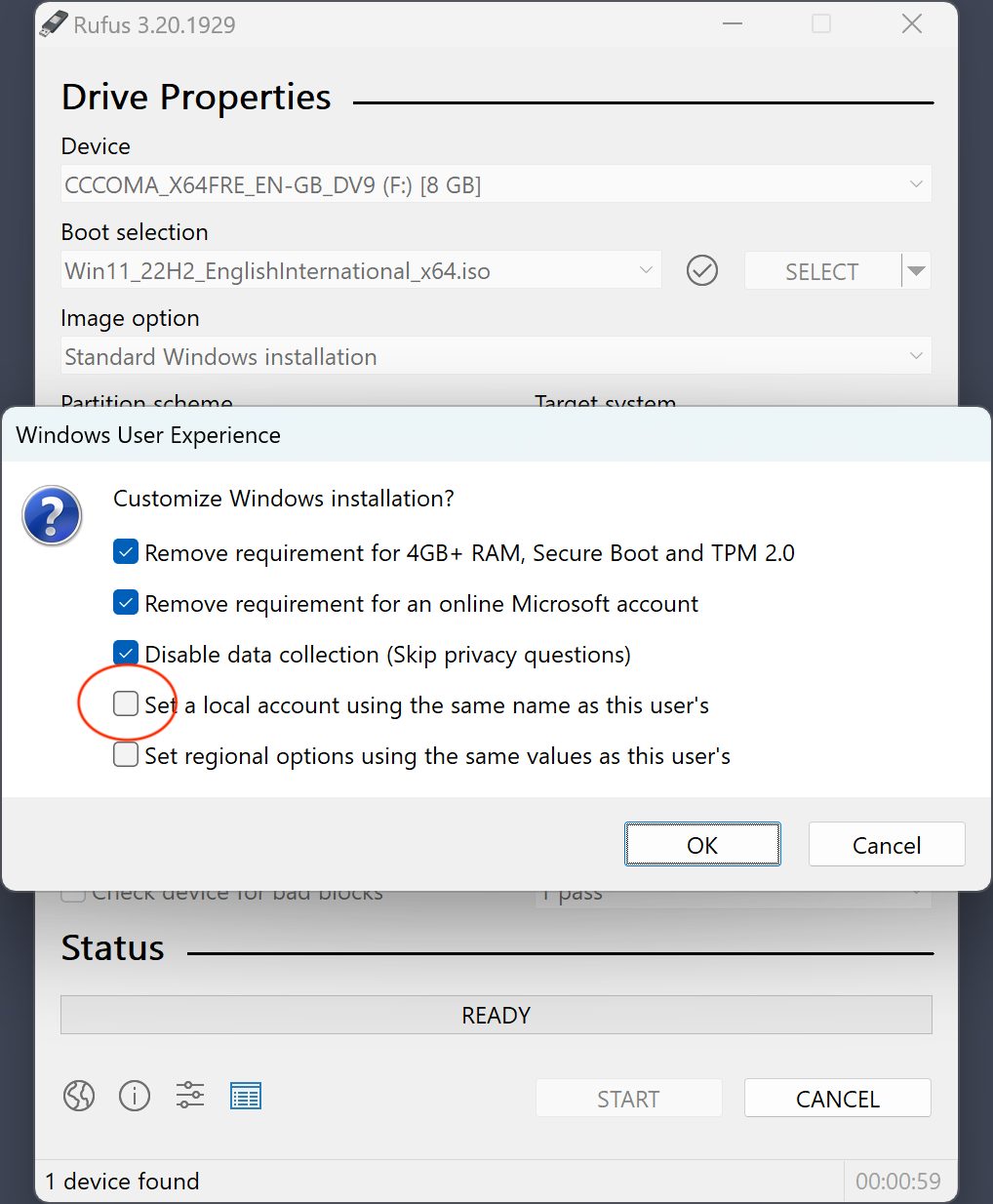

                            other workaround: create USB install disk with rufus last release, check boxes as in pics from site and also check "set a local account ..." Usually you don't have to check this box but recently I installed Win to a Microsoft Surface 7+ and was no way to have option "i don't have internet" to skip connecting with a business or school account. Checking "set a local account ..." even connected to internet I was able to skip the step to sign in with business or school account.
