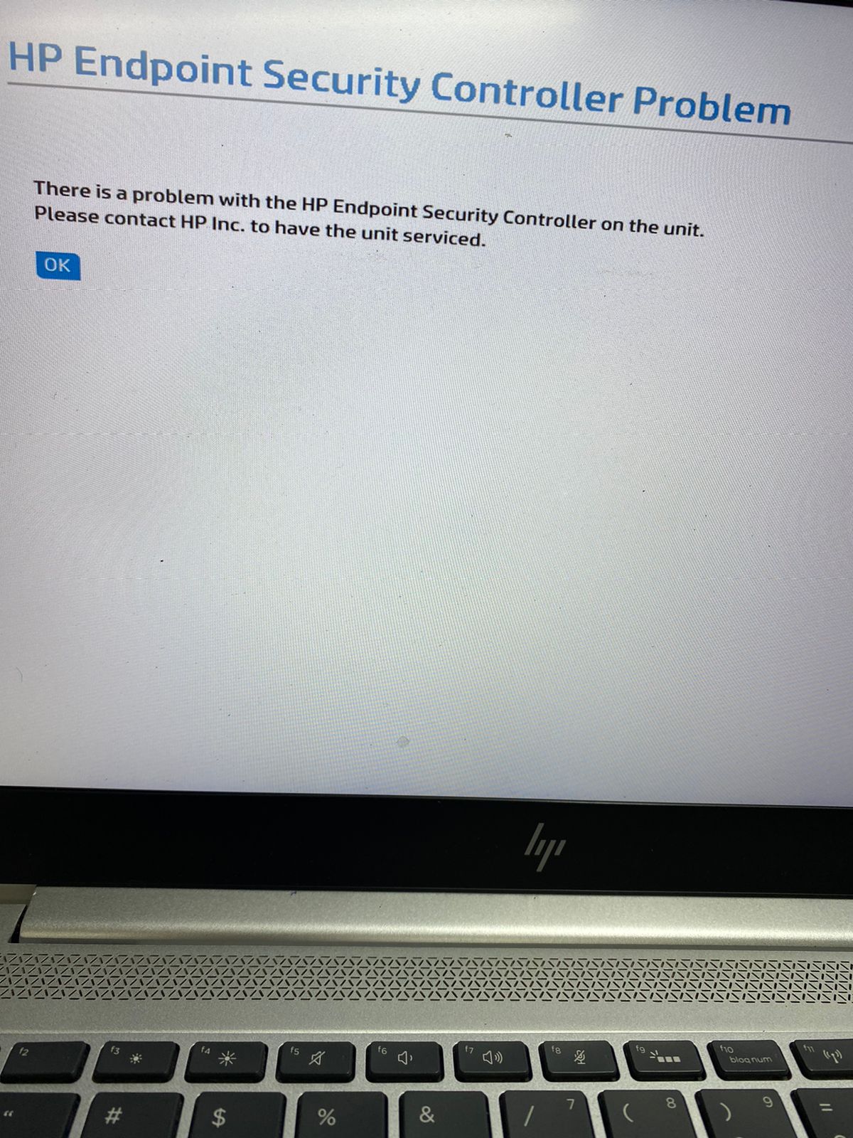

                    PLEASE help,
                    after update no more display.
                    fan spin too loud.
                    remove the power adapter and battery.
                    after plugged in no more fan spin.. just blinking caps

                        it works..but there is red message at the start.
                        edit: manage to figure it out. count downs until it turns to zero
                          • 22274
                          Re: Elitebook 840 G6 no display after bios update
                          The message will go away after about 30 reboots, or lock MPM with HP BCU bios config utility

                            after a day of testing, it happens again.
                            the last message on the screen "corruption of intel ME", then a count down message to restart. after restart it does not turn on anymore.
                            steady caps light.

                              Replaced the bios chip with a new one and tried again, the file I gave cleaned the ME area.
