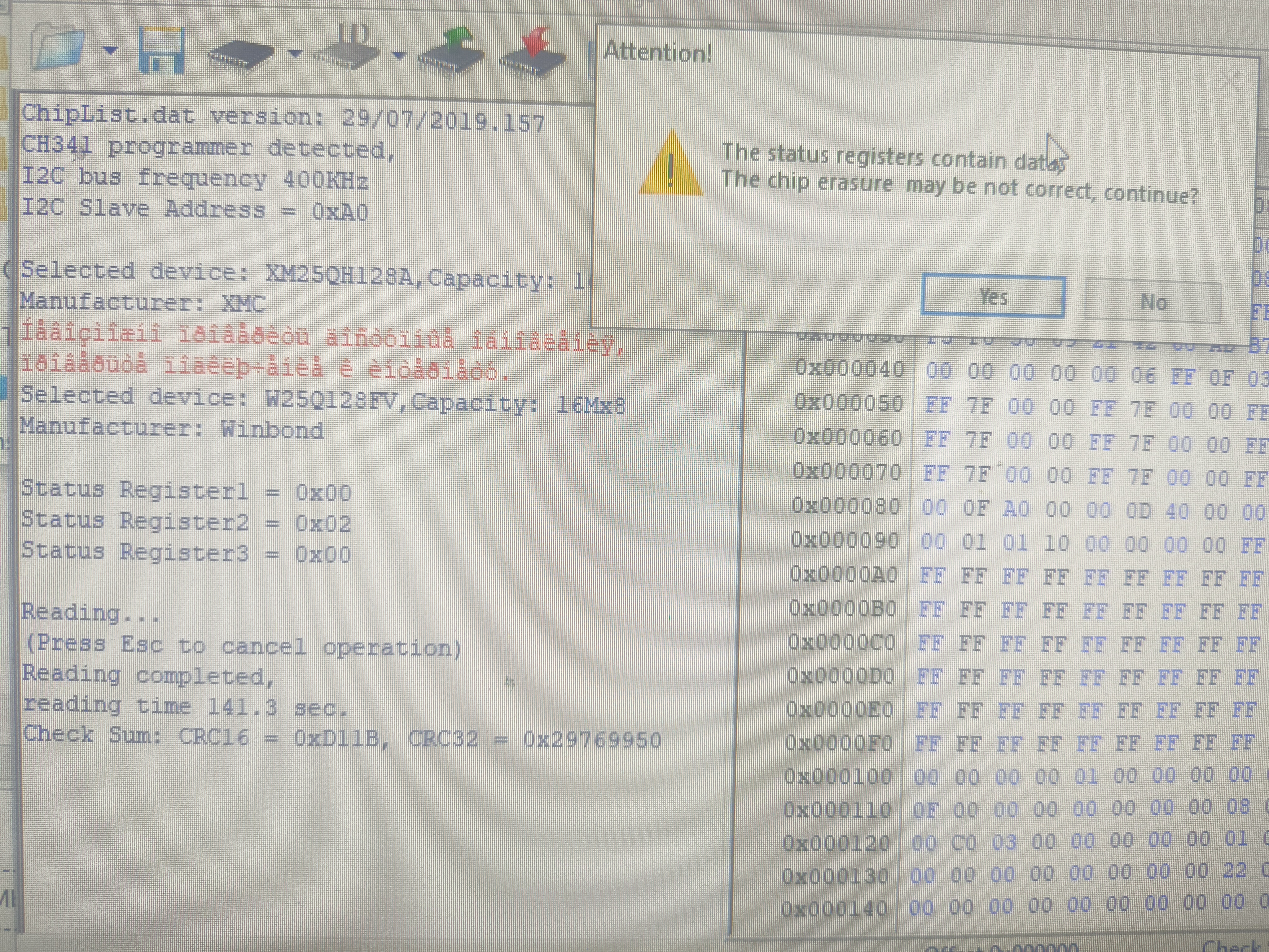

          • Joandean14
            • Jul 2021
            • 23
            • Philiphines
            Originally posted by peste
            try..
            is it okay to erase the status register in this bios ?
            thankyou.

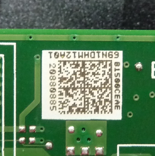

                Scan the QR code on the motherboard and post what it says

                  #29

                  QRCode form MB

                    • 22012
                    #30
                    Originally posted by Slavol
                    QRCode form MB
                    The model on the QR code is B1500CEAE ,that`s what you want. There is an Asus F1 service bios at post 5 ,if you know how to use a hex editor just copy your DMI (serial number etc) from your backup to the new one. These are the offsets 660000 - 66FFFF
                    • Slavol
                      • May 2015
                      • 85
                      • Poland
                      #31
                      You're right, thank you Unfortunately, after flashing the correct BIOS, it turned out I had a damaged processor
