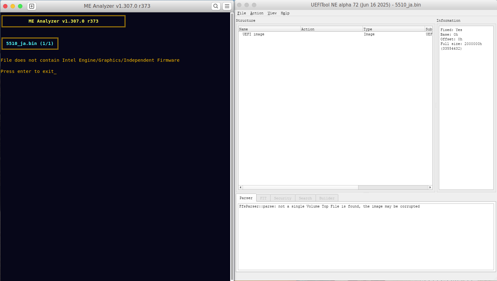

          #64
          hello brothers
          i kind of need help
          dell latitude 5510, ST; D6JC7C3
          It power on, power switch light on and keyboard light on, in 5 second off.
          thank you all

              #66
              Originally posted by kamkooltech
              hello brothers
              i kind of need help
              thank you all
              FfsParser::parse: not a single Volume Top File is found, the image may be corrupted

                #67
                Originally posted by hoaca388
                Wrong chip or backup fault.
                This is serious case, that is the file i extracted from the chip and the chip is MXC
                Maybe my programmer was not clip properly before reading, now i have erase and installed try software still not power now.
                right now i'm sicking for try outimage bin, just offer me any one you have

                  #68
                  thank you bro, i really appreciate your effort
