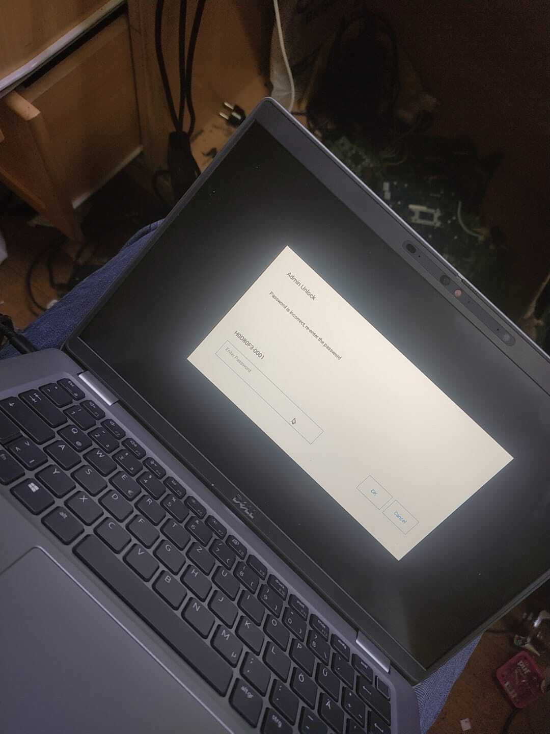

                Dell Latitude 5420 Bios Password 8FC8

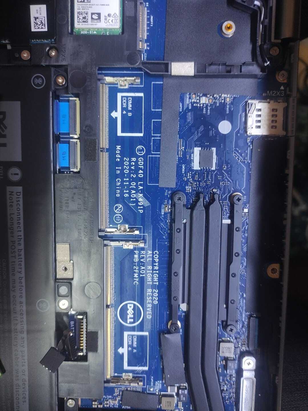

                  Board-Model: GDF40 LA-K491P Rev: 2.0 (A01)
                  Service Tag: #89WF4M3 -8FC8
                  I read 25rh256cxiq with NeoProgrammer and AsProgrammer (CH341A interface) 6 times. I have 3 bin identical. I choose W25Q256JW, MX25L25673G and W25Q256FV, because i dont find my bios - 25rh256cxiq. I think is ok.
                  Thanks.
                  P.S.: i think the last file is ok. (locked.bin)

                          Laptop alive.With CH341A programmer+wson8 6x8+NeoProgramer. But wson must be fixed to read/write. The process takes approx. 4:20 min for reading and approx. 8 min for erasing, writing and checking.
                          Thanks for help.
