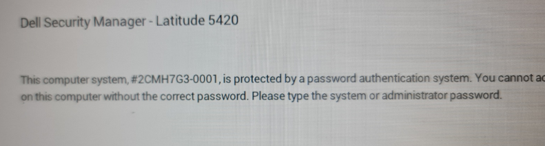

                        Dell Latitude 5420 Bios Password ST suffix 0001
                        Hello all
                        First of all, I am sorry if I could have posted on another thread, but I searched the whole forums and I didn't saw any other thread with this model suffix 0001.

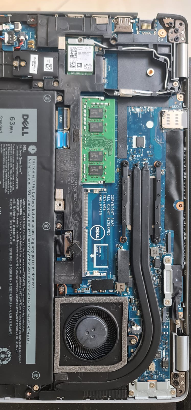

                        As per title I have this DELL Latitude 5420 with Service Tag #2CMH7G3-0001 with password. Wanted to remove it but I really don't know if any of these chips should I read or another on the back side of the Motherboard.
                        These 2 possible chips are to be seen as soon as back cover is removed.

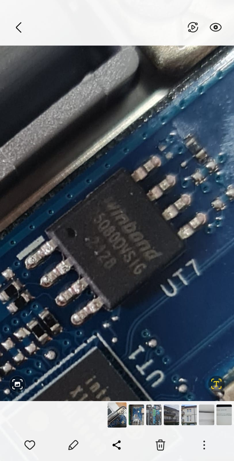

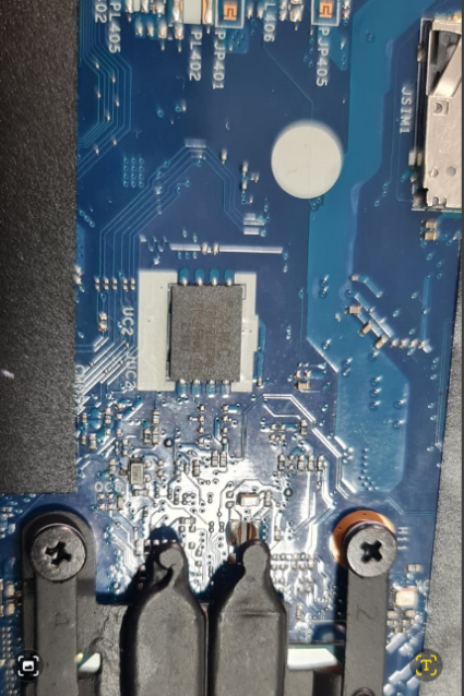

                          Re: Dell Latitude 5420 Bios Password ST suffix 0001
                          Originally posted by ordinateur
                          Hello all
                          Dump the chip (as far as I recall must be 25RH256CXIQ) above the DIMM slot, next to the processor labeled as UC2.

                            #393
                            Re: Dell Latitude 5420 Bios Password 8FC8
                            Here it is, thanks very much
                            It is 32MB in size and I desoldered and inserted directly into RT809H to read the dump

                              #394
                              Be careful with the programming - use verification, erase the chip before flashing the unlocked dump.
                              At first boot press F2, write service tag, disable Absolute, save (apply changes) and restart. At the second boot press Alt+F to exit manufacturing mode. Laptop will restart several times, be patient.
