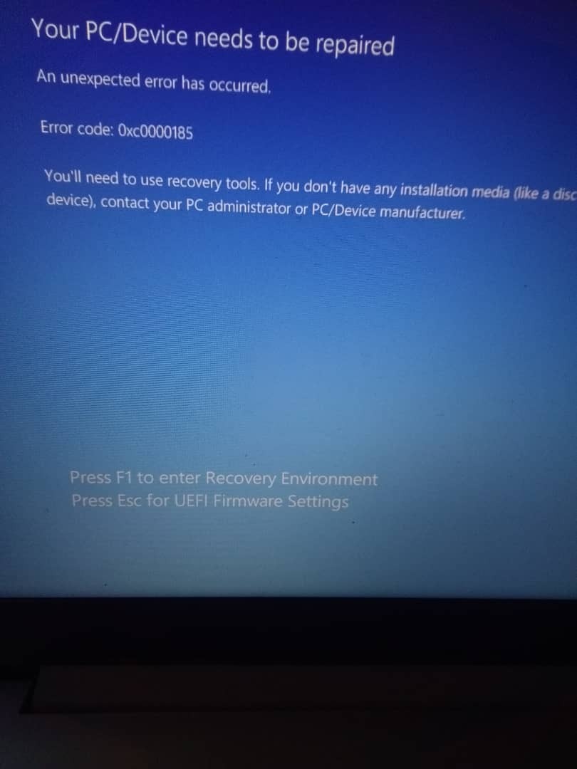

                      Lenovo IdeaPad 3 15IML05 81WB GS452 GS552 GS752 NM-C781 Rev 1.0 Ram Disable
                      i remove ram ic i send u my backup please disble ram by editing my backup bois.

                        #154
                        i flash bois from here
                        https://www.badcaps.net/forum/troubl...-nm-c781/page2
                        missing boot missing ssd
                          • 20674
                          #155
                          You are making problems for yourself. The bios you posted is the original one, i checked the serial "PF2GB3SP" ,why mess with another bios ? did you even check if its the right version,is the ME firmware clean, did you copy the DMI from your backup ? .Just use the RAM patcher on your original bios and try it
                          • mmaewbsoft
                            • Apr 2018
                            • 61
                            • yemen
                            #156
                            i dont copy any thing i dont copy dmi i dont know ram pacher
                          • mmaewbsoft
                            • Apr 2018
                            • 61
                            • yemen
                            #157
                            if you can copy my serail number and editing my backup by disable ram
                            • mmaewbsoft
                              • Apr 2018
                              • 61
                              • yemen
                              #158
                              can you add my dim and sn tot this bin file
                              Serial Number
                              PF2GB3SP
                              Machine Type Model
                              81WB00R4AX​
                              this bin file working and display but missing boot after restart missing ssd
                              i remove ic internal ram i cant editing bois
                                • 20674
                                #159
                                try
                                • mmaewbsoft
                                  • Apr 2018
                                  • 61
                                  • yemen
                                  #160
                                  very thanks to you you make impossible the file working good hdd ssd booting thank you very much i love you man also some keyboard button working because they are non working
                                  thank you thank you very very much i love this sites
