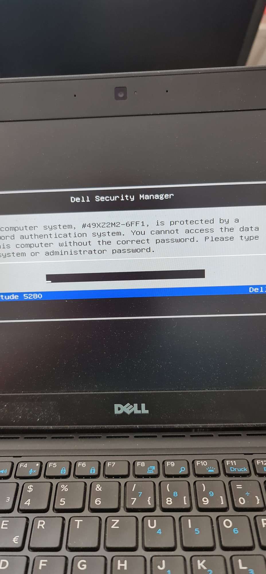

    Hello great people from the most respectable forums in the world.
    Bought this laptop in defective state with BIOS password active, and after fixing some problems it had in the board wanted to ask help for removal of the password if somebody can help me ?
    I have read the BIOS chip W25Q128BV@WSON8 which is 16 MB in size, I hope this is the corect chip that I should read, and attached here that BIOS backup also a picture of what the laptop asks on screen.
    Thanks very much

    Re: Dell Latitude 5280 BIOS unlock?
    Change 49XZ2M2-6FF1 to 49XZ2M2-BF97
    https://beta.bios-pw.org/
      Thanks bro, it worked by original site just by exchanging the letter 'Z' on keyboard
      So the password was CpZ30ZW6Ltt2L085 but after trying also your suggestion and saw that it is not working then I did exchange the letter Z and it worked.
      I thought this Service tag can not be done via Calculation
      Thanks very much
        Must use Qwerty keyboard, US layout to enter password.

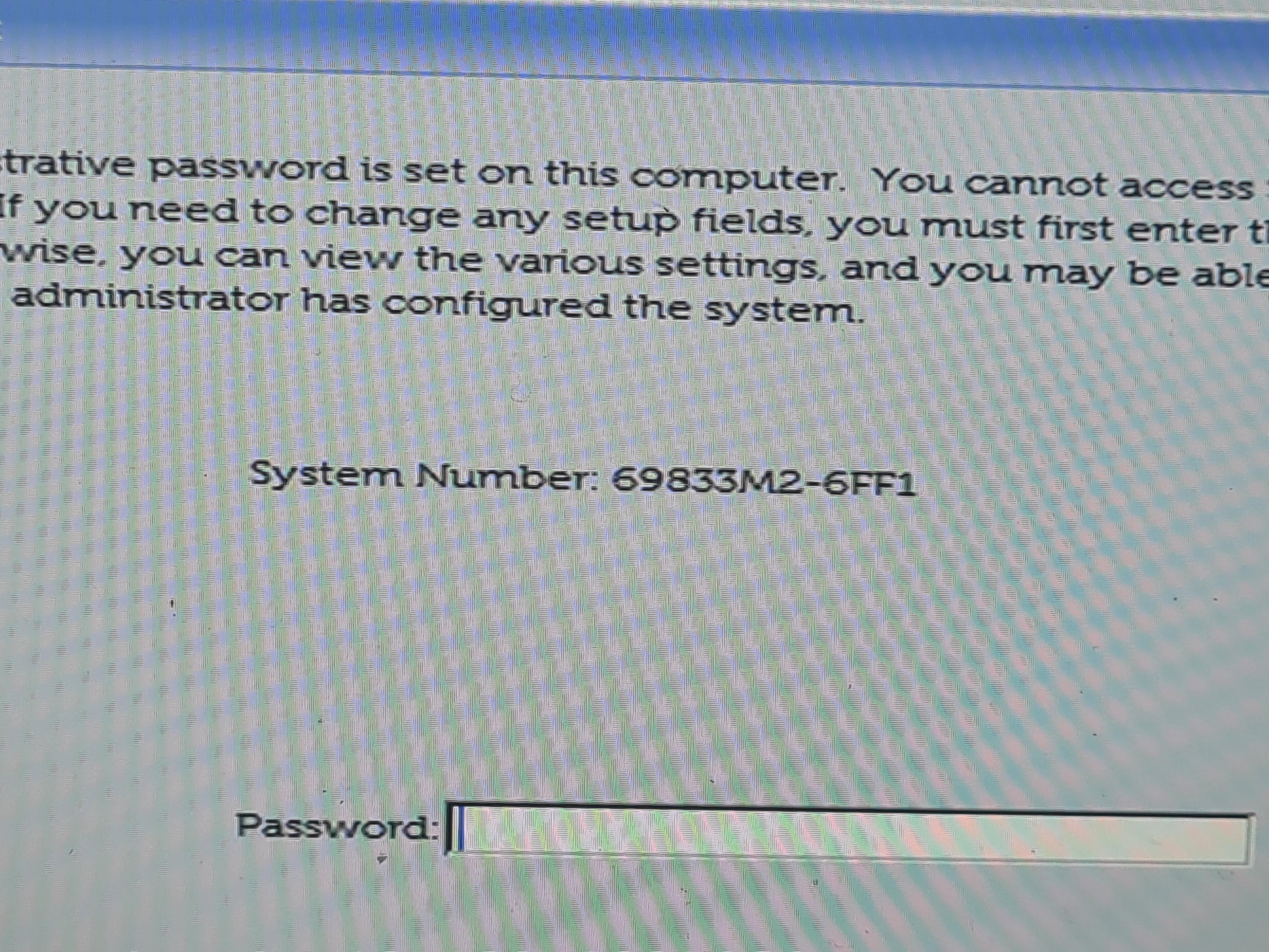

          Dell latitude 5280 bios lock
          Can someone help me with unlocking this one..
          I used the pw generator on https://beta.bios-pw.org
          But cant unlock it..
          Ive added the picture cane someone do it for me please...
          Thank youuuuuuu

            According to hoaca388:
            Change 698333M2-6FF1 to 69833M2-BF97

              Re: Dell latitude 5280 bios lock
              The keyboard is qwerty that im using... and i did change it too BF-97....
                    Originally posted by appie1206
                    Ive Uploaded the old file ..
                    Can sombody please unlock it for me?
                    thanks in advance
                    If the BF97 suffix doesn't work, why you don't try with the 6FF1 suffix ?
                                        Working ! Thanks Friend
