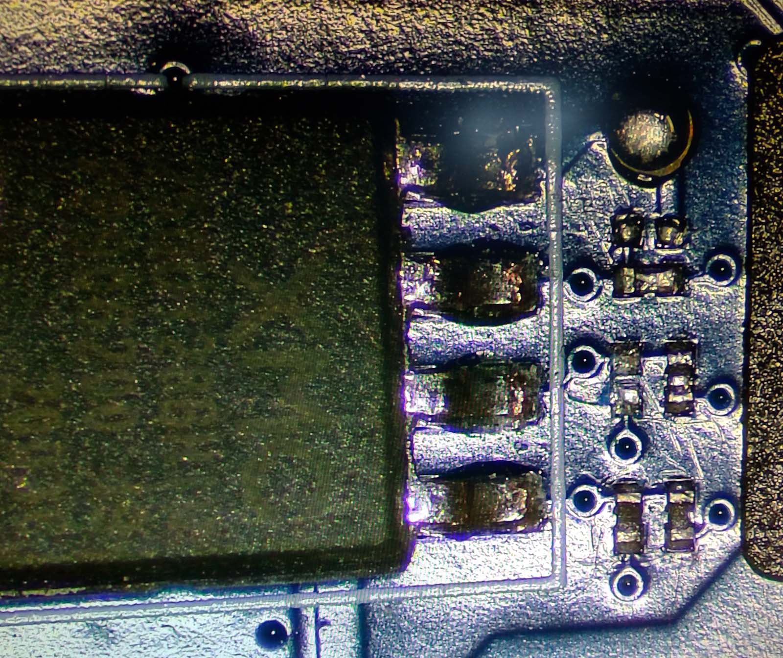

                      Hello, it looks like my own fault. I ripped of a few components, apparently resistores, with tweezers... Im an idiot. This is a relatively new laptop, so I must wait a time for some malfuncted motherboard to solve this problem. I have no schema.
                      I have an old tweezers with a very strong spring, which does not hold in a place... I must buy a new one.

                        Re: ASUS Zenbook 14 UM425IA BIOS dump
                        Detail.
                        Measured the rest "in place" looks like they are zero ohms... But it is not possibly true.
                          Dear hoaca388,
                          Many thanks for your great help.
                          The damage, I made, is fixed now.
                          I have confirmed, that the "ripped of" resistor is a "jumper" with zero resistance.
                          It is replaced by "wire jumper".
                          Your BIOS seems to be the right one.
