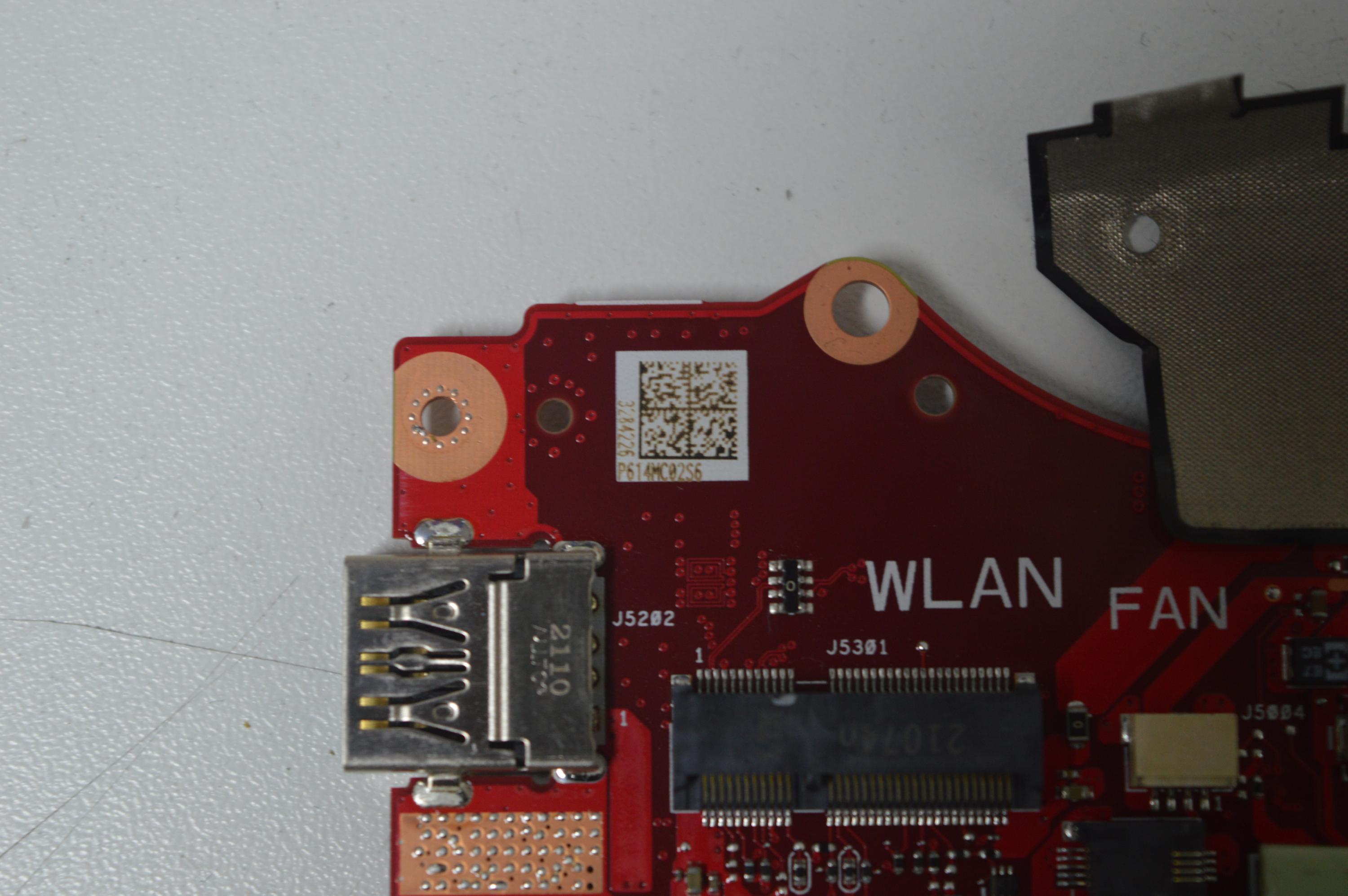

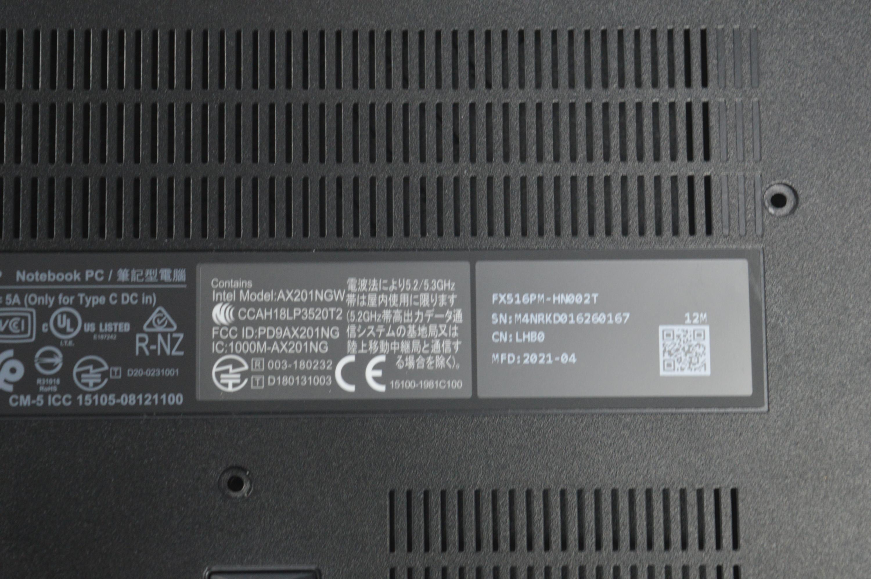

            Hi everyone just another thing after i used the original unlock.rar from the above post my administrator password was removed however now the laptop does not recognise any of my M.2 harddrive slots could this be because i used anothers unlock rar or just a hardware issue? i have attached my original back up if it helps
              • 21169
              Re: Asus Fx516pm-HN013 Need help clearing file password
              maybe. Post the laptop serial number,also pictures of any square white QR codes on the motherboard, there could be one under the SSD or wifi cards, or somewhere else, or if there`s a long white barcode sticker post a pic of that
              • MBAS111
                • Oct 2022
                • 50
                • United Kingdom
                Oh sorry i might have to also point out that i have since updated the bios to the latest version in order to see if that will fix the issue so if you require a new backup???

                                • 21169
                                did that but this file causes laptop to not power up also when i write the bios chip and try to verify i get an error
                                The file posted by @cacla is an Asus service bios and its the right one for your laptop based on the serial number.The verify error is due to the programmer, i guess its a CH341A ? ,and you`re using a clip ?
