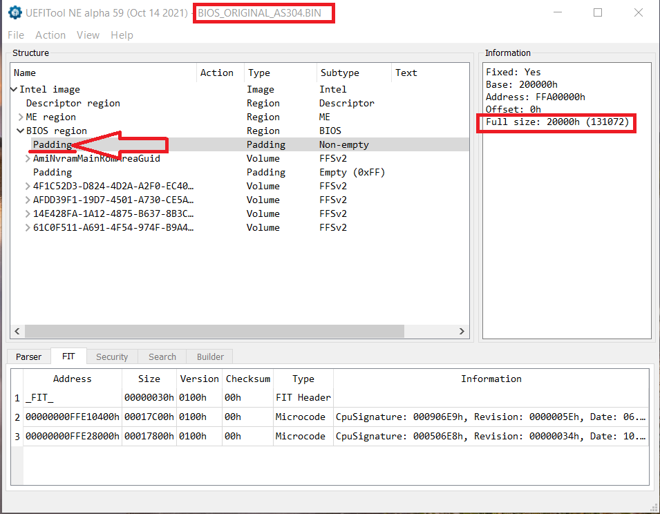

    This motherboard has an ec chip W25Q80DV and a bios chip W25Q64FV.
    I have composed a new bios with the original file and the AS304 version downloaded from the asus website but the laptop still doesn't work.
    Can someone help me with the ec chip?
    I attach the original files and the file composed by me.
    Thanks in advance

    Did you make a mistake? I think its EC file is only 128Kb.

        I apologize for not replying earlier on this topic.
        Finally it was not a bios or ec problem.
        The laptop would do a couple of image reboots and would turn off and not turn back on for a few hours.
        The problem was the battery chip BQ24780S.
        Attachments work, in case anyone needs them.
