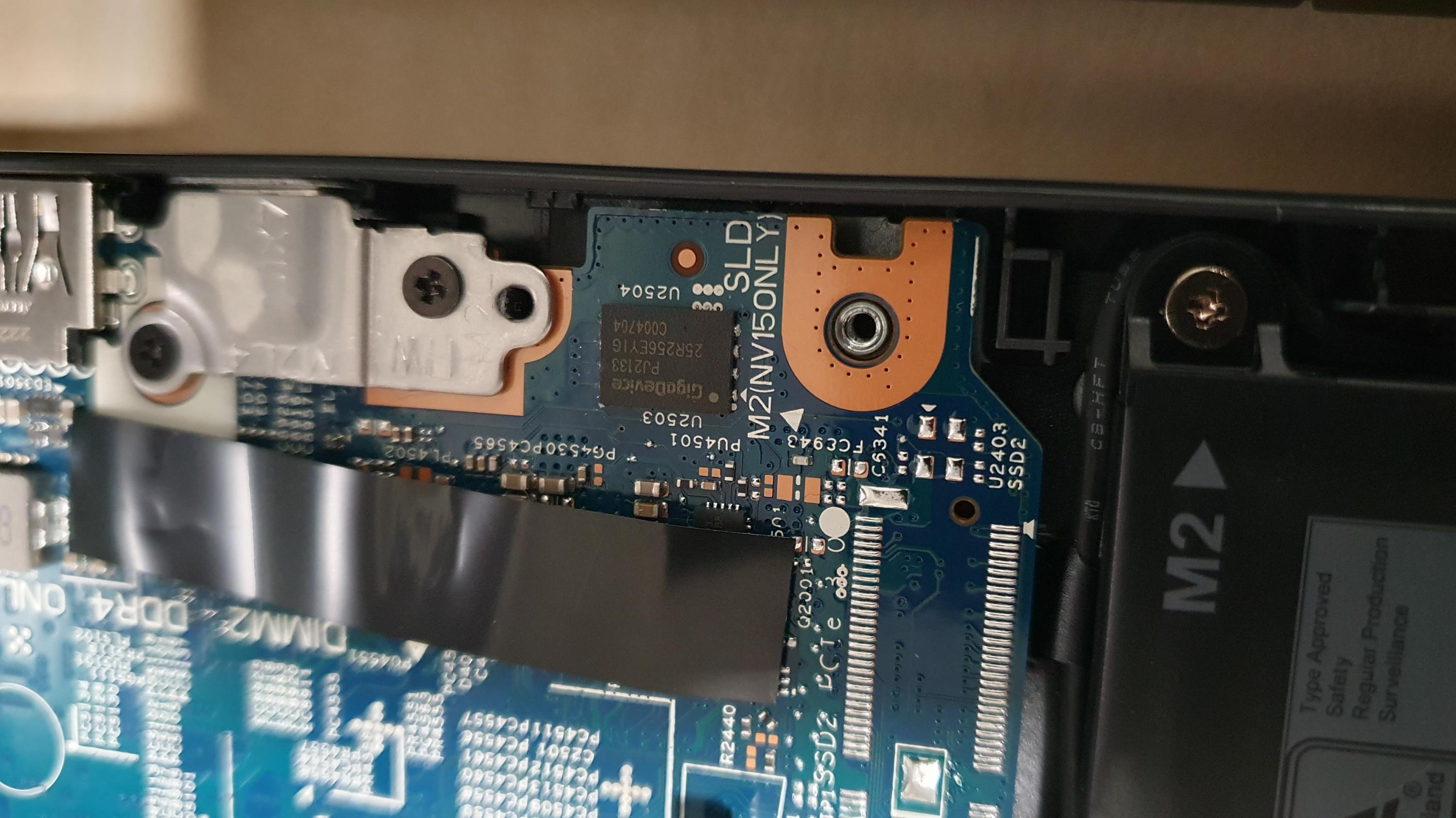

            Re: Dell Latitude 3420 BIOS - Manufacturing Mode Required
            Thanks for looking at this hoaca388.
            I took the bios dump (uploaded yesterday) with my rt809f programmer.
            I since attempted several other dumps of the chip but each time the results are different (in total I have 8 dumps now). The latest version I've attached.
            I then released I was dumping the data using the GD25Q256C@SOP16 settings (within the iFix program). I've since switched to the appropriate WSON8 settings (the dump for this can be seen below).
            I also found on the rear of the motherboard is a smaller GigaDevice 25Q80EWIG chip, which I dumped and have uploaded the image. After several attempts of this dump, each result is exactly the same.
            I've taken a photo of the location on the motherboard which I believe to be the main BIOS chip but it may have another use such as a Thunderbolt controller (this may explain the changing nature of the data within).
            Any help would be great.
              Cheers
              All results are corrupt, the GigaDevice 25R256EYIG chip contains 32MB of data ( this is the bios chip ), when compressing to the rar file should be around 10MB to 12MB, try updating the latest software for your RT809F.
              The GigaDevice 25Q80EWIG chip is not a bios chip, it only contains 1MB of data.
