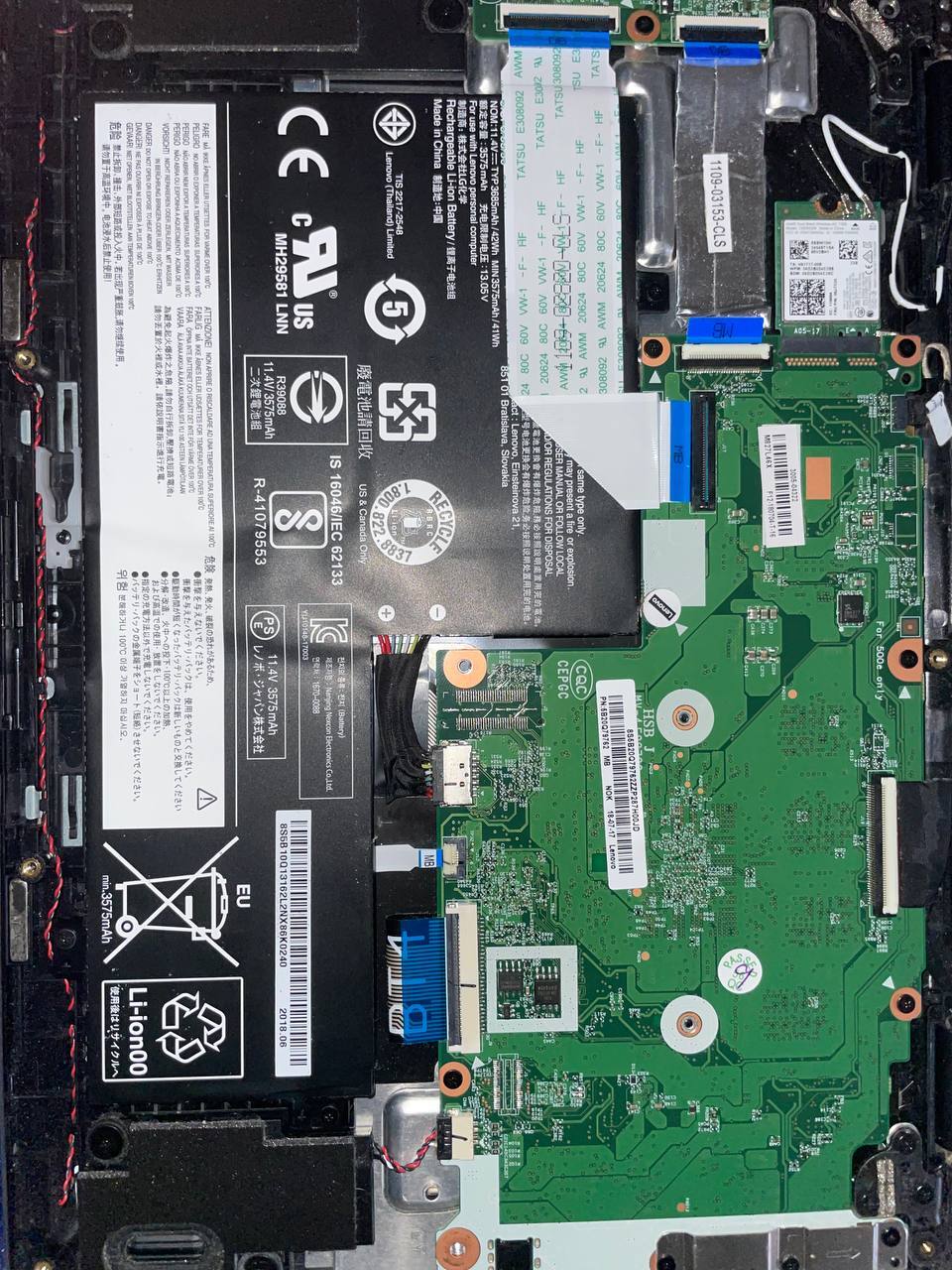

                                      can someone rebuild this bios backup i got no display after bios flashing bios using a clip.
                                      serial_number: PF2WF0GY
                                      model:Lenovo 500e Chromebook 2nd Gen
