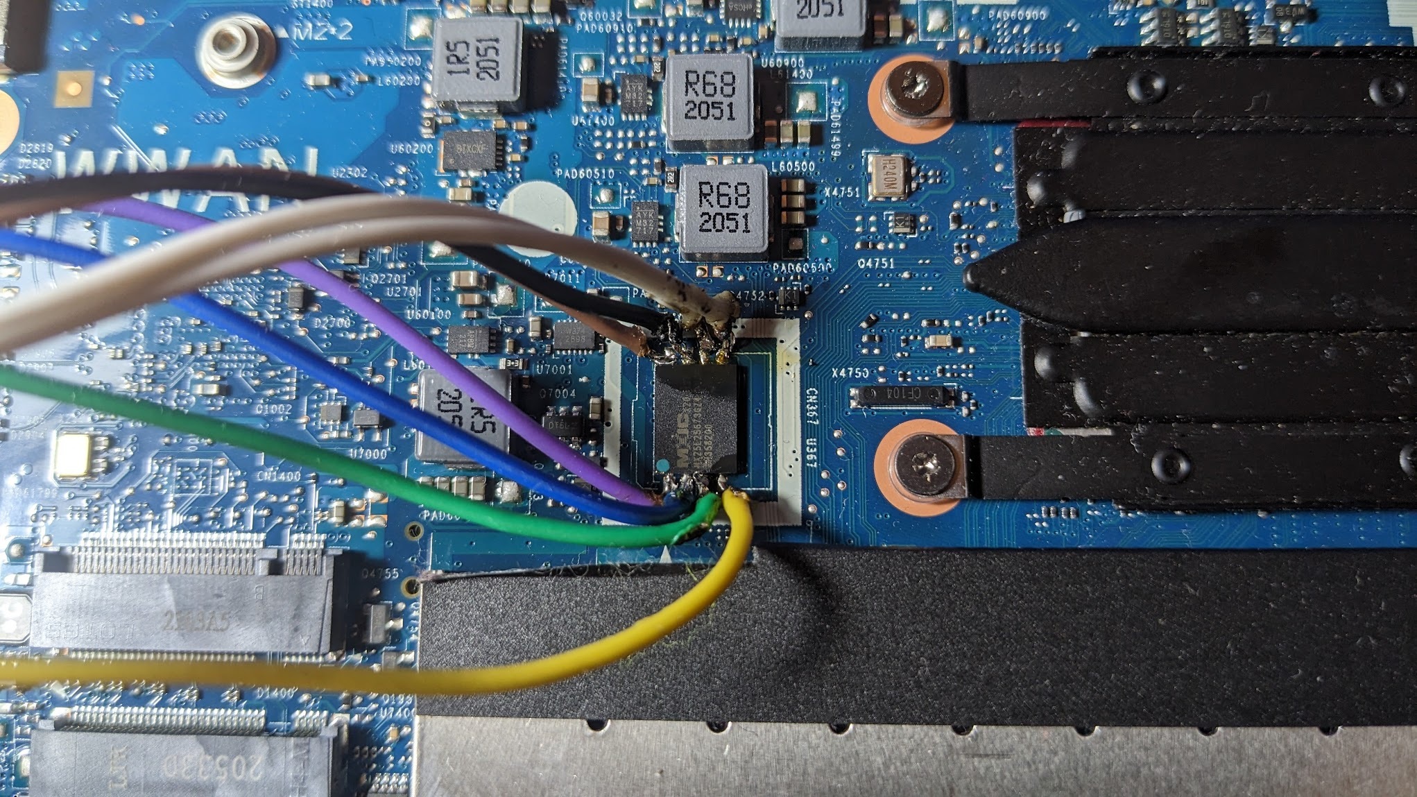

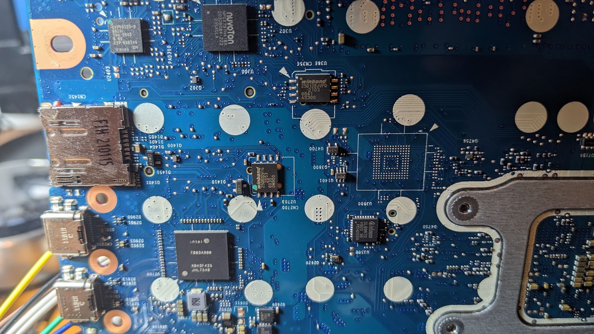

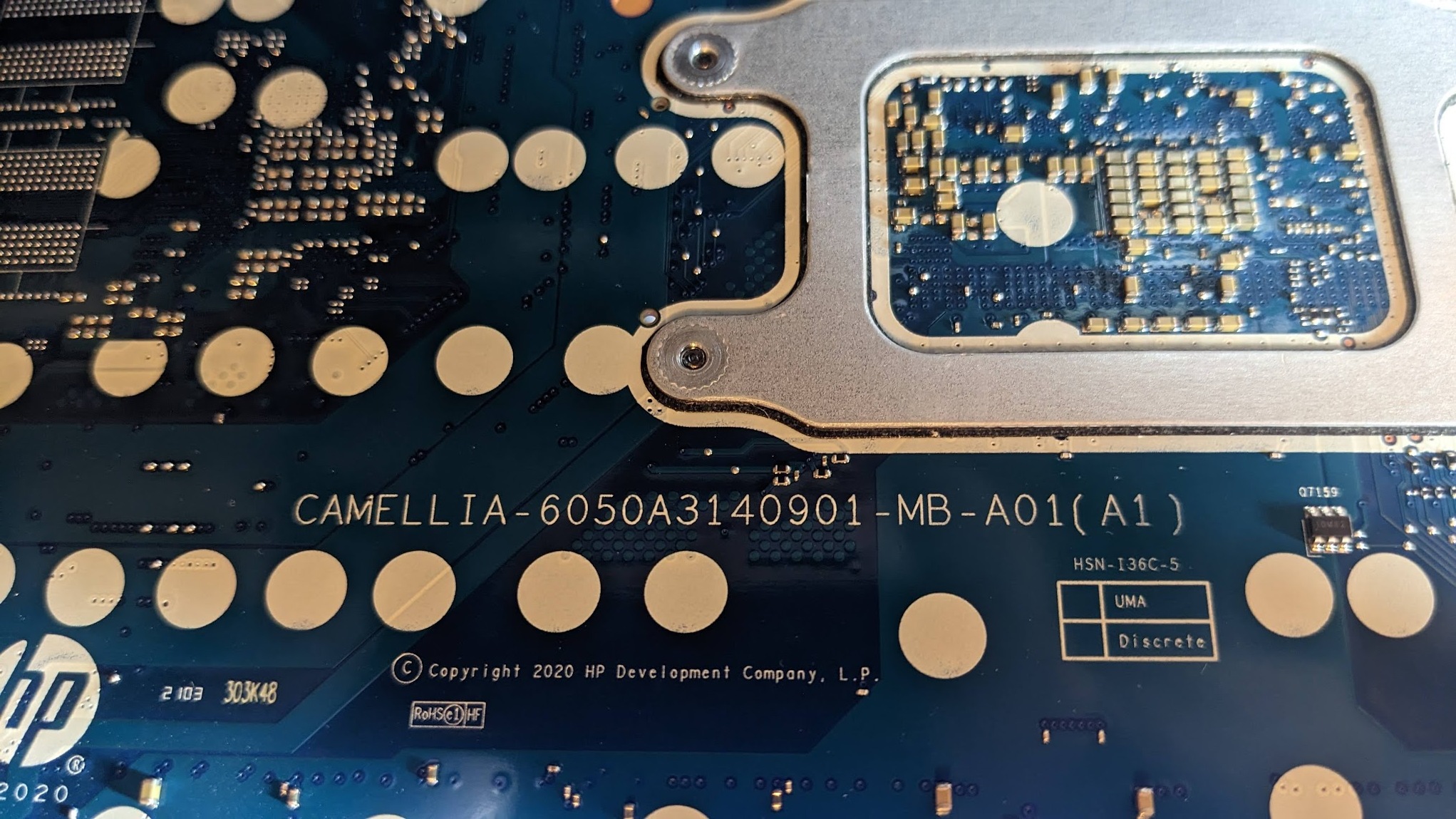

      I have this laptop , motherboard CAMELLIA-6050A3140901-MB-A01(A1) , the motherboard has one flash ic on the side with the cpu and two more on the other side, i have read the one on the first side and tryed rcunlocker on it but after flash i still have the password on. Wich one of those 3 flash memoryes should i read?
    • alfredposadas09
      • Aug 2020
      • 342
      • Philippines
      #44
      get the main bios which is 32mb size

            #47
            Ok , so the saved file from the first ic (MX25l25673G24) has 32.768Kb and i have used rc unlocker on it and everytime i flash it back the unlocked file i still have the password. The other two IC's are 25Q128JVPQ wich i gues it has 4Mb and 25Q80DVIG of 8Mb. I have uploaded the backup file from the 32Mb IC.
              Use this file with Rc unlocker. It's 16 MB.

                #49
                I have used RC unlocker on this 16Mb file but i still got the password on . I will upload here both the backup and the unlocked file maybe someone can help me.

                  #50
                  UNLOCKED
                  • thesame
                    • Mar 2018
                    • 141
                    • Romania
                    #51
                    It worked thank you, what tool to use in the future or you did it manually?

                      #52
                      hxd
