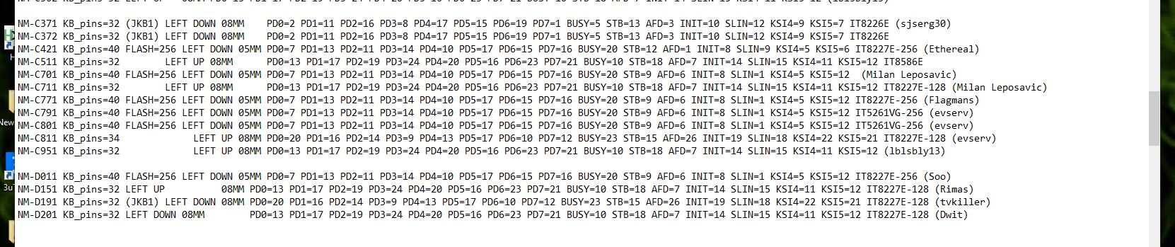

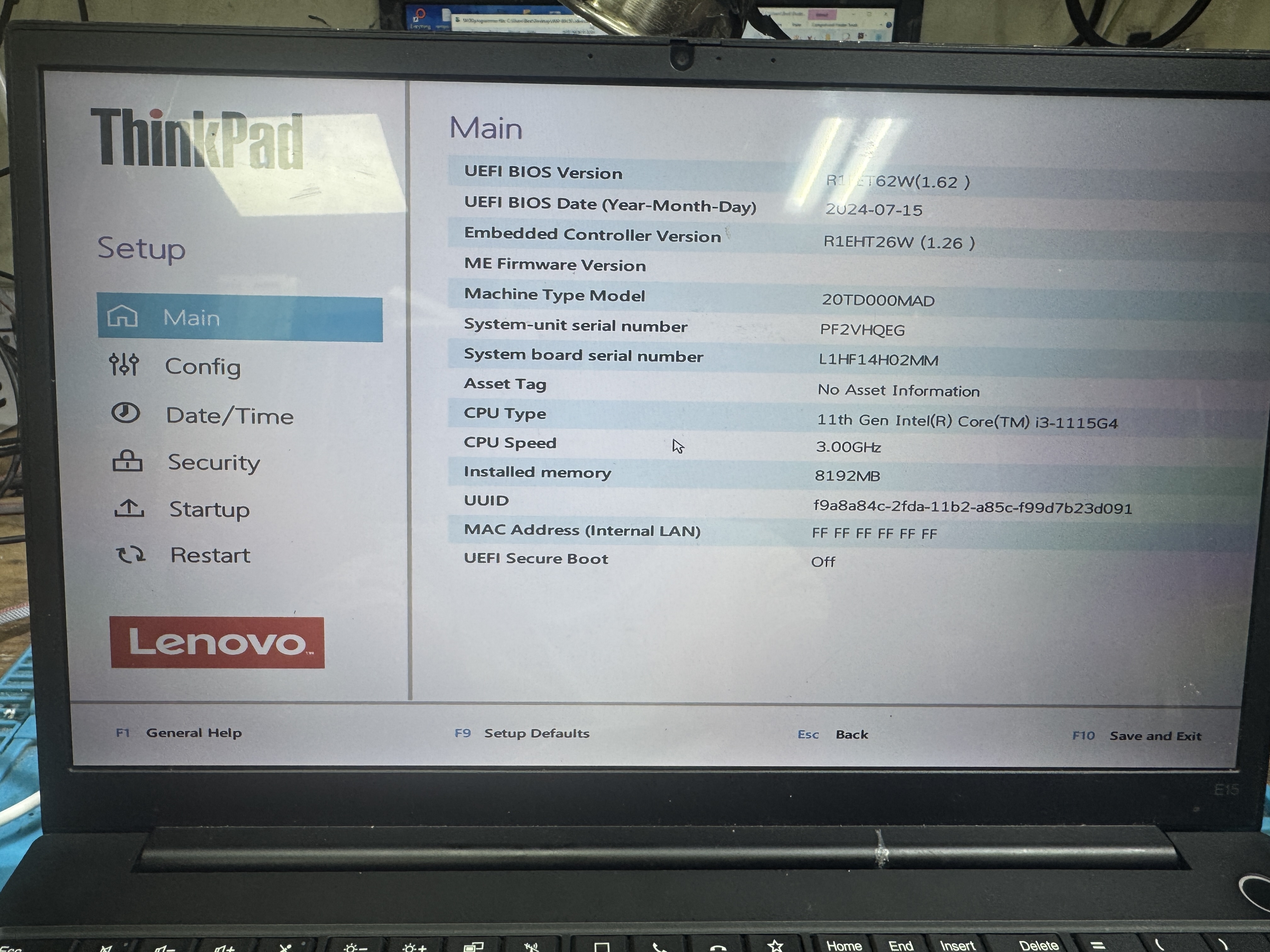

Lenovo E14/E15 Gen 2 Nm-d011
  • SteK
    • Nov 2019
    • 23
    • United Kingdom
    Lenovo E14/E15 Gen 2 Nm-d011
    Could someone please help me remove the password from attached 256Meg bios dump.
    I have tried the autopatch which doesnt work and i have tried reading the EC which is a ITE8227E-256 but can only get it to read 128k.
    Any help would be very much appriciated
    Last edited by SMDFlea; 04-28-2022, 05:31 AM. Reason: Lenovo E15 Gen 2
    • 22209
    Re: Nm-d011
    Originally posted by SteK
    Could someone please help
    Laptop model number ?
    • SteK
      • Nov 2019
      • 23
      • United Kingdom
      Re: Nm-d011
      Lenovo 20TES1G000
      Motherboard GE4B0/GE5B0
      I have managed to read the ITE8227E-256 and attached it
      • lailus
        • Sep 2021
        • 2
        • Espagne
        Re: Lenovo E15 Gen 2 Nm-d011
        i have vertyanov programmer, but cant find the string to read the NM-D011 ... i think even for SVOD it ll work ... someone can attach the file plz ?
        • SteK
          • Nov 2019
          • 23
          • United Kingdom
          Re: Lenovo E15 Gen 2 Nm-d011
          Originally posted by lailus
          i have vertyanov programmer, but cant find the string to read the NM-D011 ... i think even for SVOD it ll work ... someone can attach the file plz ?
          Please see attached picture this is what i have used and it works 100% and reads fully
          • arif3203
            • Feb 2021
            • 58
            • Banyumas
            Re: Lenovo E15 Gen 2 Nm-d011
            Thanks brother
            • sundarkanini
              • Aug 2017
              • 155
              • india
              Re: Lenovo E15 Gen 2 Nm-d011
              Originally posted by arif3203
              Thanks brother
              same bios need i have attached my old file no display and beep sound
              I have tried another file display come but SSD not detect need correct working file
              I don't have serial number its erased please help guys
              • CHERIF
                • Jan 2021
                • 17
                • Mali
                Re: Lenovo E15 Gen 2 Nm-d011
                Hi here you are if necessary
                • slimane25
                  • 4
                  • algeria
                  Re: Lenovo E15 Gen 2 Nm-d011
                  All of the files above have a problem that they do not read SSD NVME
                  This attached file works 100%
                  • anandkv123
                    anandkv123 commented
                    Editing a comment
                    YOU ARE AWESOME BRO WORKING PERFECT
                • by_mex
                  • Feb 2014
                  • 57
                  • turkey
                  Re: Lenovo E15 Gen 2 Nm-d011
                  Originally posted by slimane25
                  All of the files above have a problem that they do not read SSD NVME
                  This attached file works 100%
                  tested working thanks
                  • jacobk1508
                    • May 2016
                    • 69
                    • Viet Nam
                    Re: Lenovo E15 Gen 2 Nm-d011
                    Hello. My bios file doesn't show the screen, just the beep sound. Can someone help me fix it. Here is my original bios file
                    NM-D011 SN: PF-3NJ398
                    • hardware1
                      • Sep 2021
                      • 2949
                      • N/A
                      Re: Lenovo E15 Gen 2 Nm-d011
                      Originally posted by jacobk1508
                      Hello. My bios file doesn't show the screen, just the beep sound. Can someone help me fix it. Here is my original bios file
                      NM-D011 SN: PF-3NJ398
                      This is a Working BIOS, try it.
                      all donations are welcome,
                      • Sebas3124
                        • Mar 2014
                        • 15
                        • Colombia
                        Re: Lenovo E15 Gen 2 Nm-d011
                        Originally posted by slimane25
                        All of the files above have a problem that they do not read SSD NVME
                        This attached file works 100%
                        ok
                        • niggi
                          • May 2016
                          • 210
                          • UAE
                          Originally posted by slimane25
                          Re: Lenovo E15 Gen 2 Nm-d011
                          All of the files above have a problem that they do not read SSD NVME
                          This attached file works 100%
                          working file 100% ok
                          • crowntoy99
                            • Oct 2012
                            • 267
                            • india
                            sn PF2VHQEG
                            E15 Gen 2 (Type 20TD, 20TE) Laptop (ThinkPad) - Type 20TD
                            SSD NVME not read plz fix
                            • hoaca388
                              Badcaps
                              • Jan 2022
                              • 12426
                              Originally posted by crowntoy99
                              sn PF2VHQEG
                              E15 Gen 2 (Type 20TD, 20TE) Laptop (ThinkPad) - Type 20TD
                              SSD NVME not read plz fix
                              E15 Gen 2 Laptop (ThinkPad) - Type 20TD
                              • crowntoy99
                                • Oct 2012
                                • 267
                                • india
                                Originally posted by hoaca388
                                E15 Gen 2 Laptop (ThinkPad) - Type 20TD
                                thanks bro its not power on
                                • hoaca388
                                  Badcaps
                                  • Jan 2022
                                  • 12426
                                  Originally posted by crowntoy99
                                  thanks bro its not power on
                                  Flash the original file again to see if it powers on..
                                  • crowntoy99
                                    • Oct 2012
                                    • 267
                                    • india
                                    Originally posted by hoaca388
                                    Flash the original file again to see if it powers on..
                                    Old file working
                                    • hoaca388
                                      Badcaps
                                      • Jan 2022
                                      • 12426
                                      Originally posted by crowntoy99
                                      Old file working
                                      Now , flash file at # 16.
                                      • coasterghost
                                        Lenovo T14 Gen 2 Type 20XK Model 20XK0069US Odd Charging Issues
                                        by coasterghost
                                        For Badcaps Readers, Please note that I am hopefully going to present this same message to Lenovo to see if they have any insight to the matter as well and figured to share the entirety here for clarification. The System is out of warranty as it is but does have the option to have it extended.
                                        Model Information: T14 Gen 2 (Type 20XK, 20XL) Laptop (ThinkPad) - Type 20XK - Model 20XK0069US
                                        Board: T14 Gen 2 (Type 20XK, 20XL) - Type 20XK.
                                        System Hardware:
                                        Processor: AMD Ryzen 7 PRO 5850U
                                        Memory: 1x 16GB DDR4 3200 (Soldered on Board); 1x Crucial 32GB DDR4...
                                        09-08-2025, 10:46 PM
                                        Lenovo 3000 Series Schematic
                                        Lenovo 3000 Series Schematic
                                        Lenovo 3000 was a line of low-priced notebook and desktop computers designed by Lenovo Group targeting small businesses and individuals. It was replaced with the IdeaCentre and IdeaPad brands.
                                        3000 C100 laptop with Braille keyboard
                                        Lenovo 3000 C
                                        C100, C200 - 15-inch XGA screen
                                        Lenovo 3000 N
                                        N100, N200 - 14.1-inch- and 15.4-inch- WXGA models
                                        N500 - 15.4 inch screen.
                                        Lenovo 3000 V
                                        V100, V200 - 12.1-inch WXGA models
                                        Lenovo 3000 G
                                        G400, G410, G430, G450, G455, G510, G530, G550, and G560...
                                        10-04-2024, 06:05 AM
                                        Lenovo IdeaPad 120S Notebook 100 Specification for Upgrade or Repair
                                        This specification for the Lenovo IdeaPad 120S Notebook can be useful for upgrading or repairing a laptop that is not working. As a community we are working through our specifications to add valuable data like the 120S boardview and 120S schematic. Our users have donated over 1 million documents which are being added to the site. This page will be updated soon with additional information. Alternatively you can request additional help from our users directly on the relevant badcaps forum. Please note that we offer no warranties that any specification, datasheet, or download for Lenovo IdeaPad 120S...
                                        09-06-2024, 06:40 AM
                                        09-06-2024, 06:06 AM
                                      • derradji89
                                        Need help Lenovo MIX 320-10lCR domaine name SERCOL
                                        by derradji89
                                        Hi everyone 🤗
                                        I have a Lenovo MIX 320-10lCR computer.**
                                        1. **Operating System**: Windows 10 ** Education** 64-bit.
                                        2. **User Account Restrictions**: The account I'm using has heavily restricted permissions via **UAC** and **Group Policy**. This means I cannot install any software without admin rights, adjust system time, run Command Prompt as administrator, or modify the registry via Regedit—all are blocked.
                                        3. **BIOS Password Protection**: The BIOS is locked with a password, preventing me from installing a new operating system.
                                        4. **BIOS Chip Reflashing**: Currently,...
                                        04-19-2025, 03:04 PM
