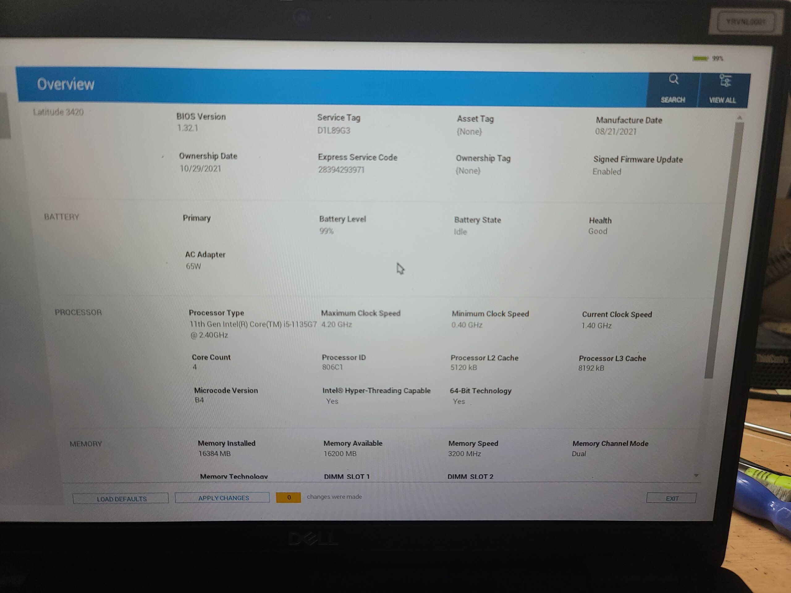

                                #56
                                Please help me!
                                I need a file that can change the model and service tag.
                                This is my original ok file.
                                Cyborg-L14 MB TGL
                                203068-1
                                Service tag D1L89G3​

                                    #58
                                    Originally posted by danito
                                    try
                                    Thanks Danito but it doesn't work for me. The fan rotates quickly. The screen displays test mode: white, green, red...​
