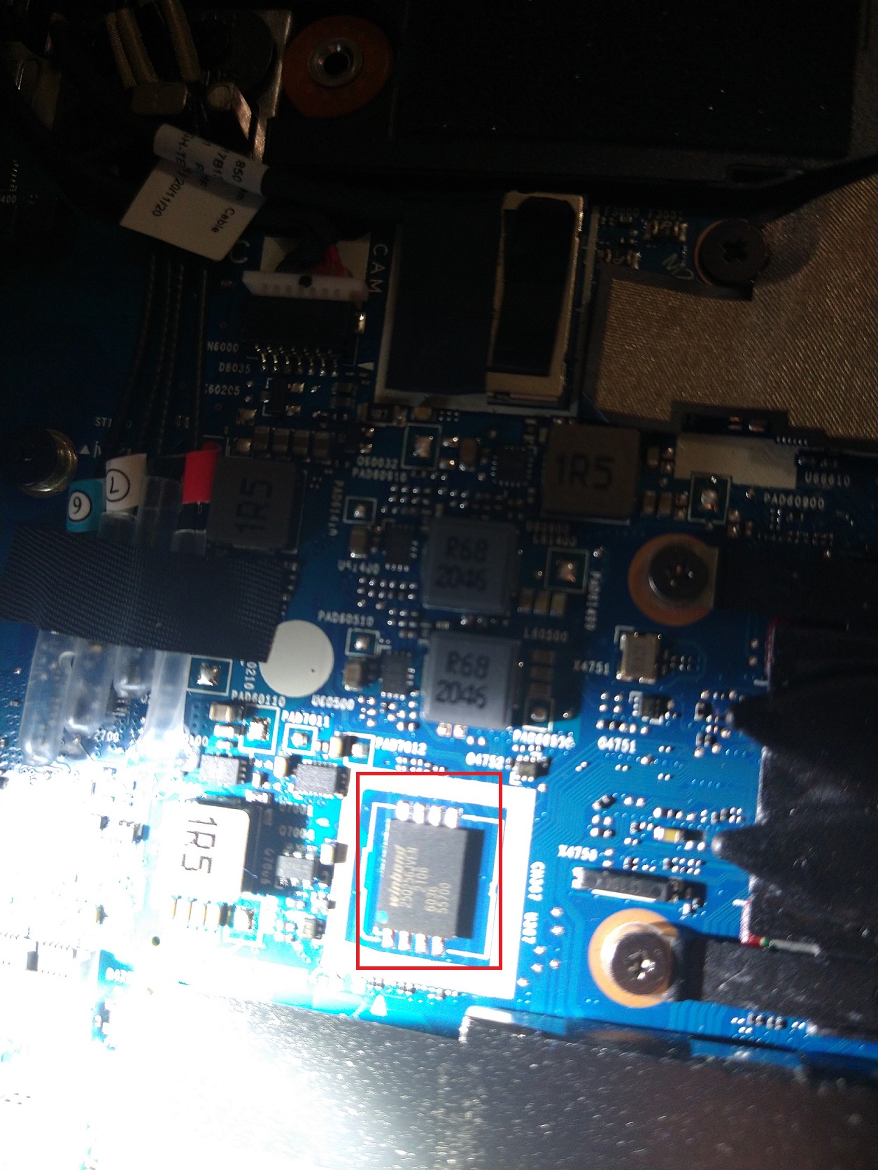

              • no_nope
                • Apr 2025
                • 7
                In case someone else makes it here wondering where the U2703 and U366 are, you have to remove the board and flip it over then look on the side nearest the USB and HDMI ports. Hopefully the pictures help!
                • peste
                  peste commented
                  Editing a comment
                  Don't post pictures unless asked..
              • no_nope
                • Apr 2025
                • 7
                Separately, I have finally gotten my chip read by way of, somewhat ridiculously I know, soldering solder leads onto the chip and mashing those leads into the disassembled clip because the chip would not make physical contact with the clip otherwise! Anyway, I am not sure if the U366 RAR file provided by hoaca388 is 'universal', and if it is, please ignore my request. If it is not, I was hoping someone would be able to help me with the attached Zip file containing the bin from my U366 chip, so I can extract or remove the password. Thanks!
