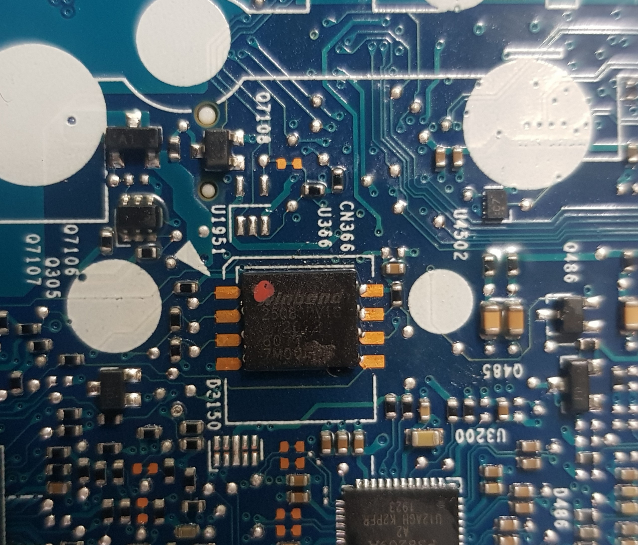

I need BIOS HP Elitebook 745 G5
  • onlylove17
    • Jun 2021
    • 60
    • VN
    i need rom U366 745 G5, please help me
  • onlylove17
    • Jun 2021
    • 60
    • VN
    I need rom U366 HP Elitebook 745 G5
    I need rom U365+U366 HP Elitebook 745 G5
    please help me
    thank for all

    • peste
      • Dec 2016
      • 13199
      • ROMANIA
      Re: I need rom U366 HP Elitebook 745 G5
      please help me
      thank for all
      post the contents of the U365 + U366 chips ....
      • onlylove17
        • Jun 2021
        • 60
        • VN
        i forgot to backup

                      • sellit
                        • Jun 2017
                        • 104
                        • Latvia
                        Re: I need BIOS HP Elitebook 745 G5
                        I have same model too, MB: 6050A2945701-MB-A01(A1)
                        Won't turn on, if CMOS battery is reset, by adding adapter it flashes briefly power button and charging led stays orange even without battery.
                        I think it's BIOS related problem, can you help fix my BIOS, tried different BIOS dump found on WEB, but no luck.
                          • 21465
                          Please read the updated rules,you must post the laptop serial number

                            maybe someone needed this mains. i tested 2 of that and it works. idk about the other.
                            HP EliteBook 745 G5 6050A2945701-MB-A01
                              Sorry about that.
                              Laptop model HP Elitebook 745 G5
                              SN: 5CG908507Q
                              MB: TRYPTICO 6050A2945701-MB-A01(A1)
                              CPU: AMD Ryzen
