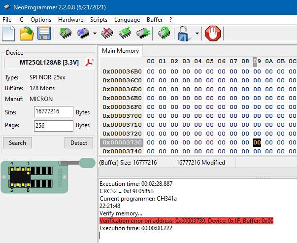

HP BIOS unlock tool
  • angeldust
    • Jan 2023
    • 2
    • EspaƱa
    #1421
    Re: HP BIOS unlock tool
    RCUnlock did the trick! Thank you
    • smallvhin
      • Jul 2015
      • 182
      • philippines
      #1422
      Re: HP BIOS unlock tool
      Master help me to remove password ang asset tracking
      Main & EC bios pls.. more thanks 🙏
      • Arrow16
        • Apr 2022
        • 229
        • Philippines
        #1423
        Re: HP BIOS unlock tool
        Originally posted by smallvhin
        Master help me to remove password ang asset tracking
        Main & EC bios pls.. more thanks 🙏
        Have you try hp unlocker? if not,
        Try this give feedback if ok
        • dellca
          • Feb 2023
          #1424
          Re: HP BIOS unlock tool
          I have a hp 9470m, Supervisor passord lock. I have bought a ch341a. the NeoProgrammer V2.2.0.8 is the only app I found able to detect the chip 25q128a 13EC0. but it shows verify error after reading the chip as in the pic. and it also shows an error message when trying to patch it. Can someone please help? Thank you!
          • peste
            • Dec 2016
            • 12593
            • ROMANIA
            #1425
            Re: HP BIOS unlock tool
            Originally posted by dellca
            I have a hp 9470m, Supervisor passord lock. I have bought a ch341a. the NeoProgrammer V2.2.0.8 is the only app I found able to detect the chip 25q128a 13EC0. but it shows verify error after reading the chip as in the pic. and it also shows an error message when trying to patch it. Can someone please help? Thank you!
            you probably don't have firm contact between the programmer and the bios chip...
            https://www.youtube.com/watch?v=DWWigscuQDY
            • X7JAY7X
              • Dec 2016
              • 6
              #1426
              Re: HP BIOS unlock tool
              Is there any tutorial or documentation on how to unlock the 32mb HP chips?
              • hima202
                • Sep 2014
                • 14
                • eygpt
                #1427
                Re: HP BIOS unlock tool
                thank you great work
                • Pascal Komlassan
                  • Jan 2017
                  • 806
                  • TOGO
                  #1428
                  Re: HP BIOS unlock tool
                  Originally posted by RethoricalCheese
                  You can contact me by writing here, by sending me a personal message or by sending me an email through my profile here (click on my name -> send email).
                  I am working on some more tools, will try to post them aswell when I get them finished.
                  thank you
                  • TheFiddler
                    • Feb 2023
                    • 2
                    #1429
                    Re: HP BIOS unlock tool
                    Good morning. CH341a programmer using v2.1.0.13 ASProgrammer to unlock a HP 830G7 w/HP SureStart-protected BIOS password. Read function displays almost all FF's but doesn't error, says "Done" when finished. Drag/drop to HPUnlocker tool works fine, produces unlocked bin version as advertised. Programming that bin file back on to the chip results in continued request upon boot-up for a BIOS password from SureStart. Unlocked bin file attached as well as the read file after "hopefully" programming it back. Not sure how to read those files to confirm if what was written back actually took on the BIOS chip. Any help is greatly appreciated.
                    • RethoricalCheese
                      • Mar 2013
                      • 1517
                      • Estonia
                      #1430
                      Re: HP BIOS unlock tool
                      Never do anything without verifying aswell. Reading itself might "pass" but verifying is the important part and in your case, it would have certainly failed.
                      And G7 is not supported by hpunlocker. It is an obsolete tool with no safeties whatsoever. Meaning that if you don't know what you are doing (not verifying or trying to unlock unsupported model), it might brick your device. Stop using this tool.
                      • TheFiddler
                        • Feb 2023
                        • 2
                        #1431
                        Re: HP BIOS unlock tool
                        Thanks for the heads up on HP Unlocker. Before I ask about any other issues, are there any tools available that do support unlocking the HP 830G7 BIOS?
                        • RethoricalCheese
                          • Mar 2013
                          • 1517
                          • Estonia
                          #1432
                          Re: HP BIOS unlock tool
                          RCUnlocker
                          And the correct chip to read/modify/write on 830 G7 is EC bios, not main bios.
                          • qba82
                            • Jun 2021
                            • 9
                            • Poland
                            #1433
                            Re: HP BIOS unlock tool
                            Hi, just patched 9470m and now I get white screen instead bios on startup, program should support that model?
                            badcaps.net
                            • peste
                              • Dec 2016
                              • 12593
                              • ROMANIA
                              #1434
                              Re: HP BIOS unlock tool
                              Originally posted by qba82
                              Hi, just patched 9470m and now I get white screen instead bios on startup, program should support that model?
                              did you read the first page? did you make a copy of the original bios before writing? write the copy back to the chip and see what happens..
                              • qba82
                                • Jun 2021
                                • 9
                                • Poland
                                #1435
                                Re: HP BIOS unlock tool
                                I have uploaded old bios and it works again, but it has bios password, after that I have downloaded bios from internet for that model, cleared ME region, and it finally works
                                badcaps.net
                                • animorca11
                                  • Apr 2023
                                  • 8
                                  #1436
                                  Re: HP BIOS unlock tool
                                  Hey Can you please help me with this BIOS PASSWORD, I managed to upload the date
                                  Can you please help
                                  • anhbanxoi
                                    • Sep 2021
                                    • 171
                                    • VN
                                    #1437
                                    Re: HP BIOS unlock tool
                                    Originally posted by animorca11
                                    Hey Can you please help me with this BIOS PASSWORD, I managed to upload the date
                                    Can you please help
                                    It's not BIOS file. the content is empty (filled by FF).
                                    • animorca11
                                      • Apr 2023
                                      • 8
                                      #1438
                                      Re: HP BIOS unlock tool
                                      Originally posted by anhbanxoi
                                      It's not BIOS file. the content is empty (filled by FF).
                                      i AM SORRY for bothering you, I bought CH341A and I have tried to read the bios but nothing works any help ?
                                      • darckreign1984
                                        • 260
                                        • Romania
                                        #1439
                                        Re: HP BIOS unlock tool
                                        Originally posted by animorca11
                                        i AM SORRY for bothering you, I bought CH341A and I have tried to read the bios but nothing works any help ?
                                        - i think you must remove the bios chip from motherboard. Even tl866II programmer fsail to read dirtectly on motherboard. good lock
                                        • tmax
                                          • Apr 2023
                                          • 4
                                          • angleterr
                                          #1440
                                          Re: HP BIOS unlock tool
                                          hello my name is tom I am new I have a lost hp elitebook pass I read the mix25l3255 chip I did several tests in hex in dump but it does not want to skip the security who could help me please
