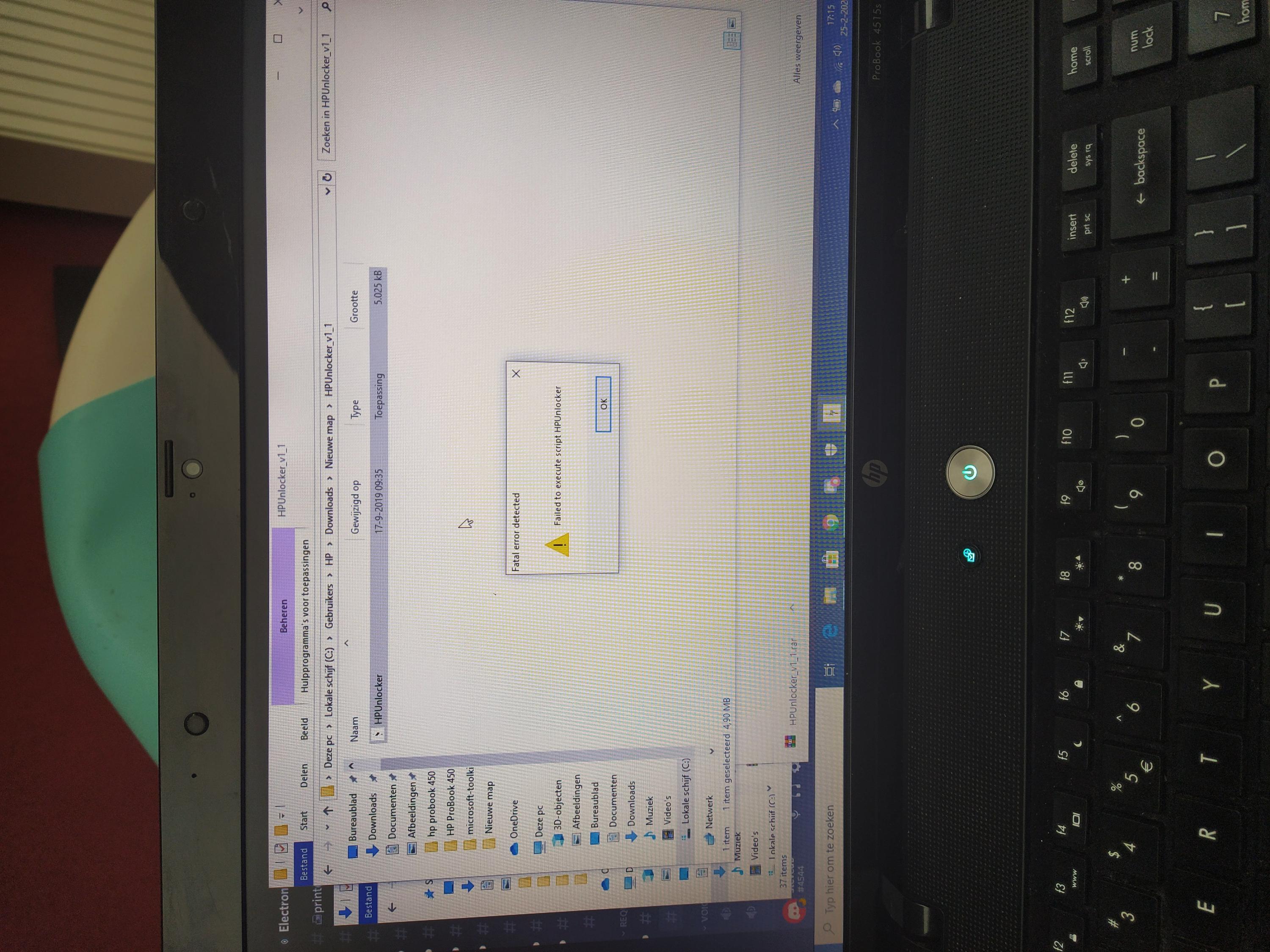

                                  Re: HP BIOS unlock tool
                                  Hi there i have a problem when i will install the tool gives it fatal error. Howdo i fix this problem.
                                  Regards
                                  Steve

                                    #117
                                    Regards
                                    Steve
                                    There is nothing to install here - read the thread carefully, especially post #1:
                                    Originally posted by RethoricalCheese
                                    When you have your dump, just drag and drop your file on my HPUnlocker tool and it will create a new file. It will add "_unlocked" to the name of your locked file.

                                      #118
                                      Hi vesko i tried that but say the error if you want i will take a video

                                          #120
                                          OK upload the file here, I'll try it with the tool myself.
