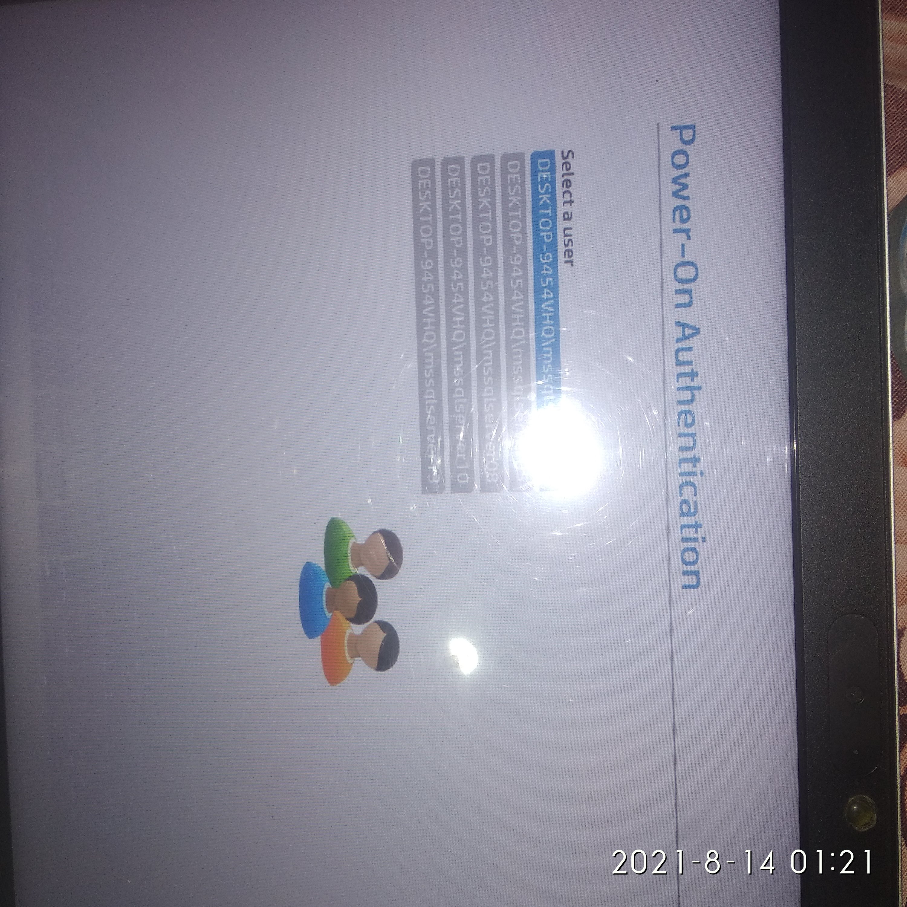

                                  Is your laptop hp Probook 450 G7 are fully ok now? I am also in same problem. Power-on authentication issue
                                    Re: HP BIOS unlock tool
                                    Send your bios dumps.
