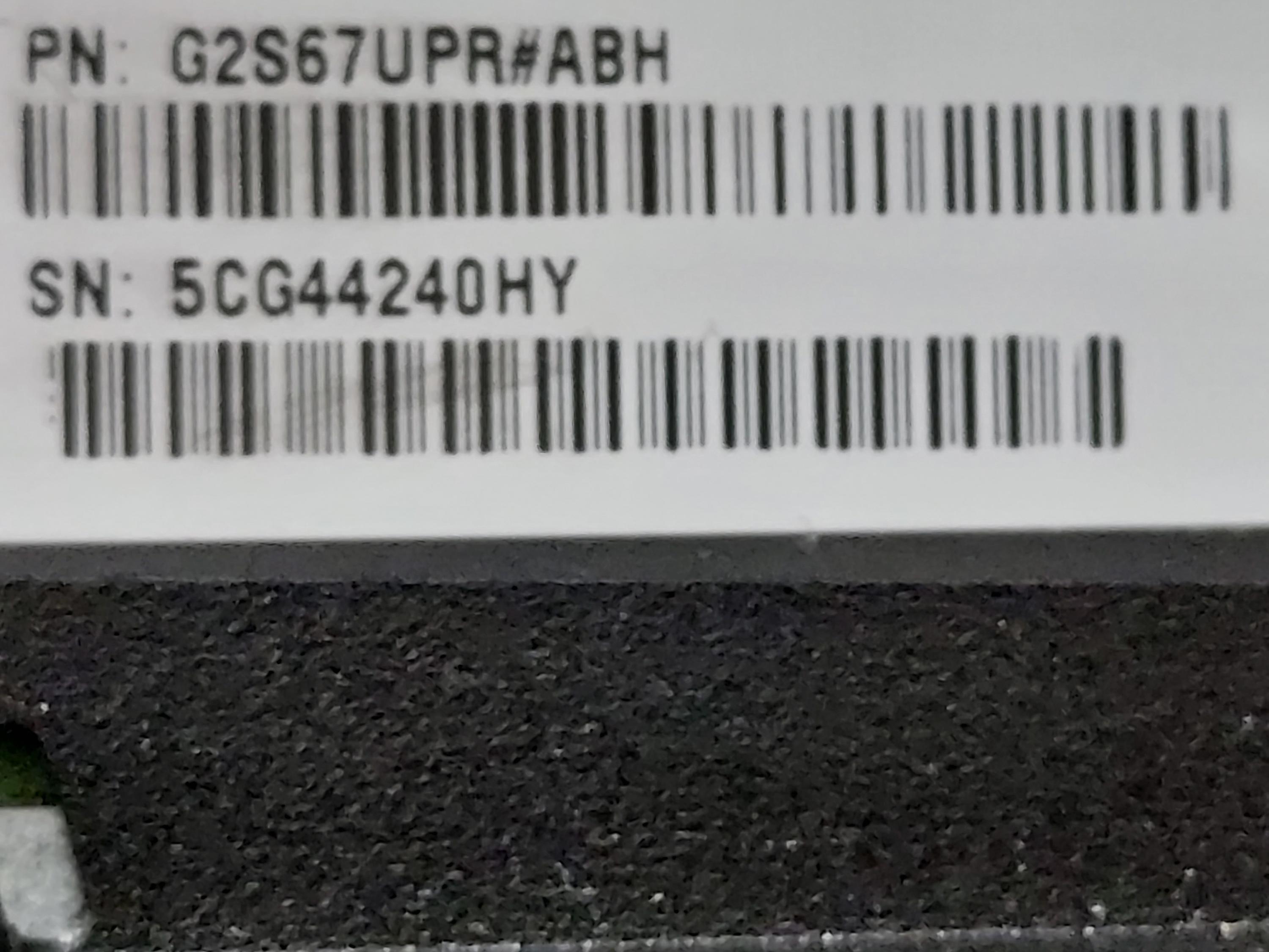

                          #912
                          Re: HP BIOS unlock tool
                          this is the serial number and part number detected using the hp manufacturing software for my hp elitebook 850 g1
                          serial number is 5CG44240HY
                          part number is GS267UP
                          if someone can help me with a new bios file that i can flash back to my bios that would be amazing and very much appreciated.
                          i have taken the chip 25aq128a eco13 off the motherboard no problem and i plan to erase, confirm erase and then flash the new bios once i have it.
                          initially the laptop had administrator password which was unknown and the guy who has it before me corrupted the bios with a bad flash and did not keep good dumps of the old bios so now i have no bios to work with.

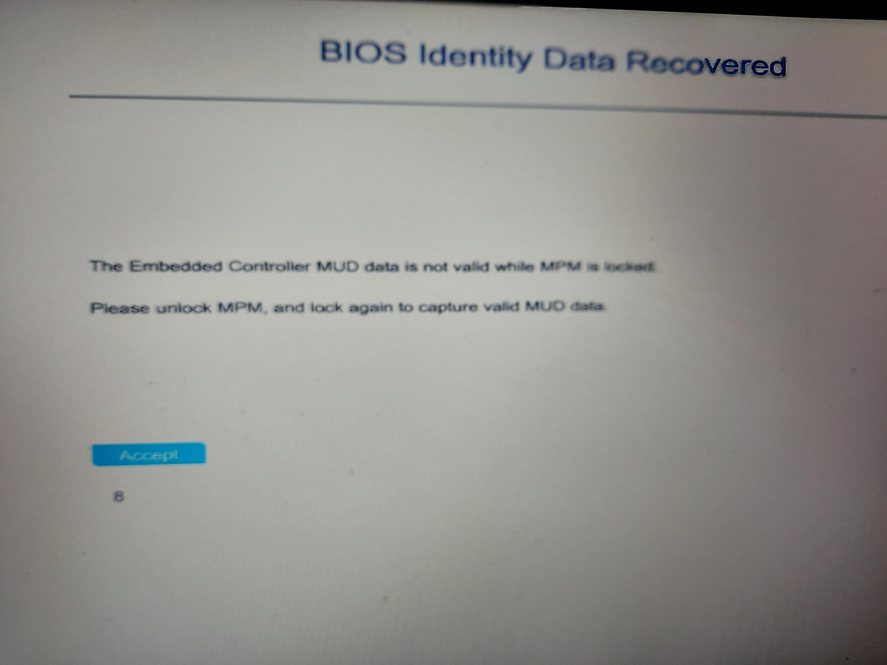

                            • 22209
                            #913
                            Use the forum search ,look for a 850 G1 with clean ME firmware, flash it ,then use HP BCU/Wndmifit to enter the DMI information.
                            https://www.badcaps.net/forum/showth...ghlight=850+g1
                            https://www.badcaps.net/forum/showthread.php?t=69204

                              #914
                              thank you ive flashed the cleanme file and verified, so do i just run bcu and make a usb flash drive with the manufactures up bios image??

                                #915
                                @peste @SMDFlea would any be able to help with the hp elitebook 850 g1 ?
                                firstly I do not have any backups of my dump bin file because I had no choice but to flash a cleanme bin file and the laptop boots fine apart from the mud data is not valid while mpm is locked.
                                I do not know how to get rid of this error message but at least I am now making progress can anyone assist with step by step what to do now?
                                thank you in advance.
