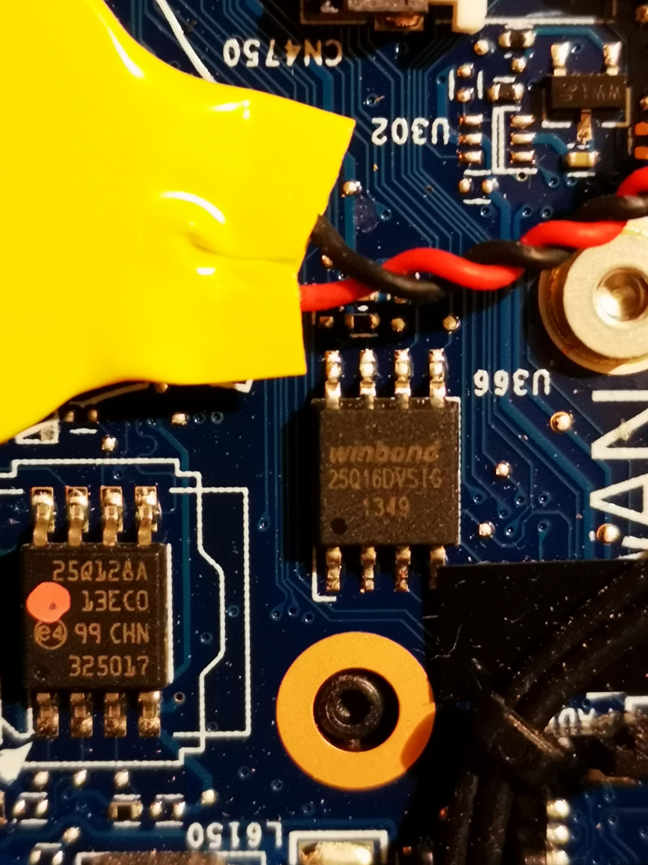

                                          #80
                                          Re: HP BIOS unlock tool
                                          Hi everyone, i need help.
                                          I have a second-hand elitebook 850 g1 with bios locked by password.
                                          Understood that i need to unlock the BIOS is the ch431a programmer+soip8 with the software to dump my own bios file, to reprogram it and at last flash it. But i see on the motherboard two chips. Which is the correct one? I need to reprogram both bios?
                                          I've attached the img to be more clear.
                                          Thanks everyone
