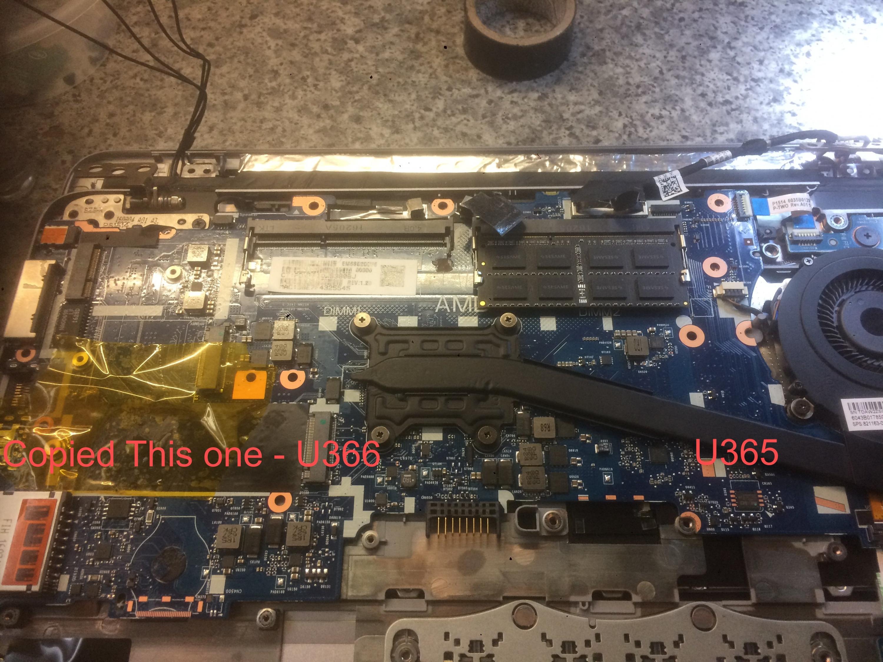

                  Hi there, I could not get it to work on a HP Elitebook 745 G3. I dumped chip contents and used the unlocker to generate the unlocked file and wrote it back. Laptop still had the password so I used total commander to see what was changed and it appears to just be the already blank area at the beginning?
                  See attached pic if you could advise what I have done wrong please. I also attach the .bin files (rename from .zip, they are not zips.)
                  Many thanks.

                      Seeing that you have an empty beginning and it modified the beginning, your dump was faulty. Did you verify when reading?

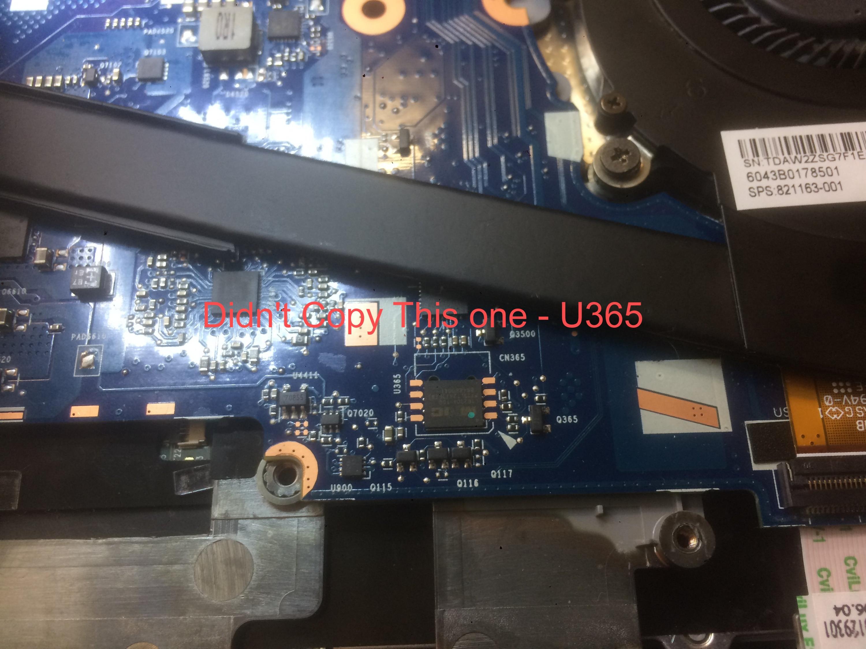

                          I un-soldered the chip with the hot air station, I took 2 copys from the chip, verified both with total commander as advised in this thread and wrote back the unlocked one and verified. The laptop posts fine with the unlocked version. Sorry for not zipping I thought it was a problem with the forum not letting me attach the file. Have I copied the correct chip U366 next to the bios battery. There is another at the other end of the board, U365. How can we know normally without a Schematic? See Pics. I could try the other one but I don't want to take un-neccessary risks unless I'm certain it is. The bios battery and its socket were already ripped off when I opened this laptop as well as the ram slot.
                          Many thanks.

                            I am going to try the other chip with is bigger 16mb, the one I did is 8mb. I will report back.

                              If you don't want to take unnecessary risks, just ask before doing anything you are not sure of. It is always the bigger chip on HPs. So your first attempt was pointless.

                                Hurray, it worked, thanks to everyone and next time I won't jump to conclusions. What does the other chip do? Do you think I need to get it back off and write the original dump back. The changes are just in the blank section at the beginning as pictured above!

                                        Yeah I did that, but what is that chip for? Also I've been un-soldering them everytime. Can they be done in situ? I was afraid of the dumps being wrong and would be game over if I flashed back a bad copy!
                                        They contain Intel microcode and some other stuff. Also a copy of DMI data.
                                        You can solder wires to gold pads but if you have a hot air station, desoldering using that is always faster.
